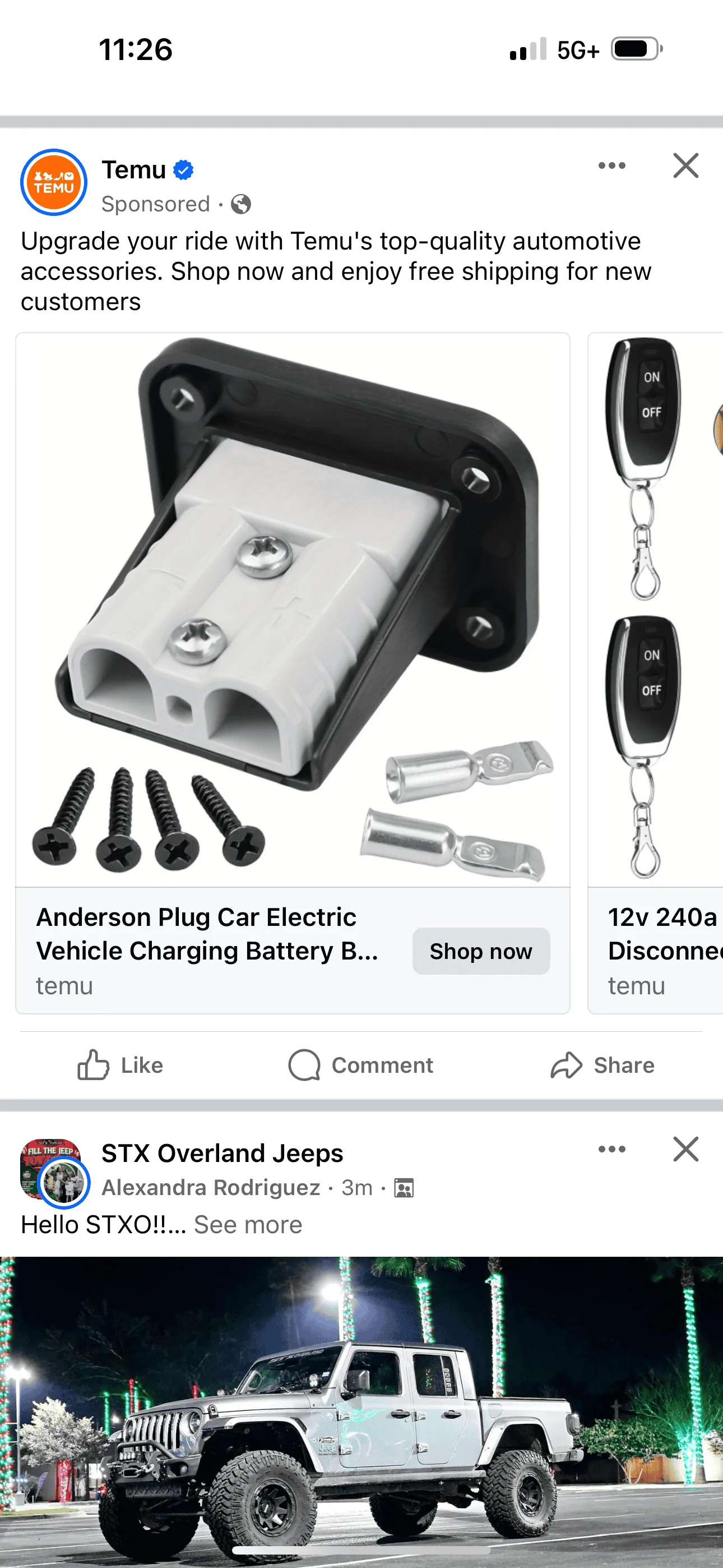

My phone is spying haha . Read this thread and then opened Facebook to see this
Jeep Gladiator One solenoid for two uses IMG_1322
