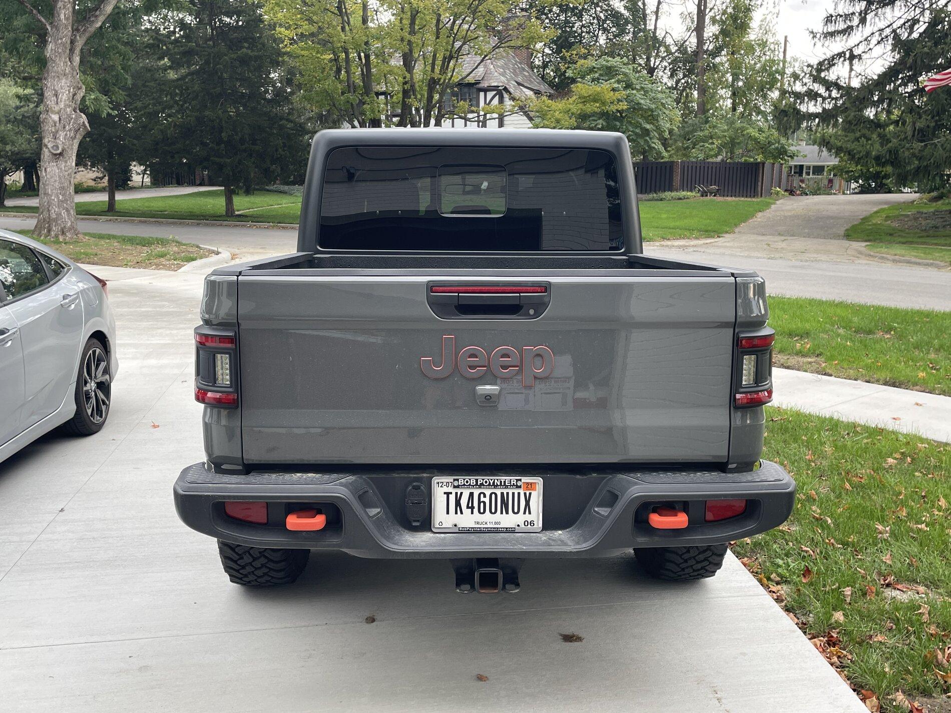

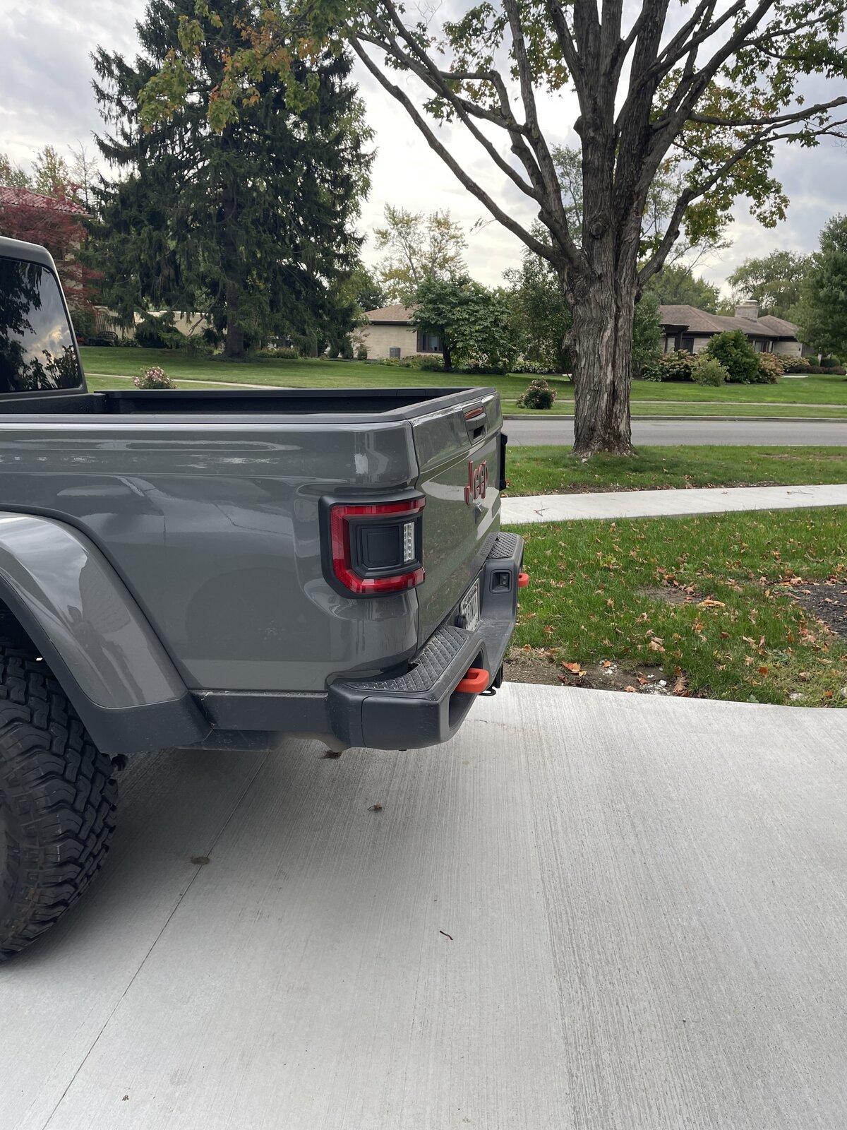

Allow me to clear up some confusion for you here -I may hold out for awhile and see what you guys come up with. I have the flashcal on mine. So I don’t plan on changing it for the taser or Jscan.
The only confirmed issue for some halogen Jeeps is the reverse lights shutting down due to being lower wattage than the OEM halogen bulb. (11w vs 18w)
We have parts available to ship as an immediate solution to this, should you have this issue after you've done the install.
There are zero signal out issues for these on halogen Jeeps so long as you leave the included resistors plugged in per the install instructions.
Tazer/JSCAN solution pertains to OEM LED Equipped Jeeps for signal out error. This is because, while the ORACLE tails draw less wattage than halogen, they draw more than the OEM LED. As stated in an earlier reply, we're ironing out a non-programmer solution for those. That won't pertain to you, since you have a halogen Jeep.
