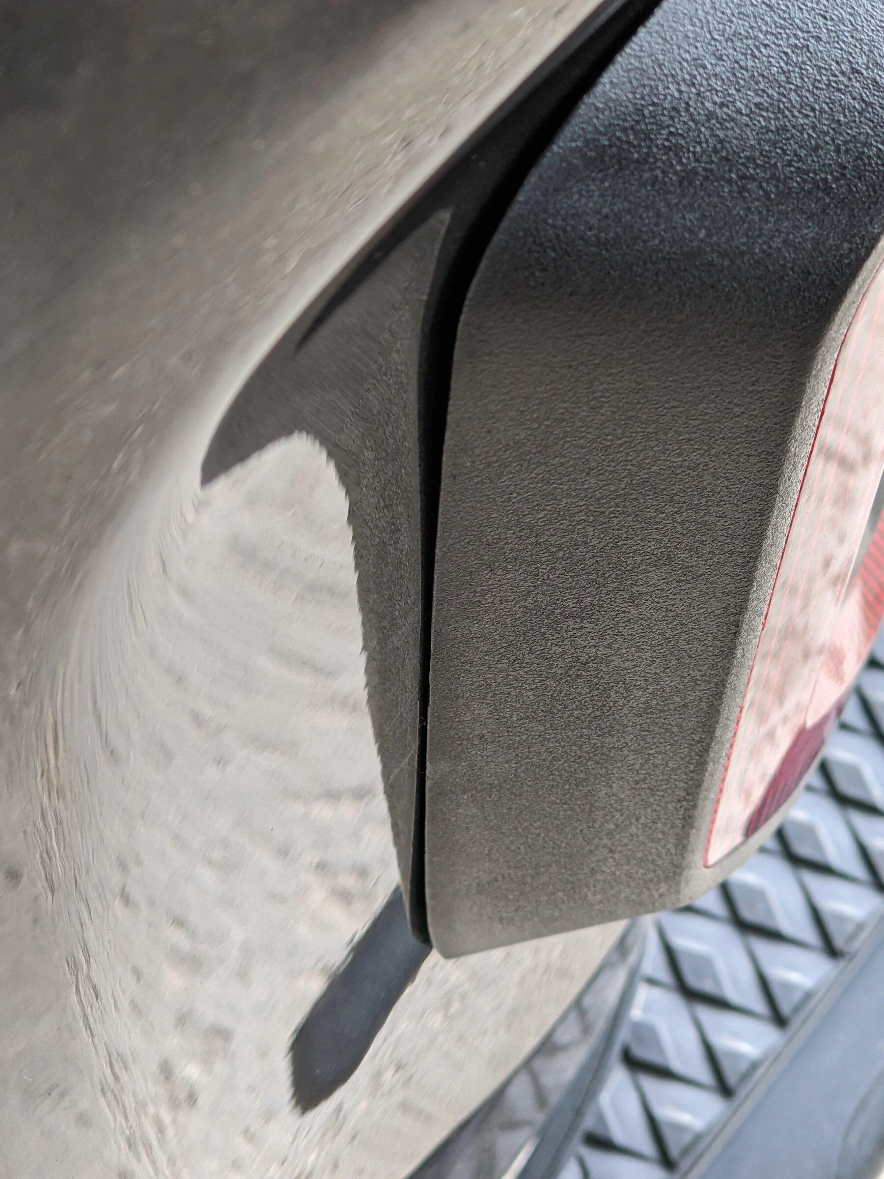

There's some r&d issues with the oracle lights (reverse lights didn't work on mine), but they seem to be attempting to address them. The quality of the light seems pretty good, but the driver side fitment on mine (and some others) isn't great because they don't follow the contour of the bed.
Jeep Gladiator Oracle Tail Lights or eBay knock off PXL_20211219_181154506
Having said all that, I really enjoy the flush mount look and still prefer them over the "blocky" stock style lights even with the issues they are having.
