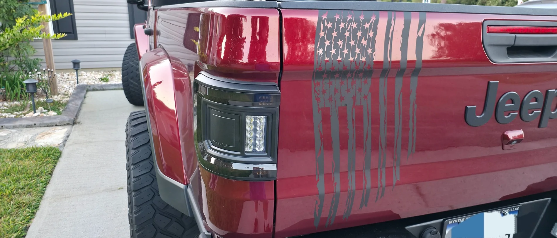

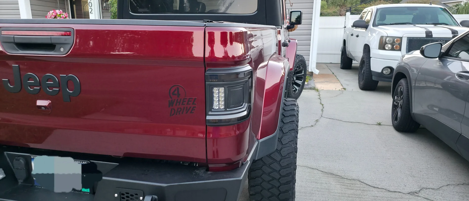

I did a lot of reading in here on which flush mount tail lights seem to look the best. Settled on Oracle as I just didn't like the other designs. I'm aware of a potential quality control issue some have.
I read somewhere else in here where they got a rubber gasket off Amazon to help seal around the lights. So I went the same route and glad I did. These look killer and having the gasket around the edge just makes them look more "they belong there look".
I was curious if some who bought there's used the resister. I didn't and just set the tail lights to led using jscan. However the ones I got came with 2 resisters which I hadn't seen anyone mention. The normal resisters for halogen lights and a set of resisters for reverse lights. Maybe a quality of life improvement?

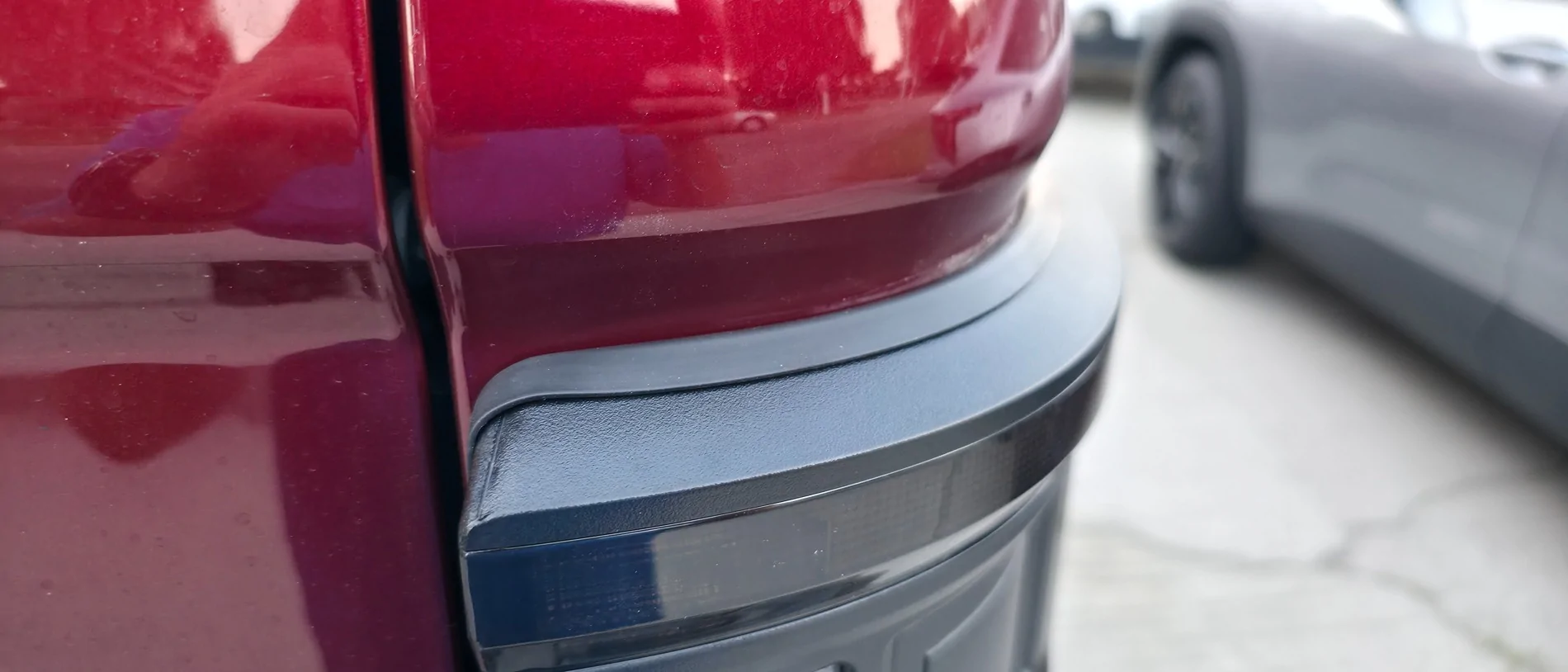

I now have rubber seals on my Oracle tails. I love the lights just
not the gapping unfinished look.
Without the seal:
Jeep Gladiator Oracle tail lights install tails 2
With the seal:
The photo was taken before I had Tightened everything up.
The seal is tight to the body now!

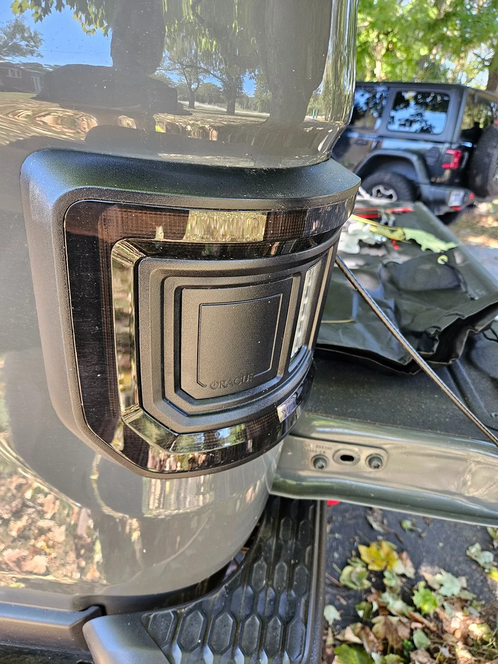

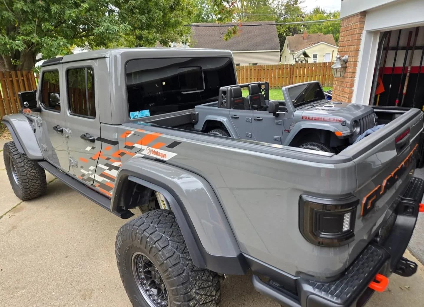

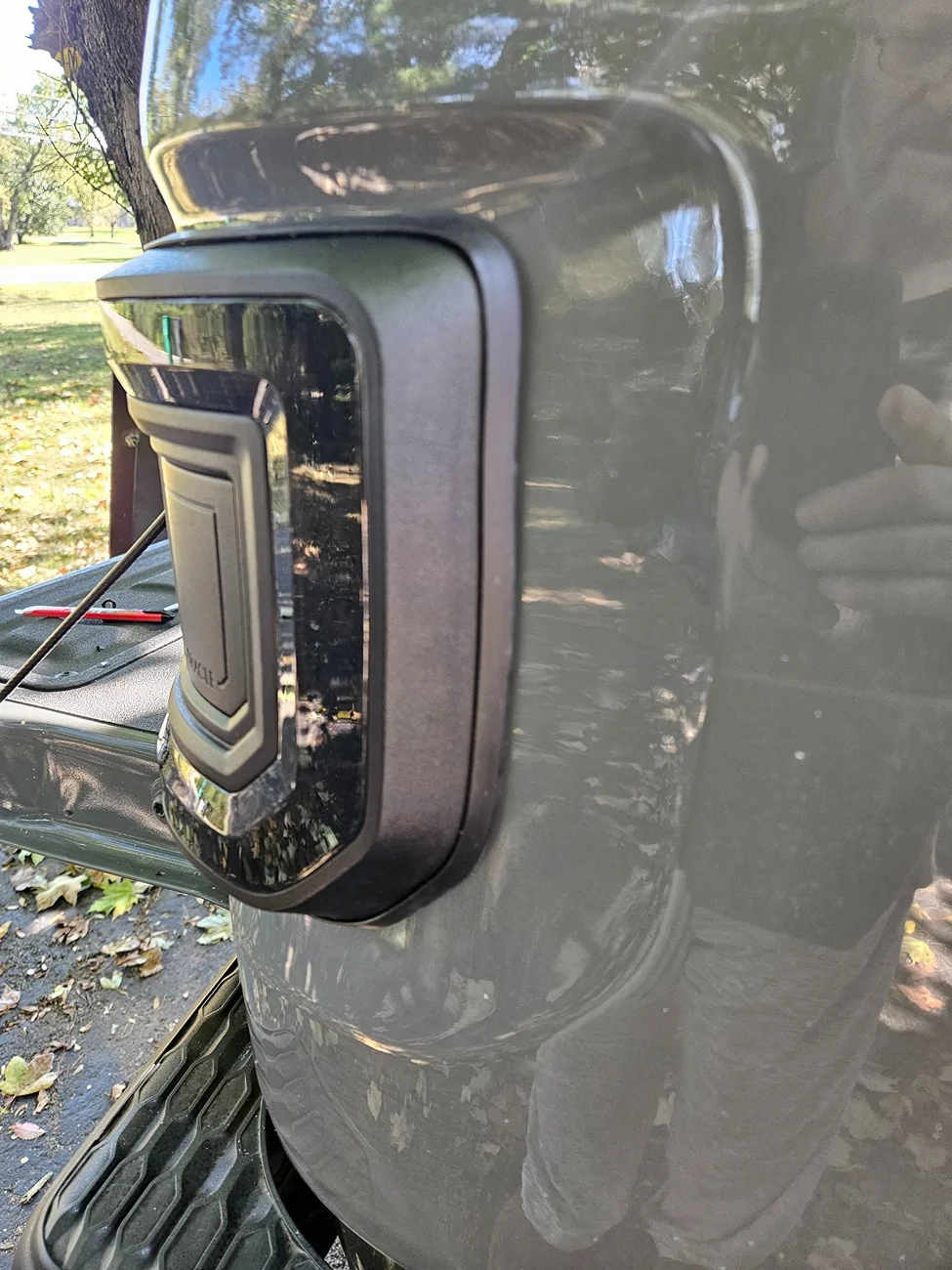

Yes, that was me that started doing this and have mentioned it in several places, including in person when I happen to see someone with them. The wife and i both have Gladiators with these lights and the seal, and have yet to have an issue. I presented this to Oracle a while back and they seemed less than interested in the idea/fix and basically blew me off unfortunately.
