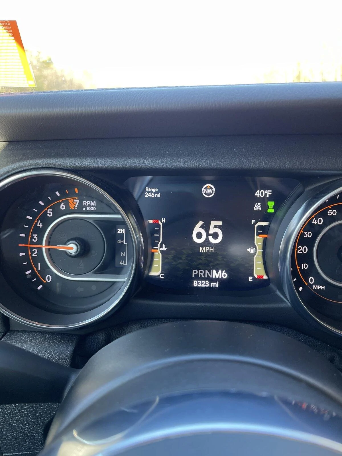

1: can’t imagine anyone is still reading this thread.
b: not sure how the info below is useful for anyone else
iii: I wouldn’t trust it as math was my weakest subject.
Was driving 1:30 each way and got bored on a long stretch of pavement. Found the equation wasn’t matching up to my truck likely due to variables. After 10 samples, it’s +-50 which fits
multiple angles of margin of error. This helps me determine where I’ll sit with larger tires or different gears.
RPM = (MPH x axle ratio x transmission ratio x 360) / tire diameter (listed, not actual. ie if you have 35” tires, use 35 and not 34.x etc)
exhibit A:
65x3.73x1.00x360/35 = 2,494 RPM
Jeep Gladiator Ordering gear set today 8DD48941-8AB9-46E1-97D3-F531A569BBBE
