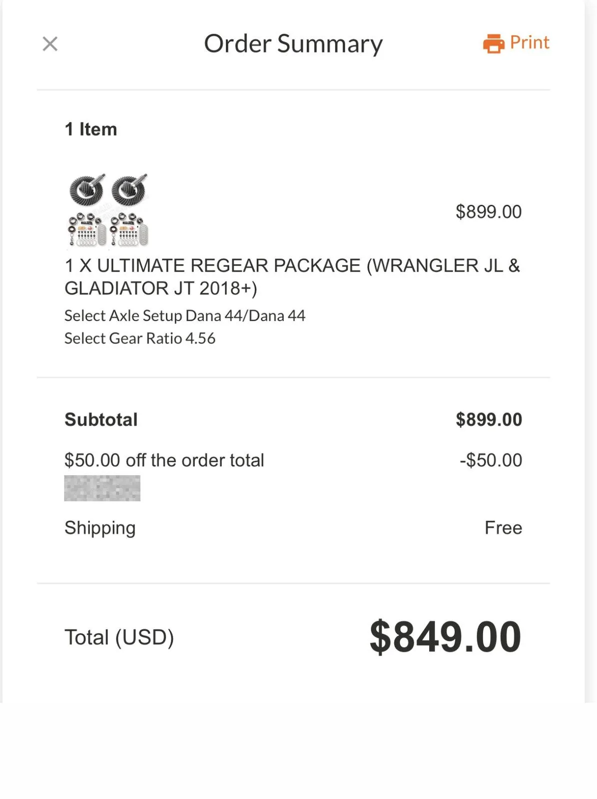

Funny you mention that with the revolution. I’ve done lots of research on the name and they check out as a quality option. Called my local and reputable 4x shop and they said “never heard of them.” They prefer spicer and Yukon ??‍♂.
Just good a good “deal” on a full set of front and rear including master install kits. In stock and shipped free for $849 so going with that. Of course
now that I’ve read this I’m hoping yours was a 1 off issue on the rears. Funny- you mention the 500 mile being optional. They said the exact same thing. I mention this only because they are a bit of a drive and they said “anytime between 300-700 miles and even then totally optional.” Said the same thing you did that you can crack the case in the driveway and DIY.

Guess that settles it.

Not a bad price...figure ~$300 per gear set and $100 for bearings/shims/gear oil x 2 = $800, add tax etc
Best I could find so far. Lowest around $899 and highest around $1,199. Also most showing backorder for 4-10 week ranges. Likely won’t do this till January, but will be happy to have materials on hand.

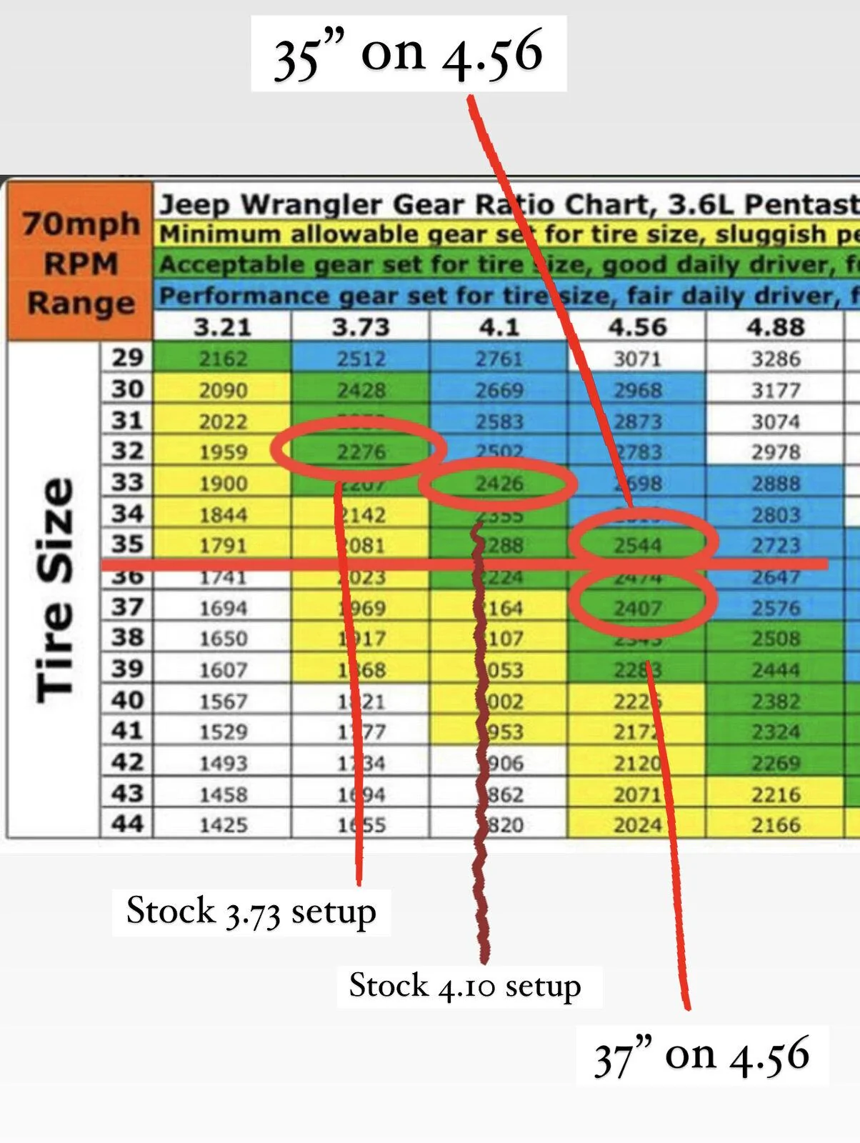

Just need some validation. I’ve read arguably every thread for the last 5 months and “decided” on 4.56 on 35s.
Stats:
-overland on 3.73
-35” MT Baja boss with 2.5” lift
- live at sea level 1 mile from the ocean
-no load or heavy gear
-no towing other than a utility trailer a few times a year.
-daily driver
-70/30 around town and a 1x/weekly 80 mile highway round trip at 75mph
What I want:
-overdrive back
-ability to merge onto the highway and the truck shifting instead of winding out to 5k rpm’s before up to speed
-ability to go up a 3% grade without downshifting to 5th/6th
-use adaptive cruise and not have it downshift 3 gears when it needs to go from 73 back to 75mph
-tow my little trailer out of 5th gear
-best mpg possible. That may end up being 15…I’m ok with that and would take that over 14. Not looking for a Prius, but a best case scenario.
Lastly:
- this Jeep doesn’t wheel, ever. My Cj does. This one gets me down my logging road to get to camp.
-I’m not looking for best performance. Don’t need to beat anyone off the line because I drive like an 80 year old. (Not the kind that mistakes the gas for the brake and drives through the front of a 7/11)
-I may do 37s in 50k miles when my MT wear out. I’d do light ones, and may not even do this at all.
What I’ve come up with based on all my reading- 4.56 is ideal for 35s. If you EVER want to go 37s, do 4.88. However looking at this chart, and being unloaded, not towing, sea level, and not wheeling, it looks like 4.56 could be optimum for either tire under my set of circumstances. I want to keep the RPMs lower and keep the performance closer to OEM.
Experts, what do you think? I am not married to any idea, just going to make the purchase and want to do my best diligence. Reason for this thread being that ALWAYS 4.88 doesn’t necessarily mean always as there are difference scenarios which could call for something else. Looks like based on this chart, in a vacuum,
37s on 4.56 would behave like factory 33s on 4.10.
Note: I used actual inches for simple math, not measured tire size
This chart seems way off, compared to the other charts out there...this is basically saying with 3.73 gears at 32's, it's still undergeared coming from the factory. What people need to pay attention to when regearing is effective gear ratio..
I agree. I don’t believe the grimjeeper one is a ton better… but likely within +-100 or so.

You can always check a chart against the RPM formula.
RPM = (MPH x axle ratio x transmission ratio x 336) / tire diameter
