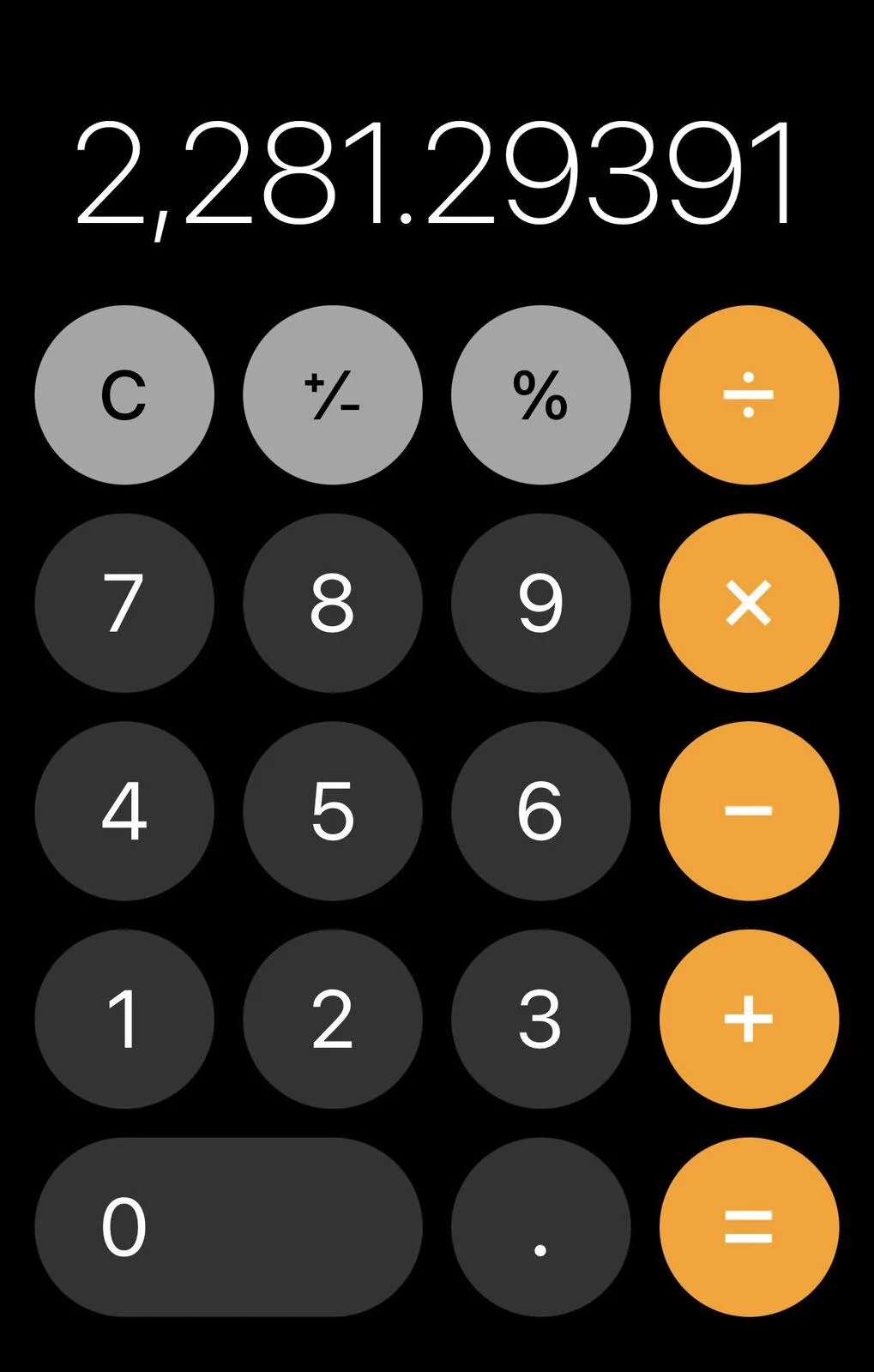

You can always check a chart against the RPM formula.
RPM = (MPH x axle ratio x transmission ratio x 336) / tire diameter
First I’ve heard of that, that’s helpful. Here is 75 mph on 4.88 with .64 OD and 34.5 Mickey Thomsons.

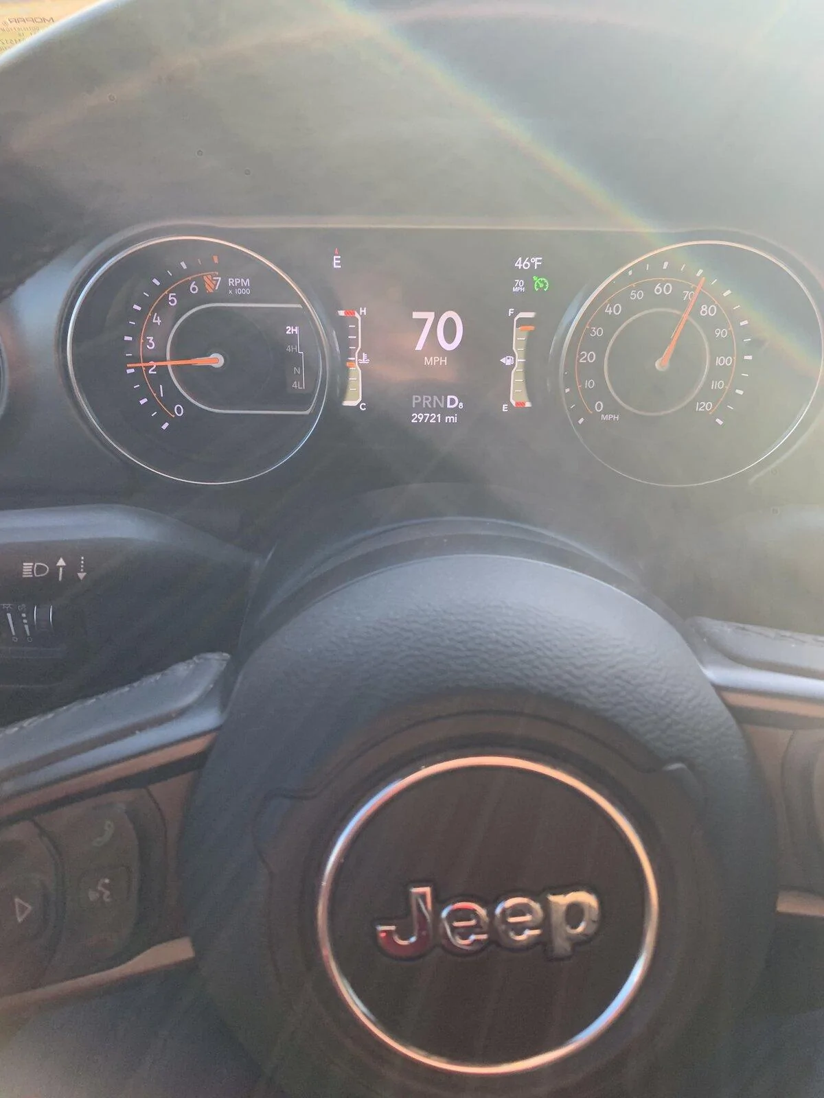

Here is my RPM’s at 70mph
I just took this picture not 30 min ago heading into town

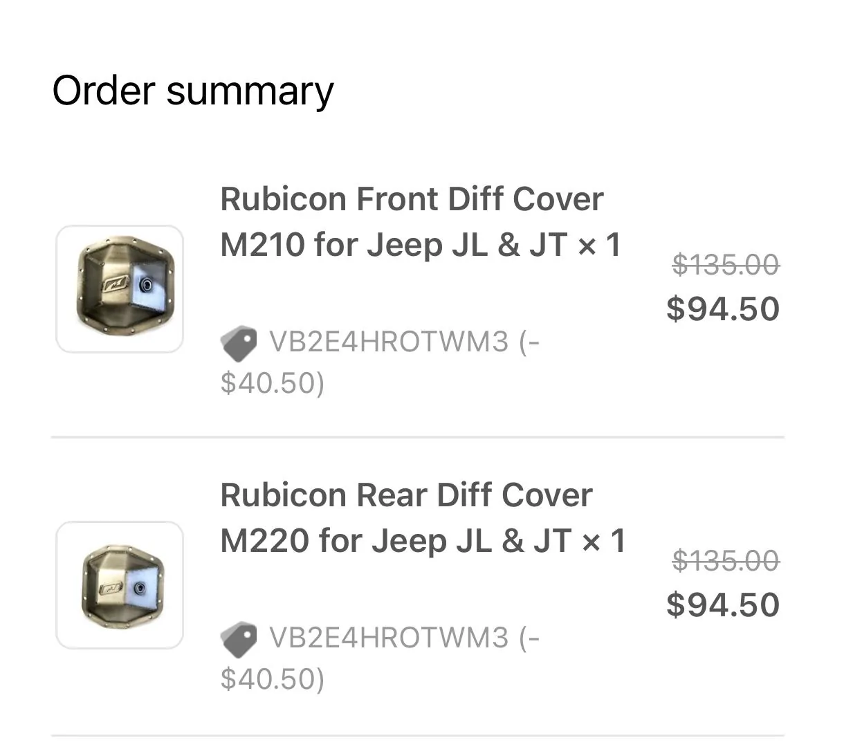

Already getting fancy. Nice little sale on some new diff covers.
