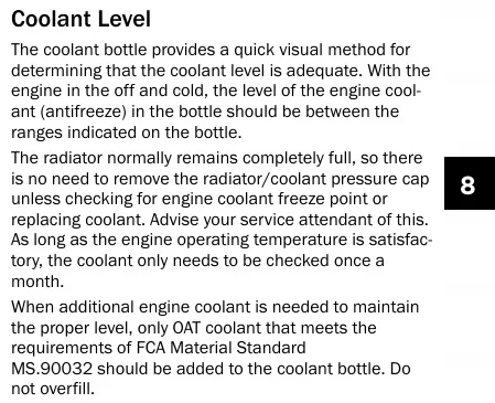

I assume the low mark is basically the seam, since it says min/max right above it and the min arrow points to it. The coolant in the reservoir was definitely below the min mark and still is this morning with it completely cooled down.
Probably a stupid question, but should I add coolant to get it to between those marks? If so, should that level be checked while hot? Or cold?

The level should be somewhere between the two marks, checked when cold. If you find yourself having to check the level when hot, it should be no higher than the upper mark.
Jeep Gladiator Overheating from idling too long coolant level
With the coolant level having dropped, it would be a good idea to give the cooling system a thorough looking over to see if there are any leaks anywhere. Typical leak locations for a lower mileage vehicle like yours are at the reservoir itself and at the plastic connectors of the smaller coolant lines. Air tends to get in the cooling system either when coolant is getting out (leaking), though sometimes it can get pulled in past seals as the system cools.
