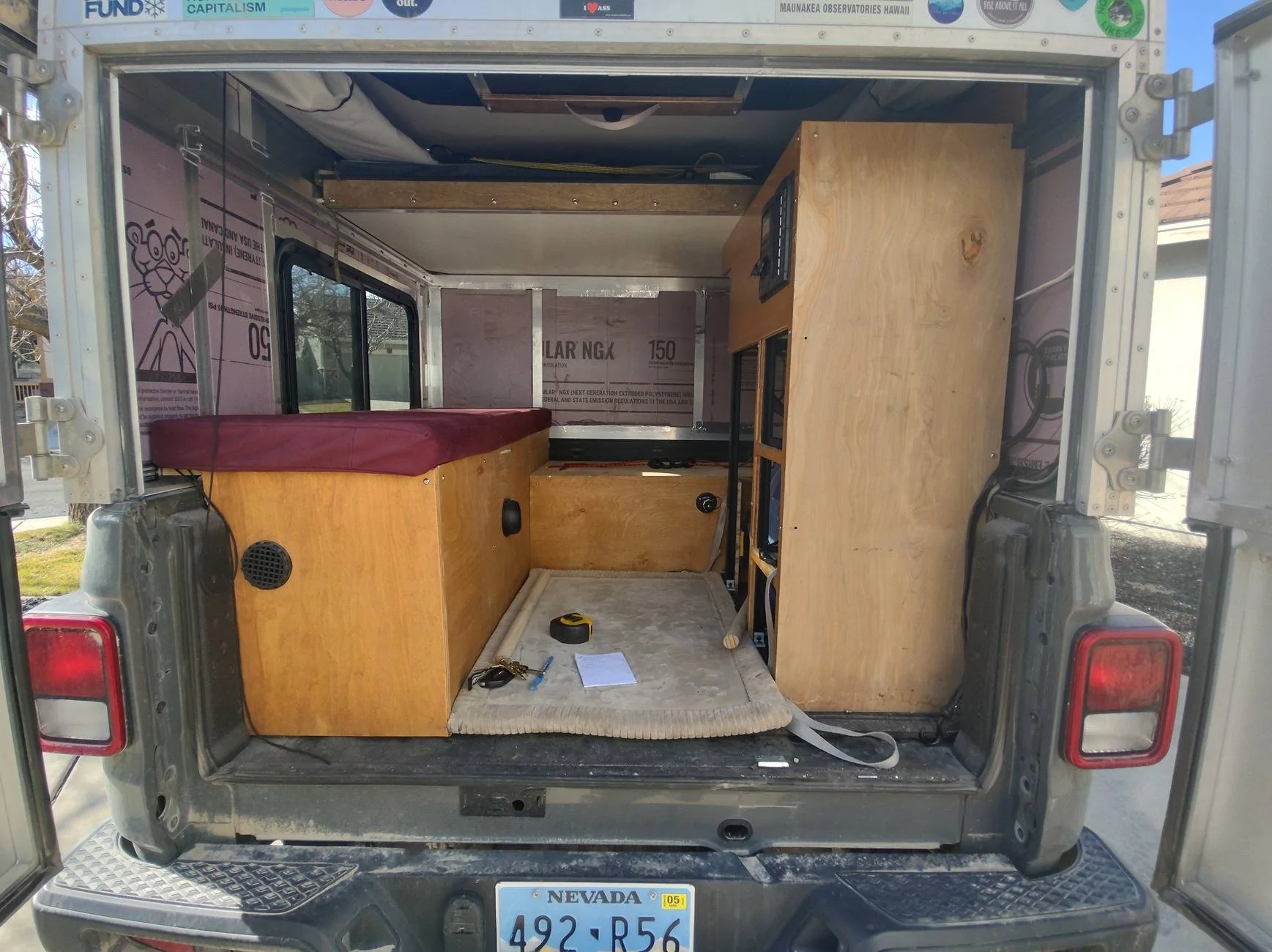

@Free2roam Would you mind telling me the dimensions of your cabinet setup in the bed, please?
Measurements
Driver's side
18.5"T *15.5D*56.5
Passenger side
42H (could have been a little shorter)
15.25 D*33.25 long
Front of bed Fridge freezer area
19*38*13.5
Top of counter 34.75L*15D
I did take off the front trail rail section to make a bit more room.
Under fridge freezer area is a 15 gallon water tank.
There is also a sink and grey water tank. Plus 2 100AH Renogy batteries and 400 watts of solar.

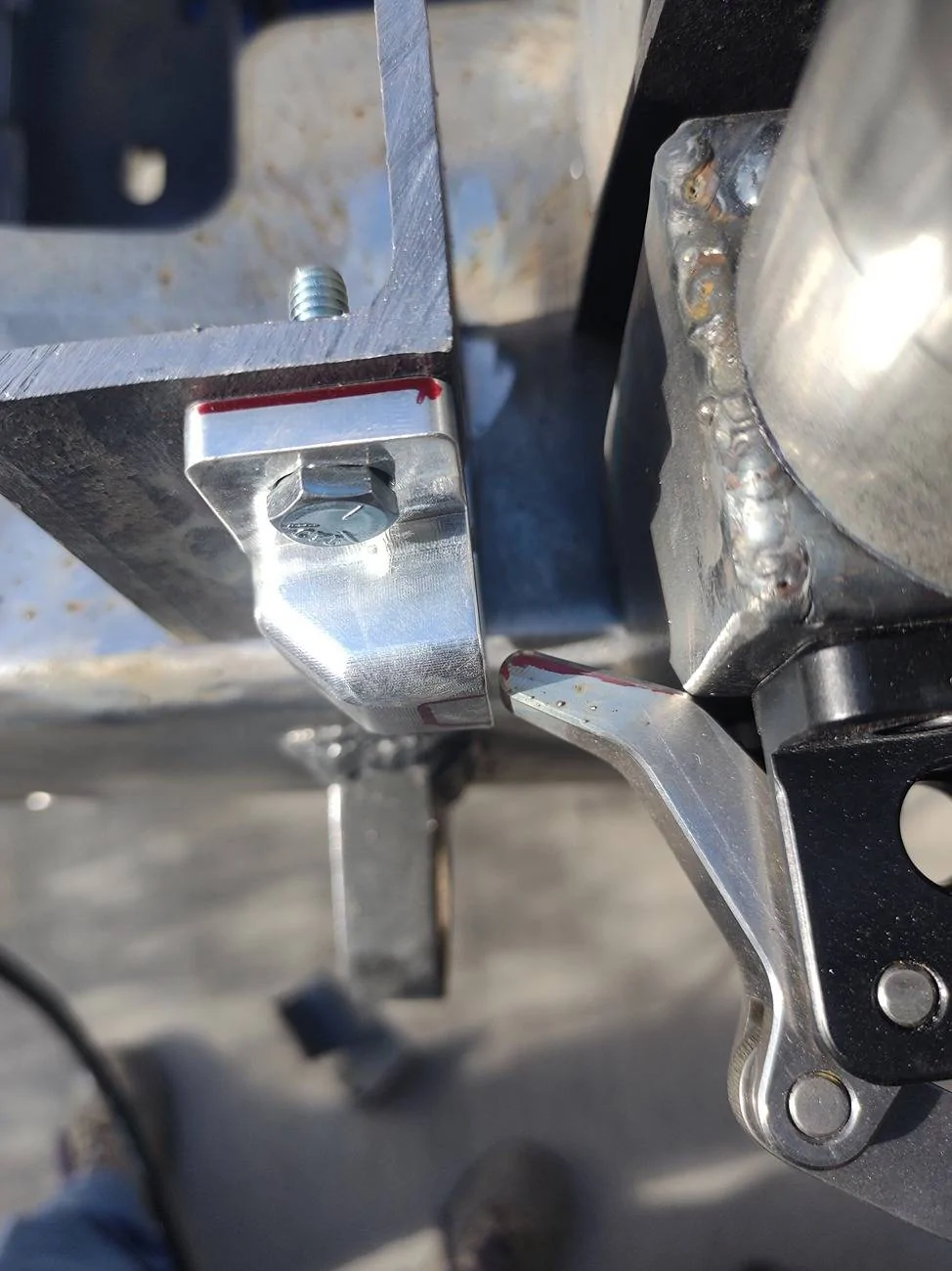

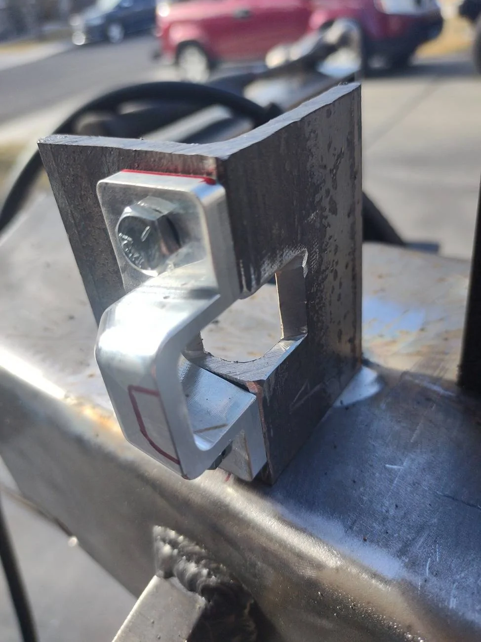

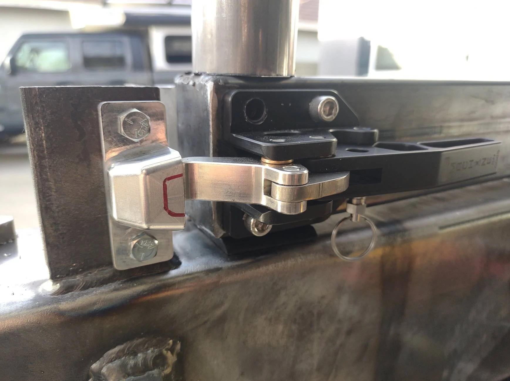

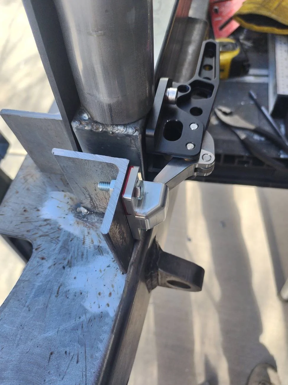

Another piece of the puzzle today on the swing away. Got the backing piece and the mounting piece installed and welded today.
Looks great!

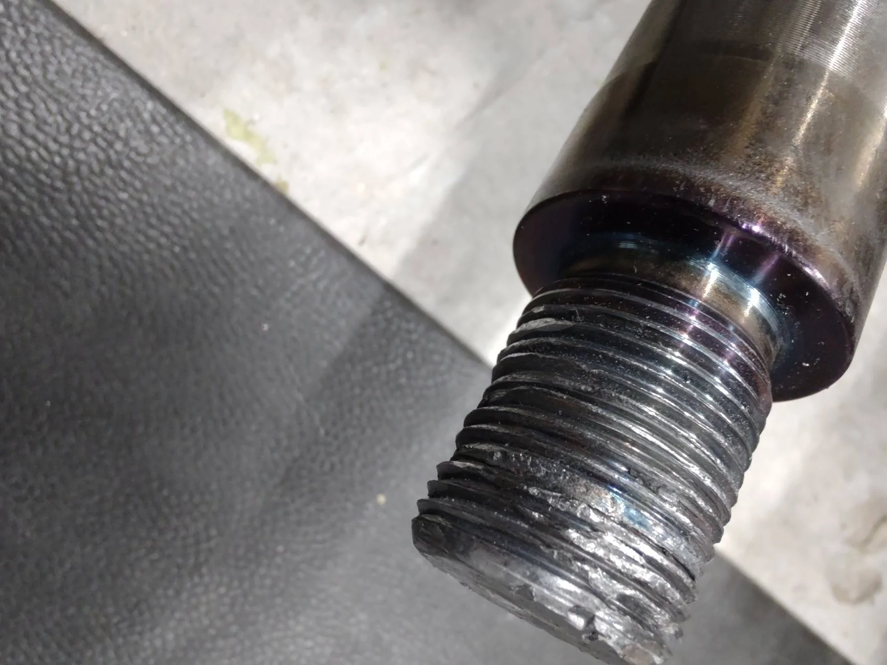

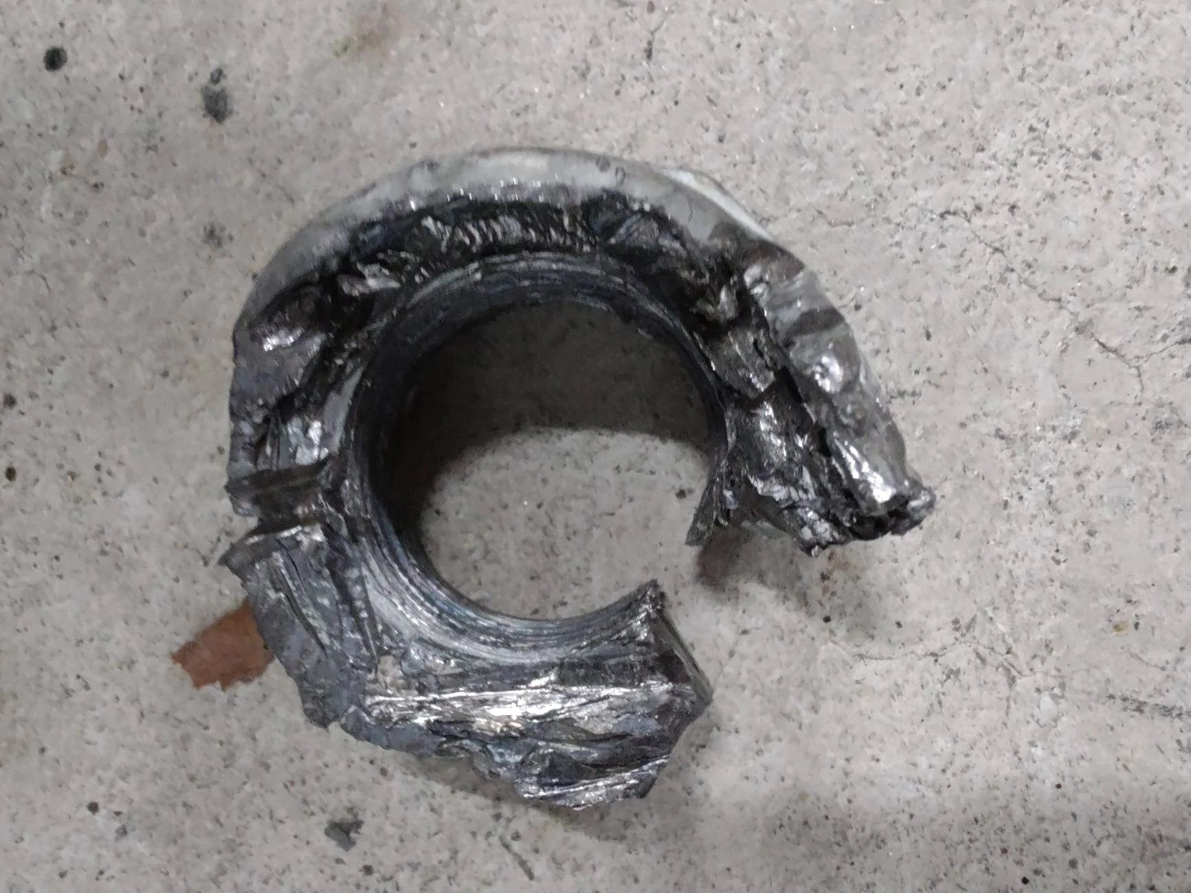

Just when you think you have it all dialed in! Geezuz really couldn't you have just not galled up and cost me my whole day!??
I was into the last phase of putting the swing away together. I had previously had no issues with the nut 🔩 setting up the latch hold open mechanism. Got it figured out. Then Ruh Roh Shaggy!!
Jeep Gladiator OVRLND Camper roll call IMG_20250201_175817775
Jeep Gladiator OVRLND Camper roll call IMG_20250201_175828768
I had the induction bolt heater going. Broke out the good tools after that. Mac chisels and the Snap-On ball pein hammer. Quite a few oh fucks later a couple of fuck that hurt and please fucking come offs! After I had heated that nut red hot. Finally broke through the last section. Now it's wait and see if the order from bezos solves the problem. Hardest part is trying to rethread the shaft. 🤞 🤞🔩

Oh, that sucks man! I have a friend with a lathe up in Sparks if you need help.
Unfortunately it's welded to the bumper.
Hindsight......anti-sieze. 🤦
