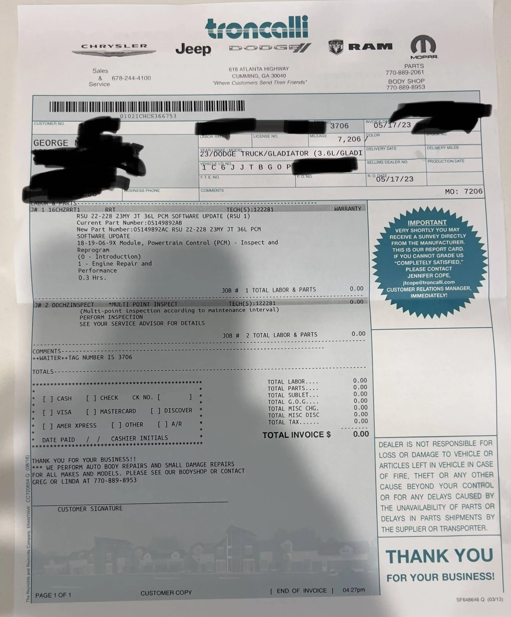

Made it to the dealer, 1 hour of work in the express lane. RRT update to the PCM. no specifics yet on what is going to be changed.

Well, no concrete news on what was changed.
Few notes, rep was unsure what was changed and said that they mostly don’t get told. Jeep drives relatively the same, maybe holds gears 1-3 longer but could be just me searching for something.
My jeep is listed at a “23 dodge truck/gladiator) no mention of jeep.
Of further note, after looking up the two part numbers, both return charge air sensors.
https://www.quadratec.com/p/mopar/charge-air-temp-sensor-cherokee-kl-05149279ac
Believe it is likely safe to assume this had nothing to do with anything related to the Cam/Lash adjusters.
