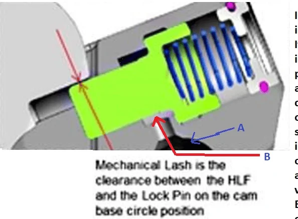

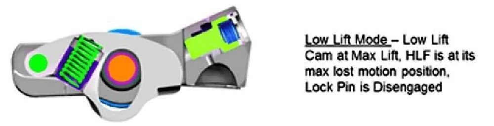

These have a bit of "mechanical lash" when in the high lift mode - until the lash adjuster takes it out. So when switching modes, there has to be some play to allow the pin to be pushed out by the spring, locking the follower into high lift mode. That play exists until or unless the lash adjuster expands, taking it out.
In low lift mode, that center high lift follower floats against spring pressure. Possible sound coming from this in low lift mode as the center high lift piece floats up and down on the cam's center lobe - only spring pressure holding it against the cam's center lobe, perhaps noise generated here?

Your understanding of the lash in the VVL is correct, the high lift arm "floats" against the high lift cam lobe until the lock pin is actuated. So there are times when it can "tap" against the lobe in low lift mode, where these engines actually spend most of the time running.

As far as noise - consider that the intake follower is multiple piece and when it's in the low lift mode, the high lift center section sort of "floats" on the cam - IMO, looking over the design and how these operate, they aren't going to be really quiet.
