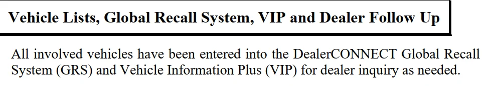

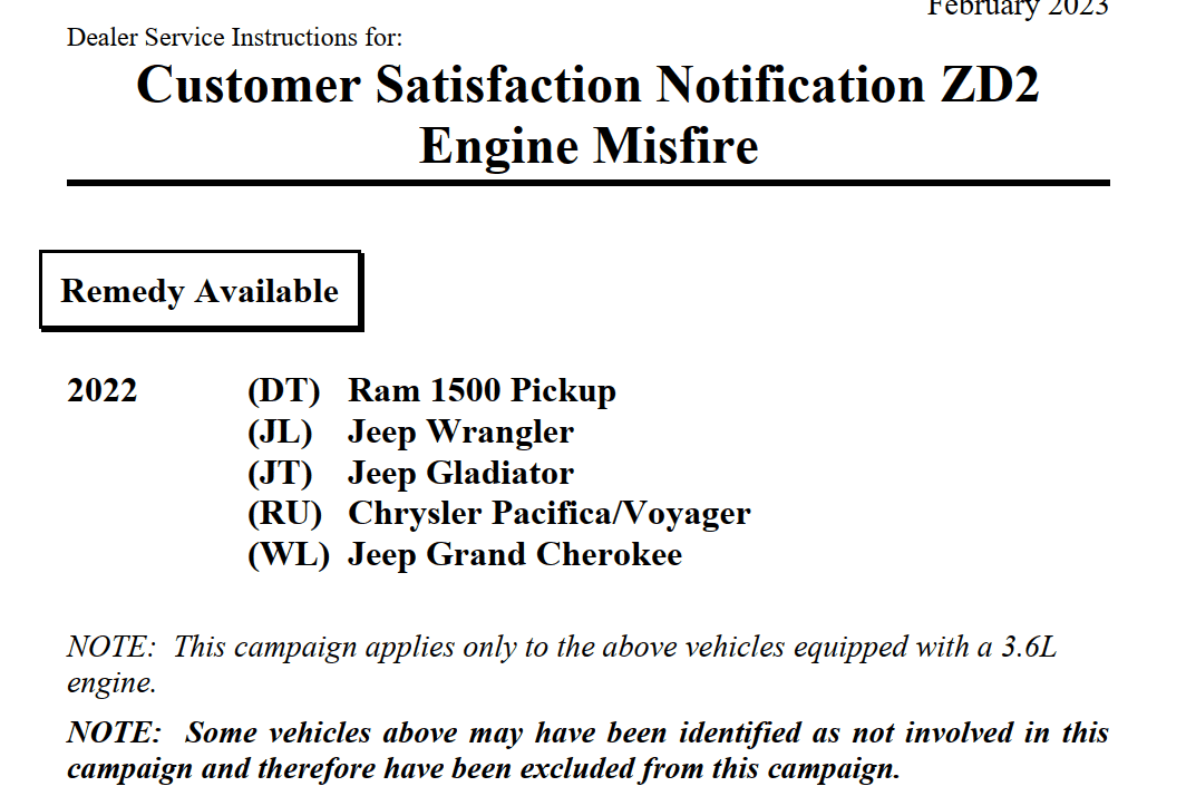

Here's an example of a customer satisfaction bulletin and notice that FCA refers to as a recall - and it's NOT date specific at all. IF your VIN is listed, it's impacted, otherwise it is not. No build dates, only model year - they leave this one WIDE open!
Jeep Gladiator Pentastar 3.6 Recall On Lash Adjusters, Allegedly 1683897802628
Note - this is an FCA "recall" but is not technically a recall in the real sense. If you don't have the issue, you may not have the work done and it's not going to come under RECALLS on the NHTSA - as far as they are concerned, it's FCA's business and not a recall the government gives a rip about.
So this other isn't going to show up as a recall because it's not a recall outside of FCA's concern.
Jeep Gladiator Pentastar 3.6 Recall On Lash Adjusters, Allegedly 1683897995590
Dealers are to fix it before selling it. So in that respect, it's an internal to the company recall.
Don't go to the NHTSA site and look for a recall for the lash adjuster or this one here - it ain't.
(Oh, the ZD2 gets you a new left cylinder head if your VIN is affected)
