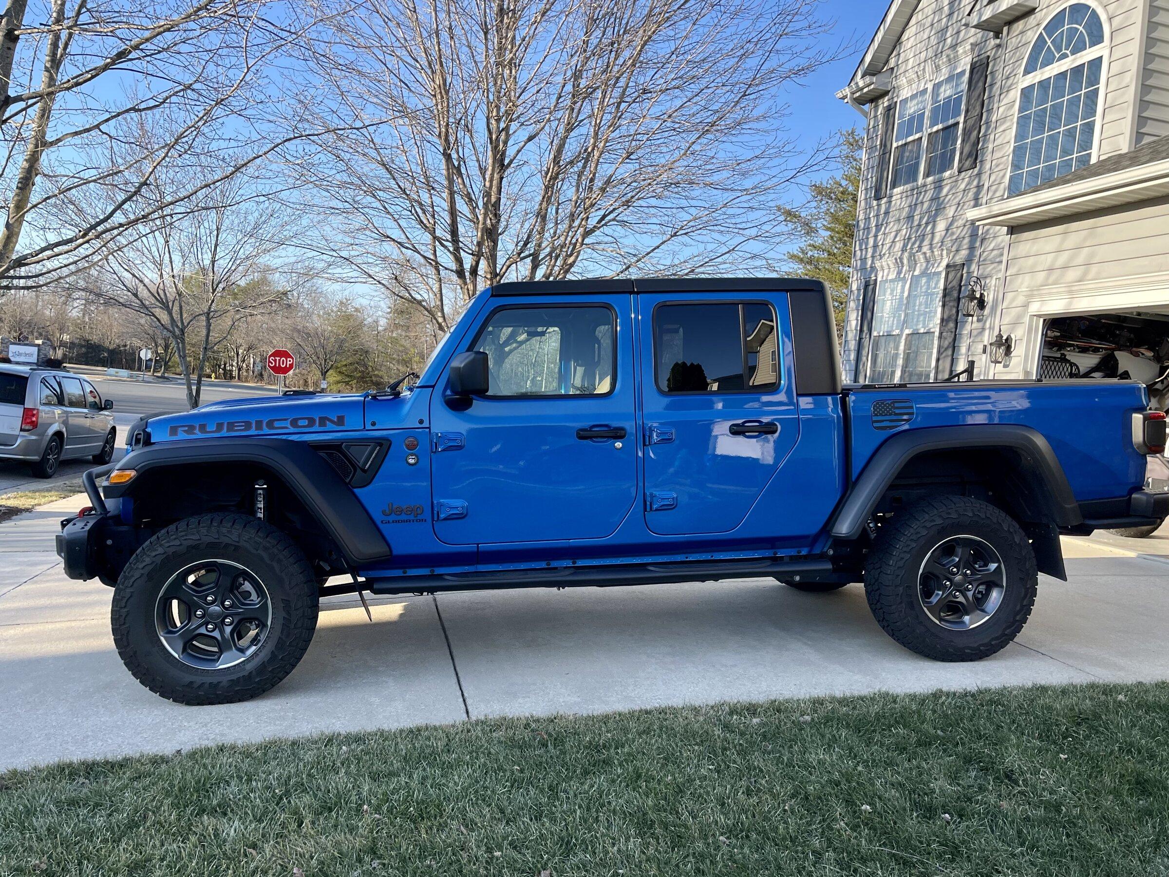

I started with the Mopar lift and am running 285/70 17 (33's). With the full lift I didn't like the way the rear was considerably higher then the front. The Mopar lift raised the rear of my Glad 3 inches. I ended up putting the original rear springs with 1 3/8 inch spacers in the rear. This gave the Glad a more level look.
Jeep Gladiator Pic request!  Mopar 2” lift on 33’s (on non-Rubicon) Mopar Lift.JPG

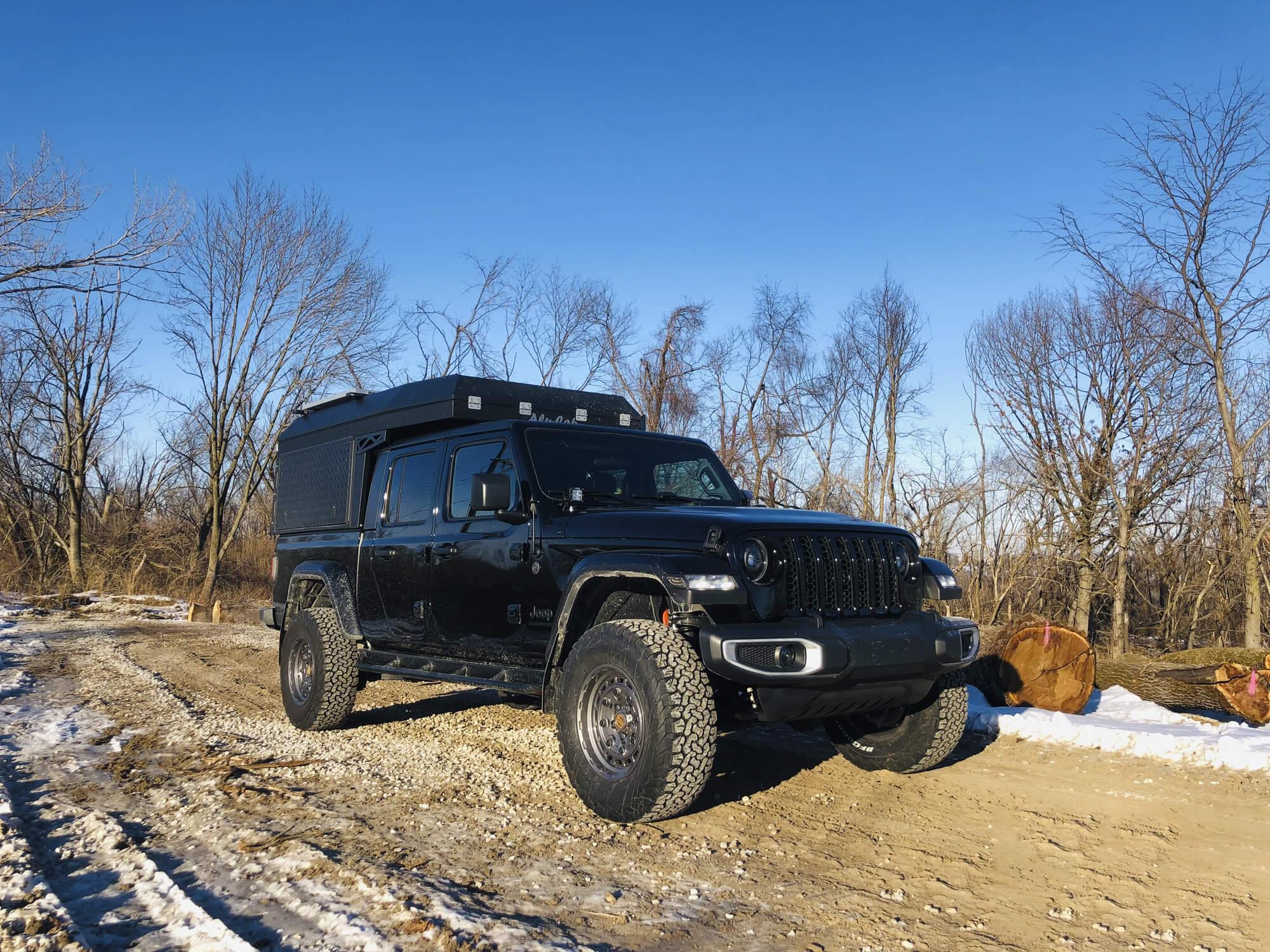

Here's mine. Rubi take offs, 2" mopar lift, 3/4" daystar spacer up front to account for bumper/winch droop
Jeep Gladiator Pic request!  Mopar 2” lift on 33’s (on non-Rubicon) 20210520_171626
Looks great. That’s the stance I’m looking for. I’ve ordered the 2” Mopar lift, which spacers did you use? I’d rather bring the rear down, since I’ll be running 33s, at first anyway.
Exactly what I was looking for. Already have the Rubicon take off tires. Sweet ride
mdyucca
Mark
Feb 25, 2021
762
822
92223
2021 Gladiator
For the rear I used the original, from the factory, rear spring with Icon SKU 22065 1.38 inch spacer and for the end links I used Clayton #COR-5109100. The front I used all the components that came with the lift. With this set up my 80th anniversary sat about 1 inch higher in the back.

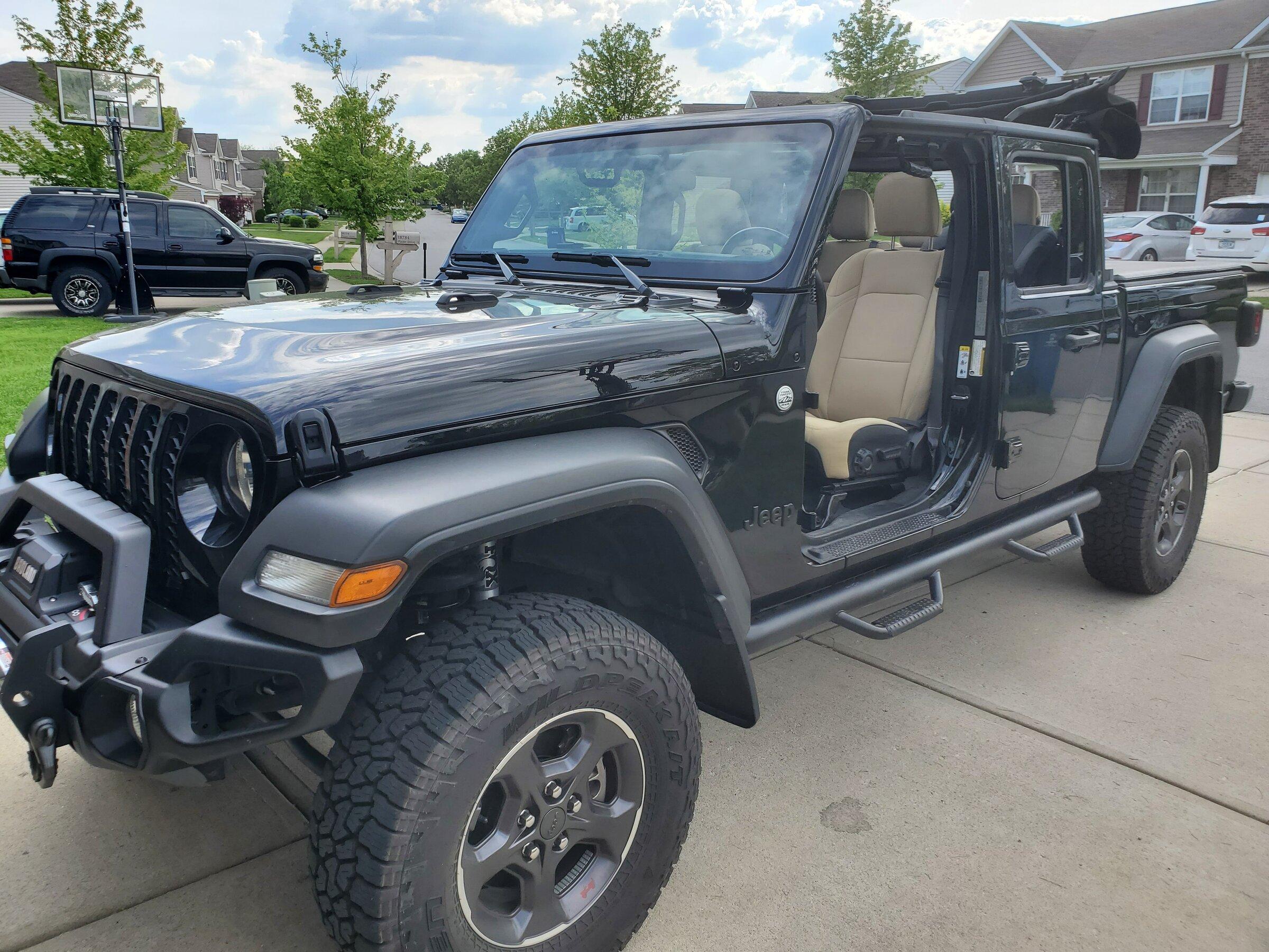

Jeep Gladiator Pic request!  Mopar 2” lift on 33’s (on non-Rubicon) 31348DDA-4157-418D-A3A7-EA7951440DC7
Still waiting on new wheels—supply chain pain.

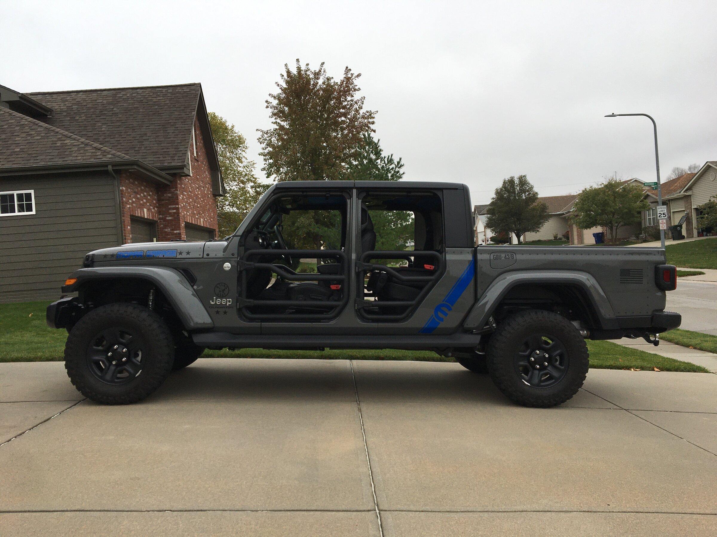

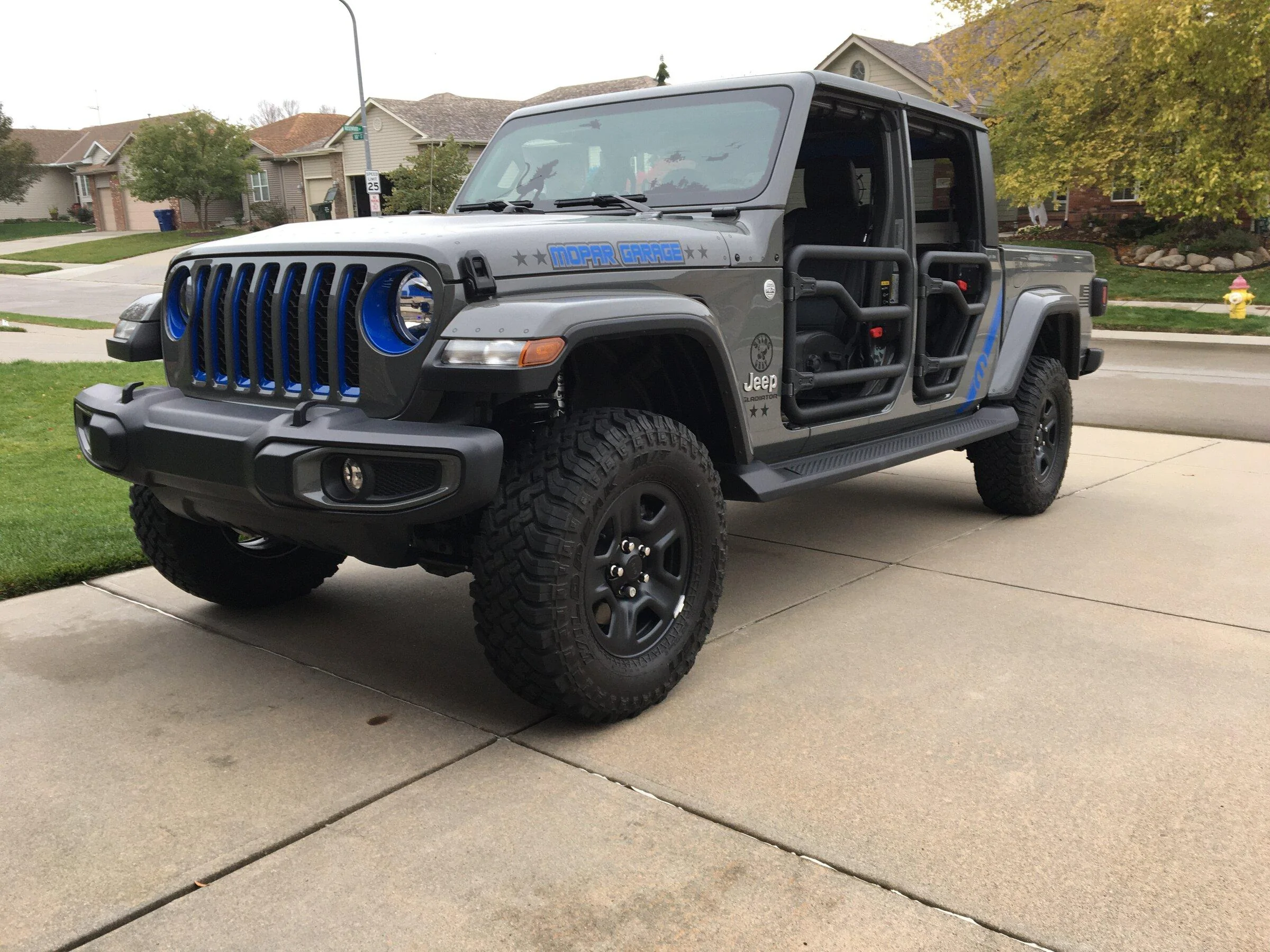

Steel Sport Wheels with Rubi take off tires and mopar 2 inch lift. I also have the Mopar accessory wheels with 37s
Jeep Gladiator Pic request!  Mopar 2” lift on 33’s (on non-Rubicon) IMG_3075.JPG
Jeep Gladiator Pic request!  Mopar 2” lift on 33’s (on non-Rubicon) IMG_3076

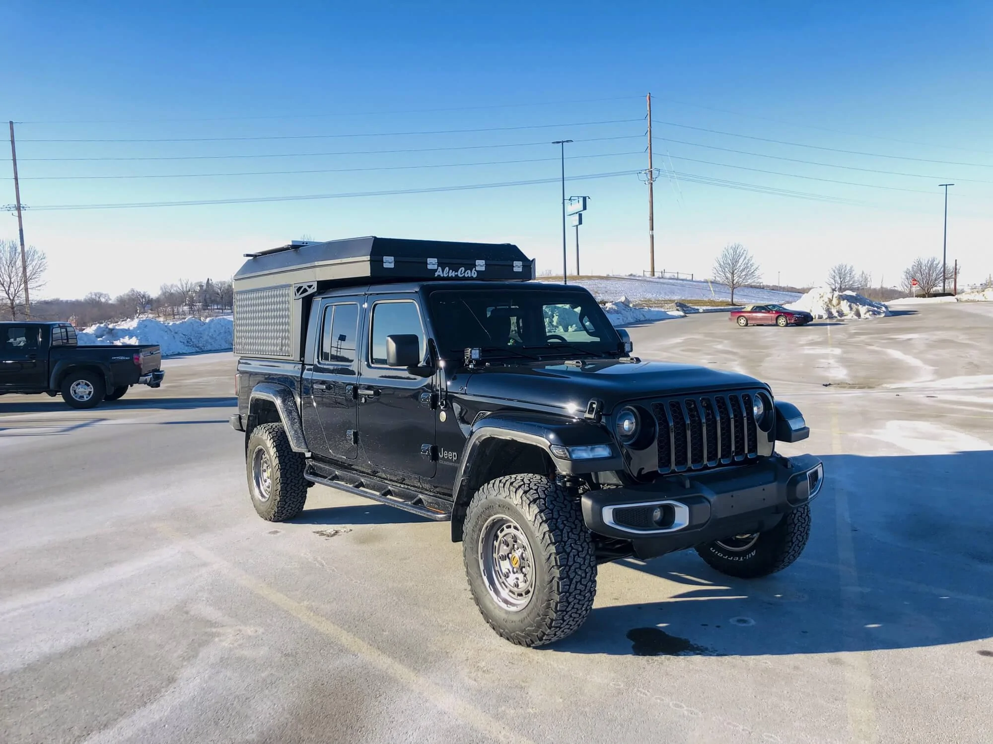

chorky
Chad
Feb 26, 2022
175
3,466
3,802
Montana
'22JTR, '06 LJ, '06 TJ GE
GIS Specialist
chorky
Chad
Feb 26, 2022
175
3,466
3,802
Montana
GIS Specialist

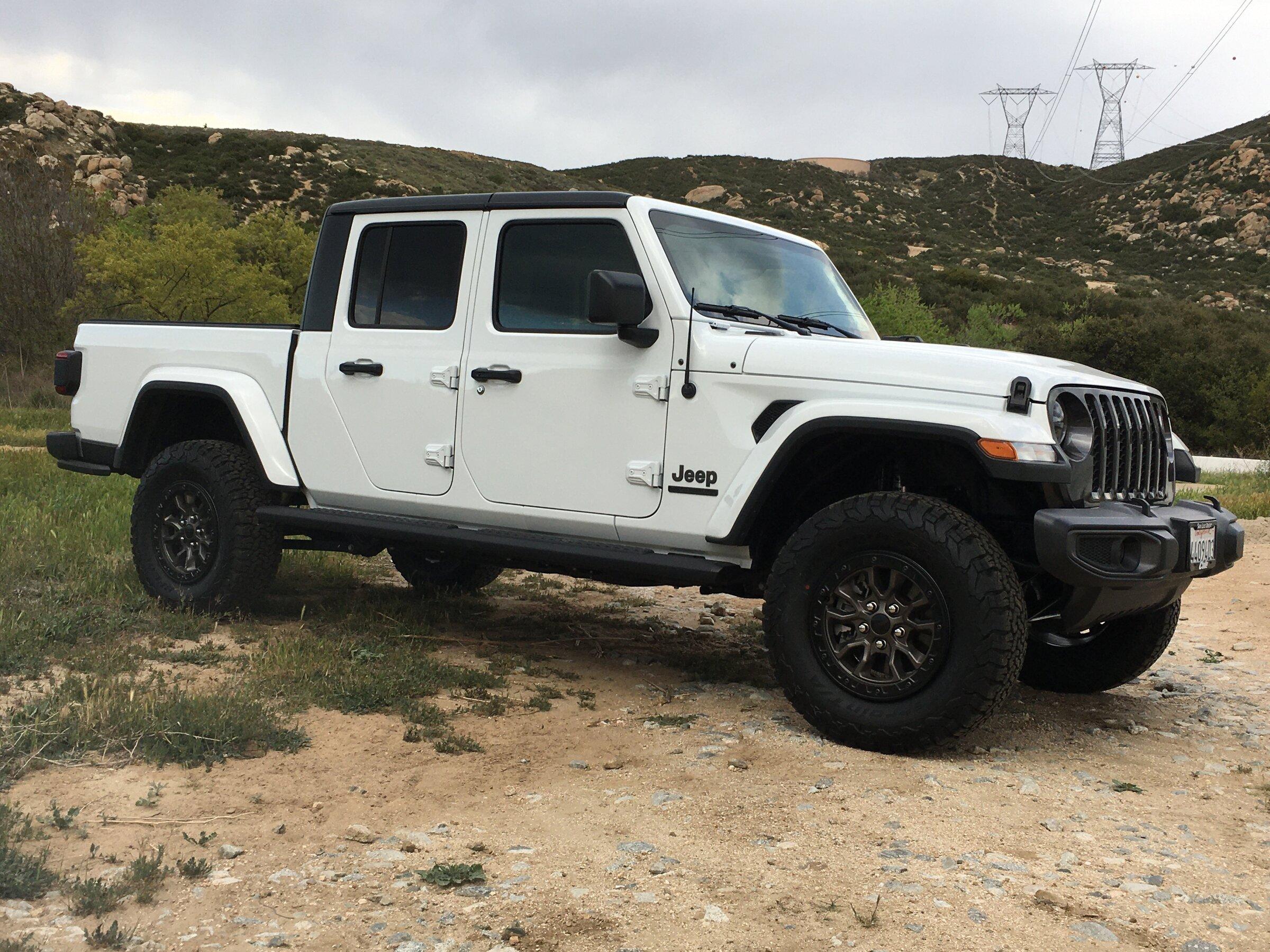

Soooo much better than stock suspension, although I also swapped the Mopar rear coils for Dobinsons and also have a Hellwig rear sway bar, which may help.
Right on. Thinking of the alu-cab also, but maybe with icon suspension. Looks nice! Hope your enjoying it!
