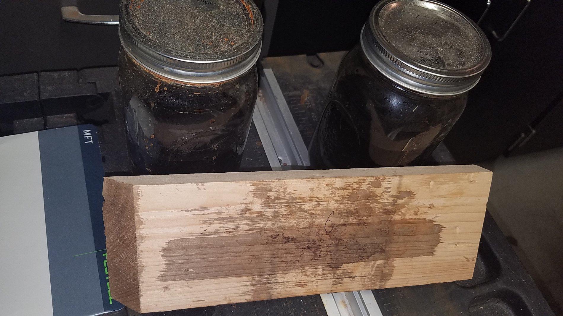

That is what happens when you put steel wool in vinegar for about 3 weeks. Makes a rusty patina solution to age wood within 20 minutes or so.
Okay so this is plywood related. It's on topic. What's good for the goose is good for the gander. What you seem to be implying is that for m vintage gladiator pizza slice, I simply soak vinegar and steel wool for a couple weeks, applique, presto bango, I've got vintage plywood!
yep, if you want to speed up the process add a tablespoon of hydrogen peroxide when you first mix it up. Oh and wash the 0000 steel with water and then pull it apart into small pieces. This washes the wax or something off of it, and then makes the surface area bigger i think.
I would put it in a glass jar either outside or in your garage, it'll bubble, and presumably create lots of gas, no idea if its flammable or not.
You can use it within like 3-5 days, but i think its more potent at like weeks to months when the steel wool fully dissolves. If you want to speed up the process of what i call oxidation of the wood, use a heat gun after you brush the solution on with a rag.

Truth be told i've never tried this on plywood, but i'm sure it'll work.
As you can see the left edge was treated this way, top edge is not and is fresh wood from my track saw. The face you can see the wipe and a bunch of splotches. This is where i rest my rag while i'm treating the edges of my "barnwood" wall in my tv room. Every one of those board was a 8+" board cut down to 3-5" wide. So 3 out of 4 faces are "fresh wood. I typically do the two miter edges and maybe the long edge if it was near eyesight.
