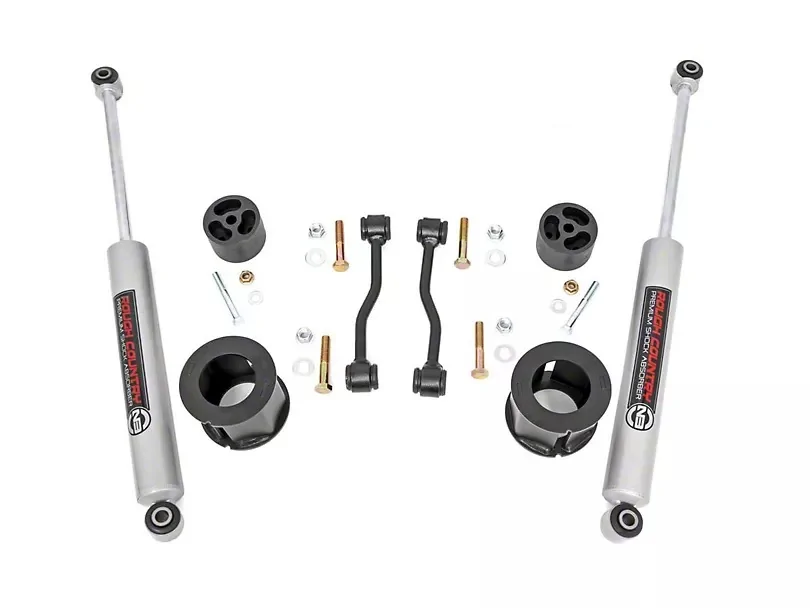

So I have a 21 gladiator with 17k miles on it. I also have the rough country 2" puck lift in the front end and 35" tires, It was installed the night I picked up the truck so its been fine for the last 17k miles. Surprisingly, they have not given me a hard time about the lift, in fact they havent even said anything about it.
