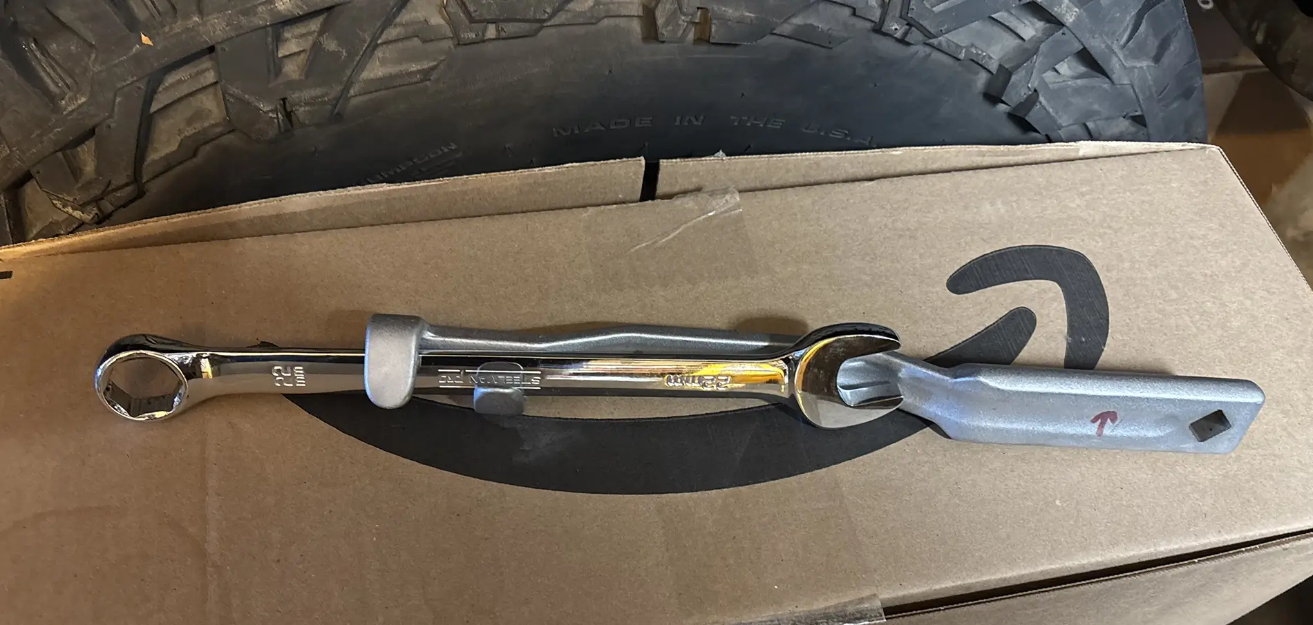

I used this combination with my torque wrench for checking my ball joints:
Jeep Gladiator 21 gladiator Front end popping noises even parked 1773792676412-5d
