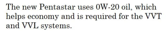

As said multiple times in the other threads - that one only counts in the cold - when you want oil to flow fast and shoot out to the cam lobes easily. Thicker on cold starts is an issue.
The 30 vs 20 - hardly any real difference, they actually overlap a bit.
From a master tech training document -
Jeep Gladiator Posted already? 1748472609744-fo
Of course it's a "do whatever you want" thing.
If it makes you feel better, fine.
But there's really no logic to it other than it doesn't blow up and it feels better knowing it's thumbing the nose at "those government regs" while ignoring the fact that the automaker engineers sit with oil company chemists and experts and come up with the oil formulations.
They work together. Oils are formulated to meet the automakers needs, the automakers tell the oil makers what is required.
