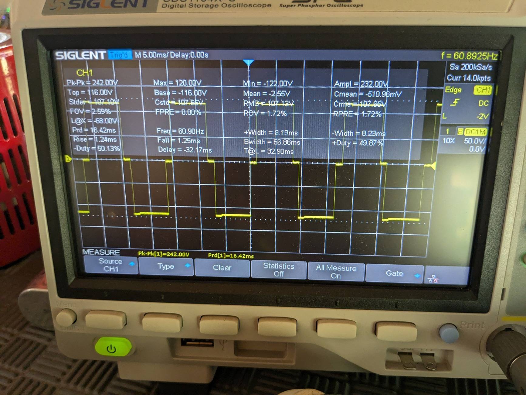

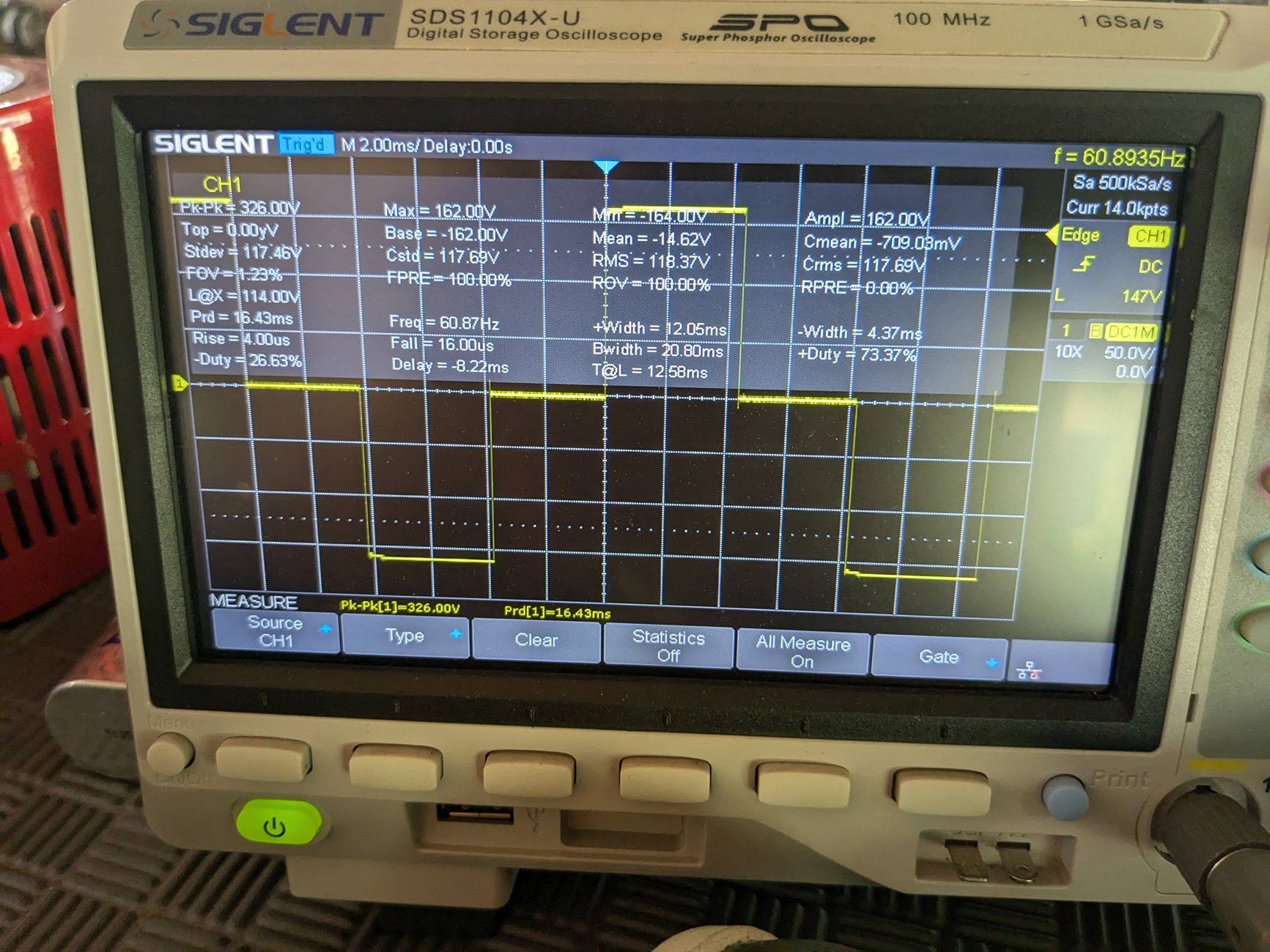

the opposite of a pure sine wave inverter. In other words, very bad news for sensitive electronics. If I knew this I would not have used that inverter to test my starlink mini. Hmm.... Pretty surprising, but also not surprising. I wonder if the one in the bed is any better for those who have that. But the factory inverter can be had for a couple hundred bucks I think which is very cheap compared to a high quality unit.
We actually had an issue with Starlink with the large mobility panel for the first time in over a year. It kept rebooting the WiFi router. The Jeep was running and it was running off the inverter. I moved it to the goal zero 1500 and it never recurred. I was at the time charging the goal zero, and charging a Milwaukee battery. So I was using more watts than usual, but I absolutely wasn’t getting close to 400w. The goal zero uses a max of 118w when charged via 120v. Starlink uses between 60 and 100w. I don’t know what the Milwaukee charger uses, but it was an old one, meaning not a fast or super charger. Either way, no more jeep inverter for Starlink, except maybe if it’s the only thing plugged in. But probably still not.
