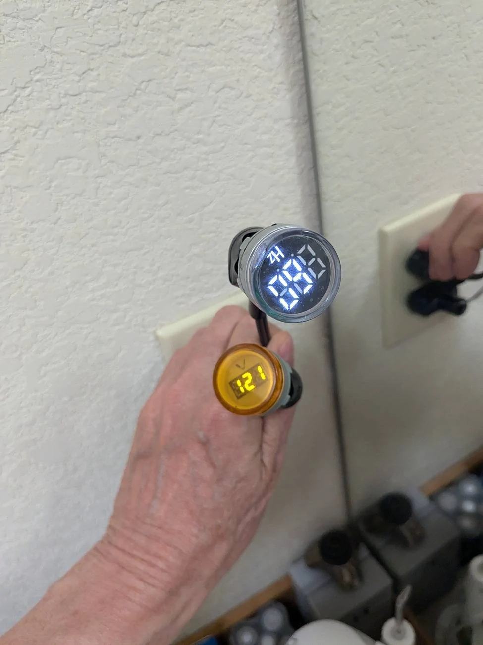

Well Yes - I had an issue that motivated me to hook up the Oscilloscope; I was measuring the Voltage, and Hz/Frequency with two different LED measuring devices - photo of them attached, from Amazon - Normally they just work and nothing noticeable, but in the Gladiator when I pick them up to look at their display they were very hot to the touch on their base, almost burn my skin hot - very unusual - now I know why;
Also - what do you mean by "Low Voltage AC" - this is normal AC Voltage like what is in my home, 60 Hz, 120V - nominal, 120V can range from 110V to 130V ?

My original post with the 2 Oscilloscope pics show the oscilloscope's digital calculations of various parameters with no-load and a 200W light bulb;
no-load was +162V, -164V Square Wave; RMS calculated as 118.37V;
200W load was +120V, - 122V Square Wave, RMS calculated as 107.13V;
Many other parameters shown in the display pics;
