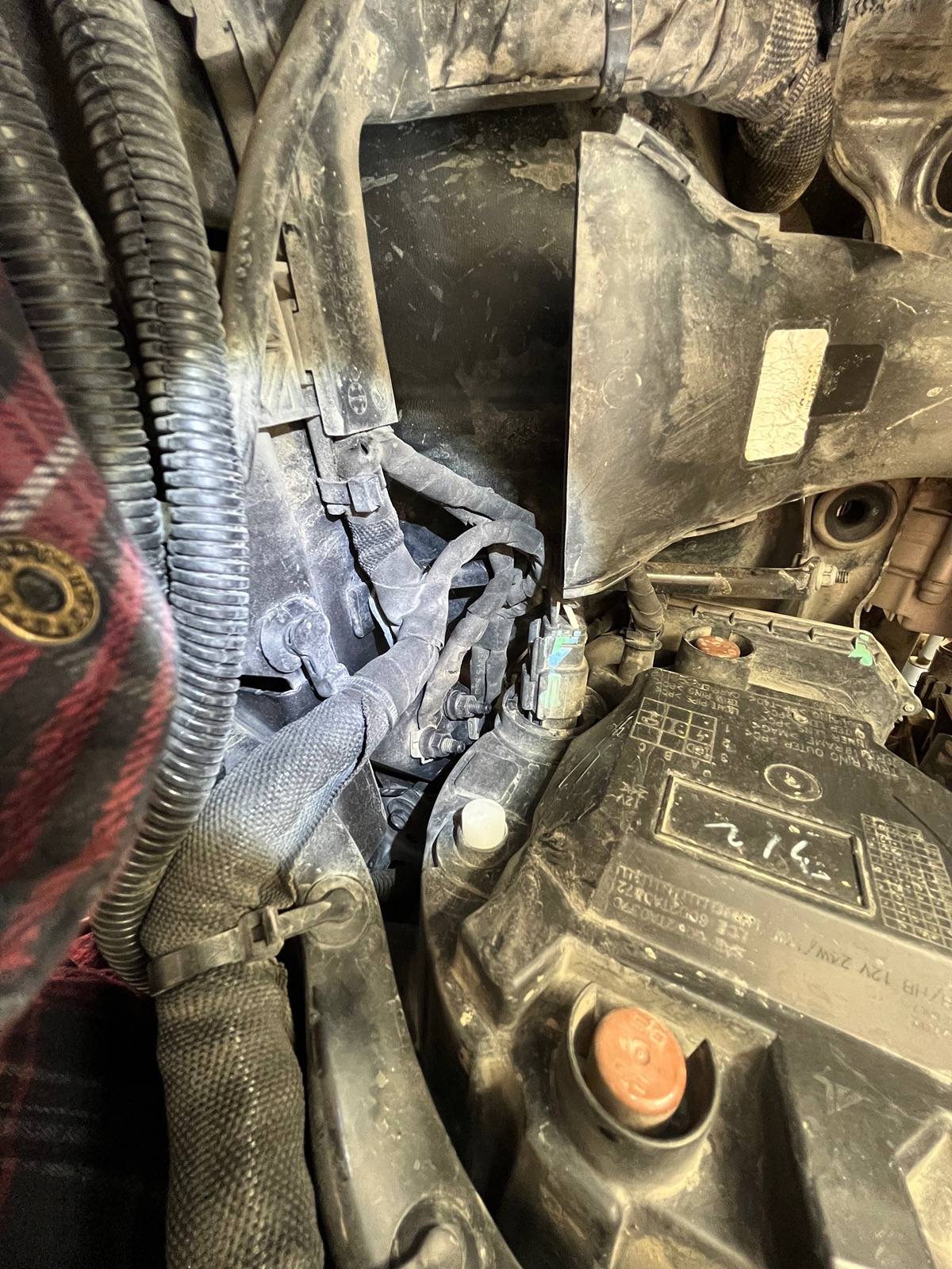

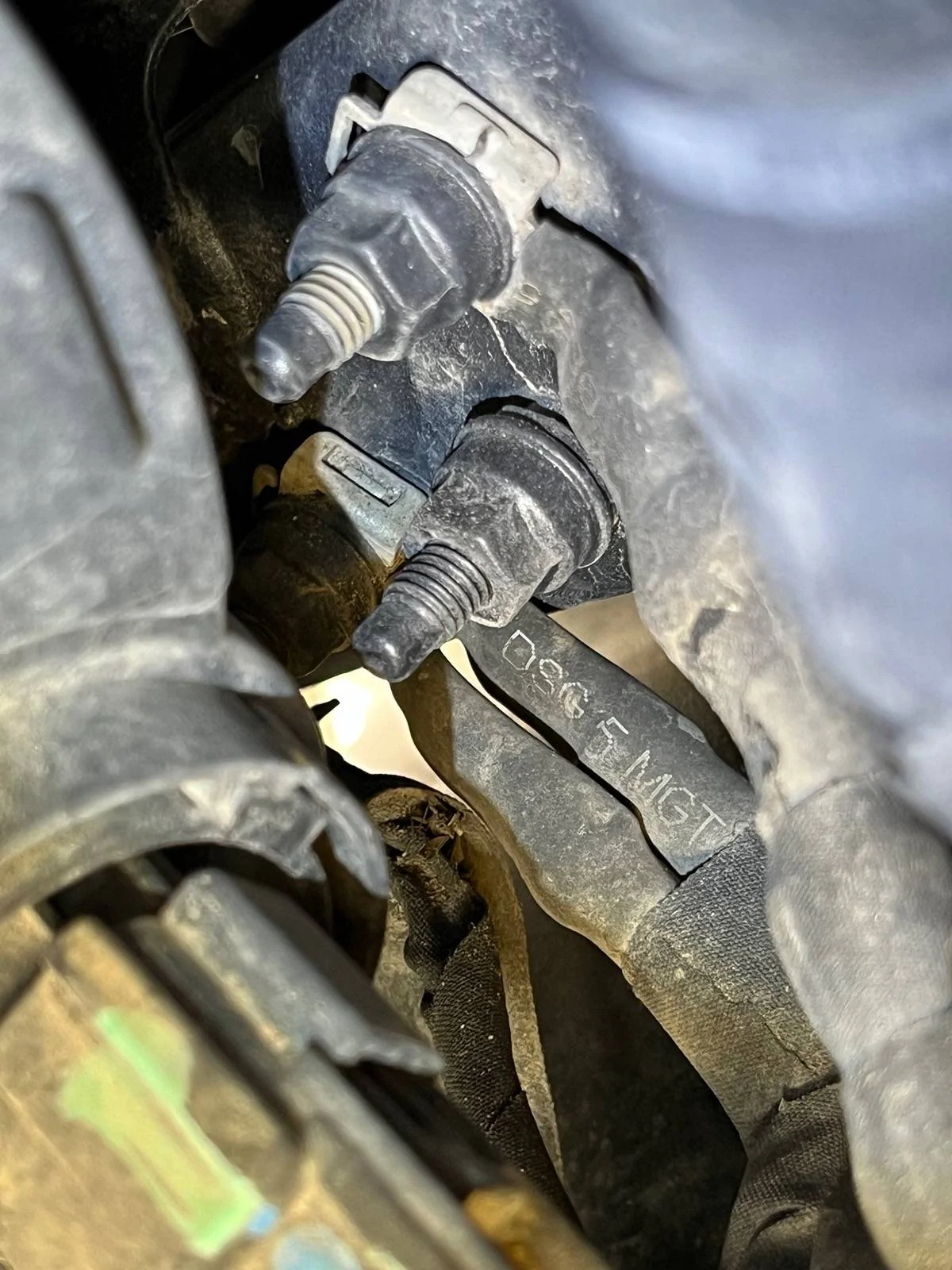

Behind the passenger headlight is three ground posts. The upper one has one wire attached. The middle one has no wire attached and the bottom one has two wires attached. Are you saying the upper one is G908A and to move this one down 1/2” to the middle post?
Yes that should be your ground for the EPS pump exclusively. Easy enough to verify by unplugging the pump and unbolting that ground, then measuring resistance from the pump ground to that stud. best to disconnect the battery prior though simply because the pump is a constant 12V circuit at all times. If that is indeed your ground for the pump, removed the free and open ground next to it, clean the contact points real quick and try it. Doing this over the course of 2 minutes will allow to know if the ground wire is good and if the connection to chassis ground is good. Also if the grille can easily be removed. It's substantially easier with the headlight housing removed as well.

Yesterday morning recalling what I did in attempting to restore power to the pump, I first took off the ground wire to the upper post, cleaned it up, used a brass brush on the matting points and put it back. (I did not undo the battery for this) There was no spark on contact if 12v is constant to the pump. I then I focused on the Z case fuse and did disconnect both batteries changing that out.
The question I have is if that top ground post is corroded enough to cause pump failure, why would swapping out the pump for a new one make it work? New parts shouldn’t work if the ground is bad.
Also, when a new pump is ordered, does it come with a new harness as well?
