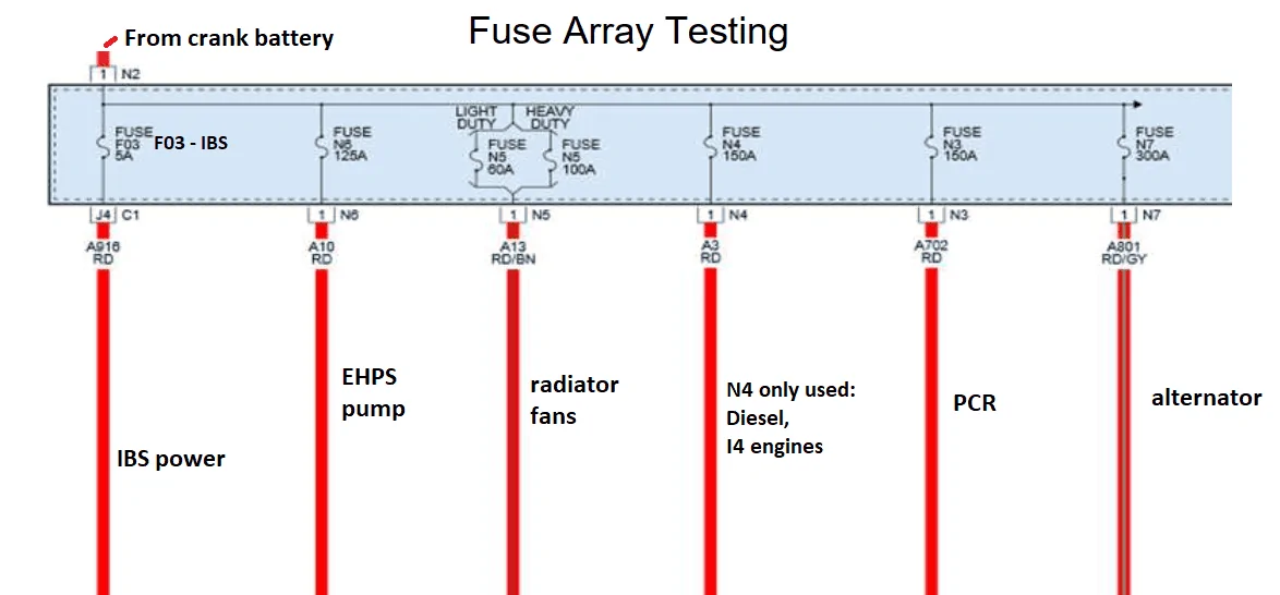

In case it wasn't stated. N7 should have constant 12V, even with key off. That terminal runs straight to the pump. I just removed the pump and associated wiring on a 2023 JT.
See my prior post - N7 goes directly to the alternator fuse. It may appear to be the EHPS because it's all on the same bus, but N6 is the fuse for the PS, N7 is the fuse for the alternator.
It has constant power because it goes to the alternator and batteries. Any terminal along that fuse array N2 through N8, will be hot unless that leg of the fuse is blown. N1 should have power at all times as well since it goes directly to the aux battery.
In other words, all of those will be hot at all times.
But only N6 is for the EHPS. If it's not hot, that fuse is blown.
N2 - crank battery to the bus or main part of the high current fuse.
N3 - PCR
N4 - not used with gas,
N5 - Radiator fan
N6 - PS Pump (EHPS)
N7 - Alternator

Be careful - he's incorrect on how these are wired......... unless it was just a typo.
(EDIT - apparently it was just a typo)
I previously posted the correct fuse terminal uses. N6 is power steering. 7 is alternator.
And frankly, ALL of them should be hot at all times since they are all connected directly to the battery.
