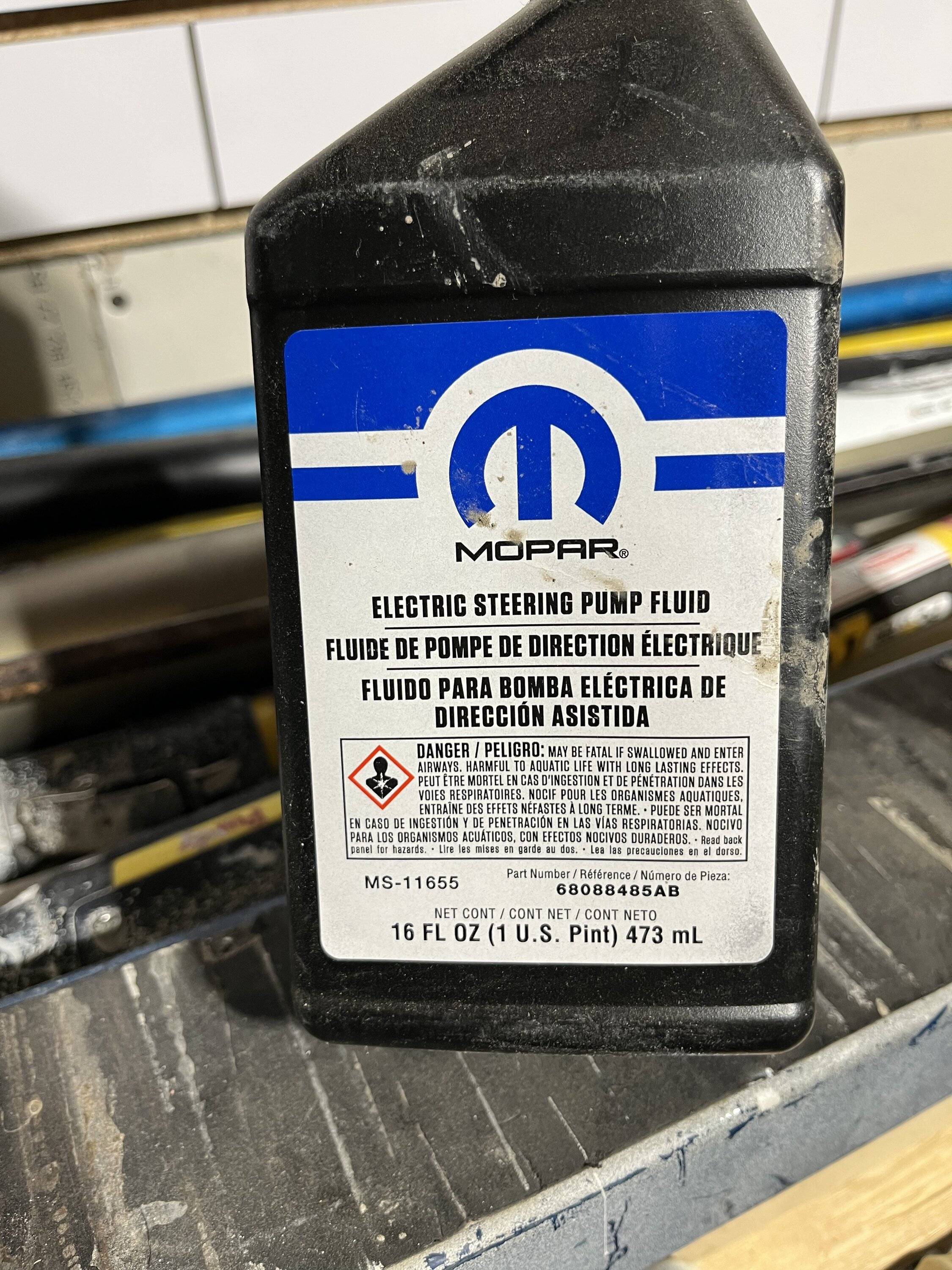

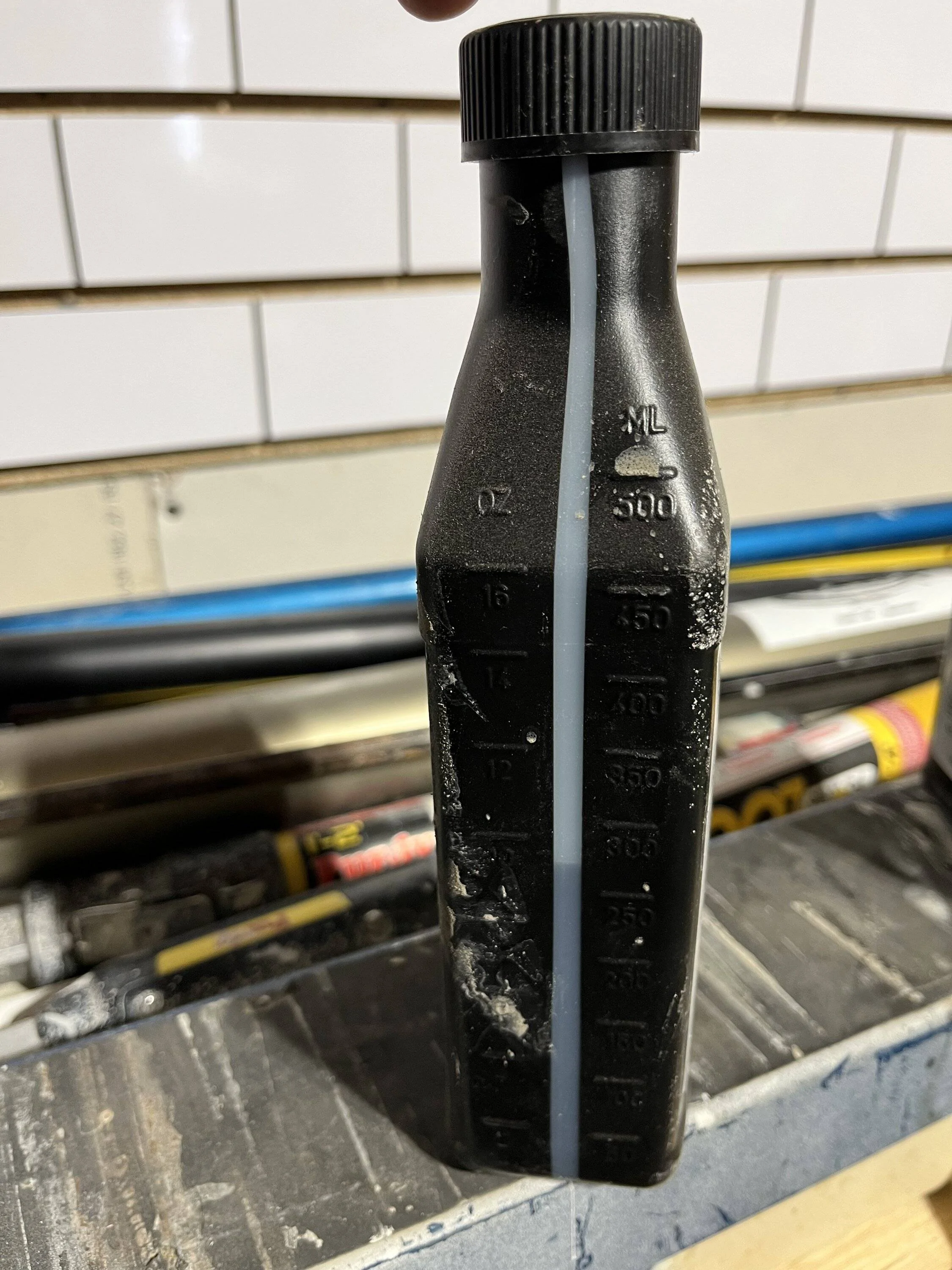

After I got my last pump replaced last summer, after I got home from a trip to BC of over 1000kms with no power steering, and AFTER burping out the air lock on my last two pumps, this photo shows I used 1/2 litre more of oil on the pump I have now. So far so good.
Jeep Gladiator Low power steering fluid F35E9EF7-007F-454E-9A2A-2A5EFB31D758
Pardon me. But I believe that is 1 cup used out of 2. 1 pint = 2 cups, 1 pint ~ 0.5 liters (as shown). Missing that much fluid would be catastrophic, I believe. Though I don't doubt there being some air in the system, or others such as coolant.
Yes! You are correct. Itā€™s a 1 pint bottle. All 3 pumps were down 1 cup each. Thanks for pointing that out.
