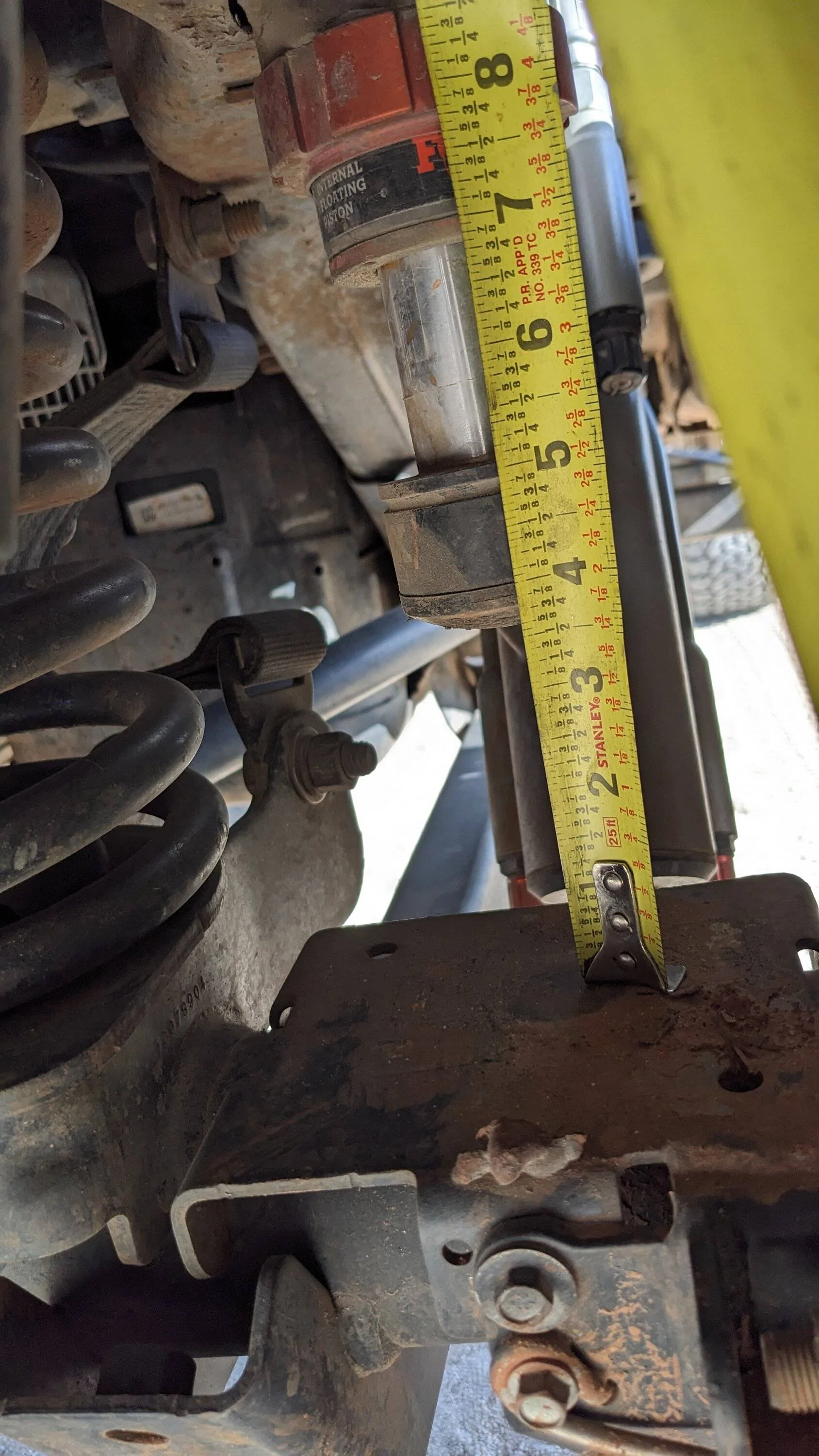

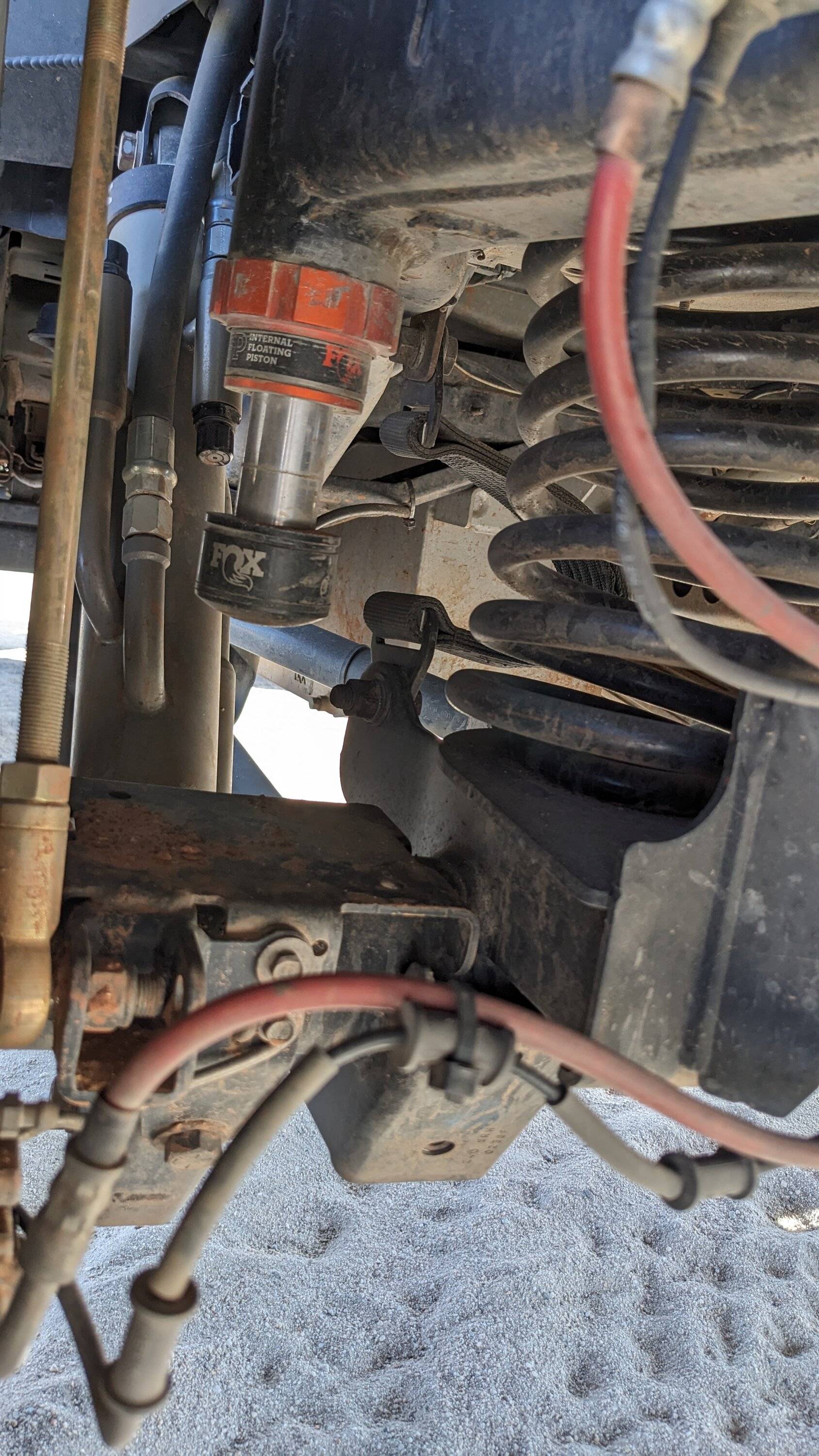

Piroman683, do you have limit straps on the f/r? If so, could you snap a pic of each? That is next for me.
piroman683
piroman683
Sep 13, 2019
427
462
Long Beach
2019 Gladiator

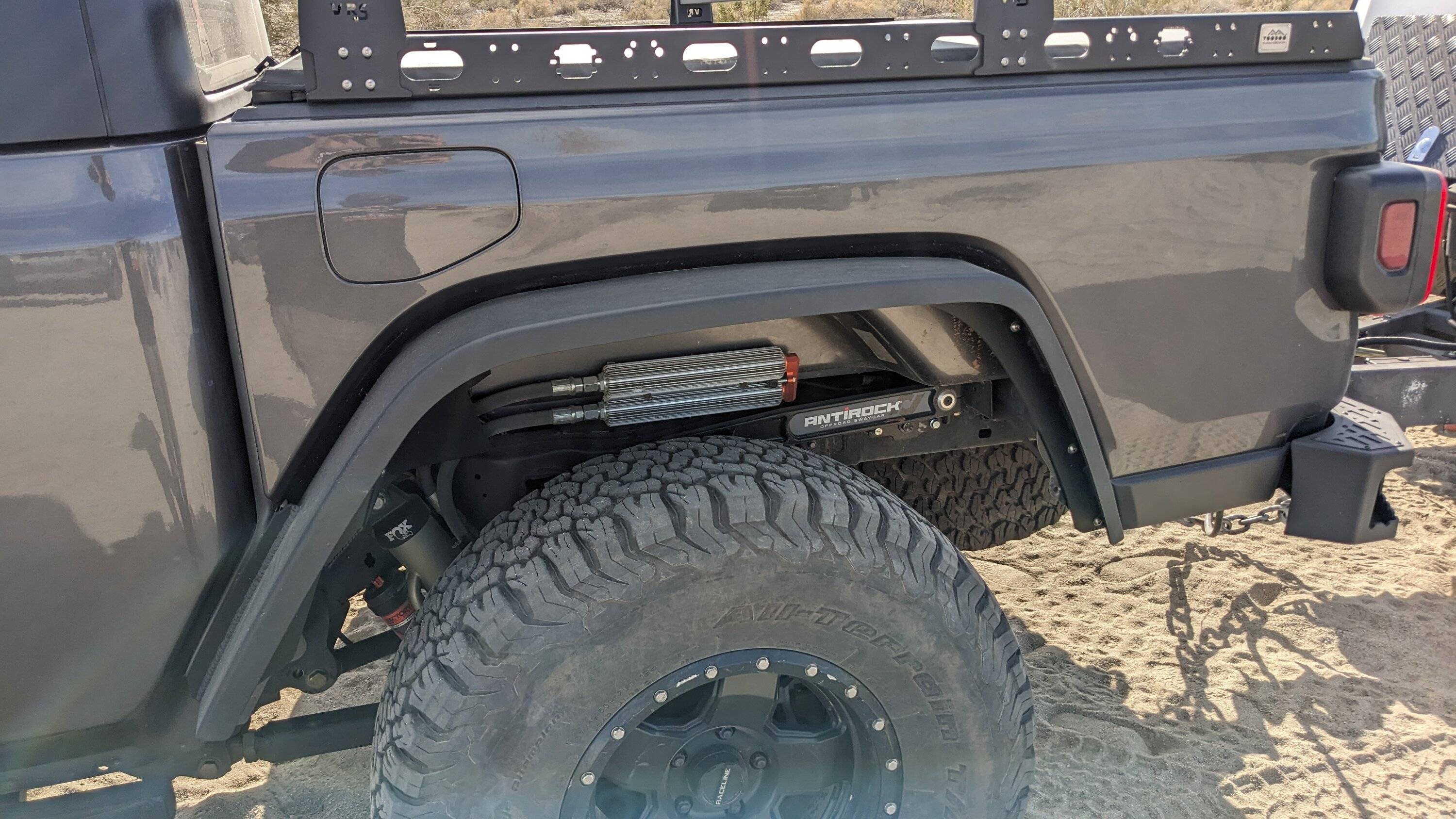

i do have limit straps on the rear, I welded a tab to the inside of the frame and connected the strap to one of the upper control arm tabs. i dont have straps in the front yet, the suspension locks itself out when you hit about 30in of shock extended length, however, I dont recommend relying on that, its on my list of things to do correctly.
I should be able to snap a photo this evening and will post here for the rear limit strap.
