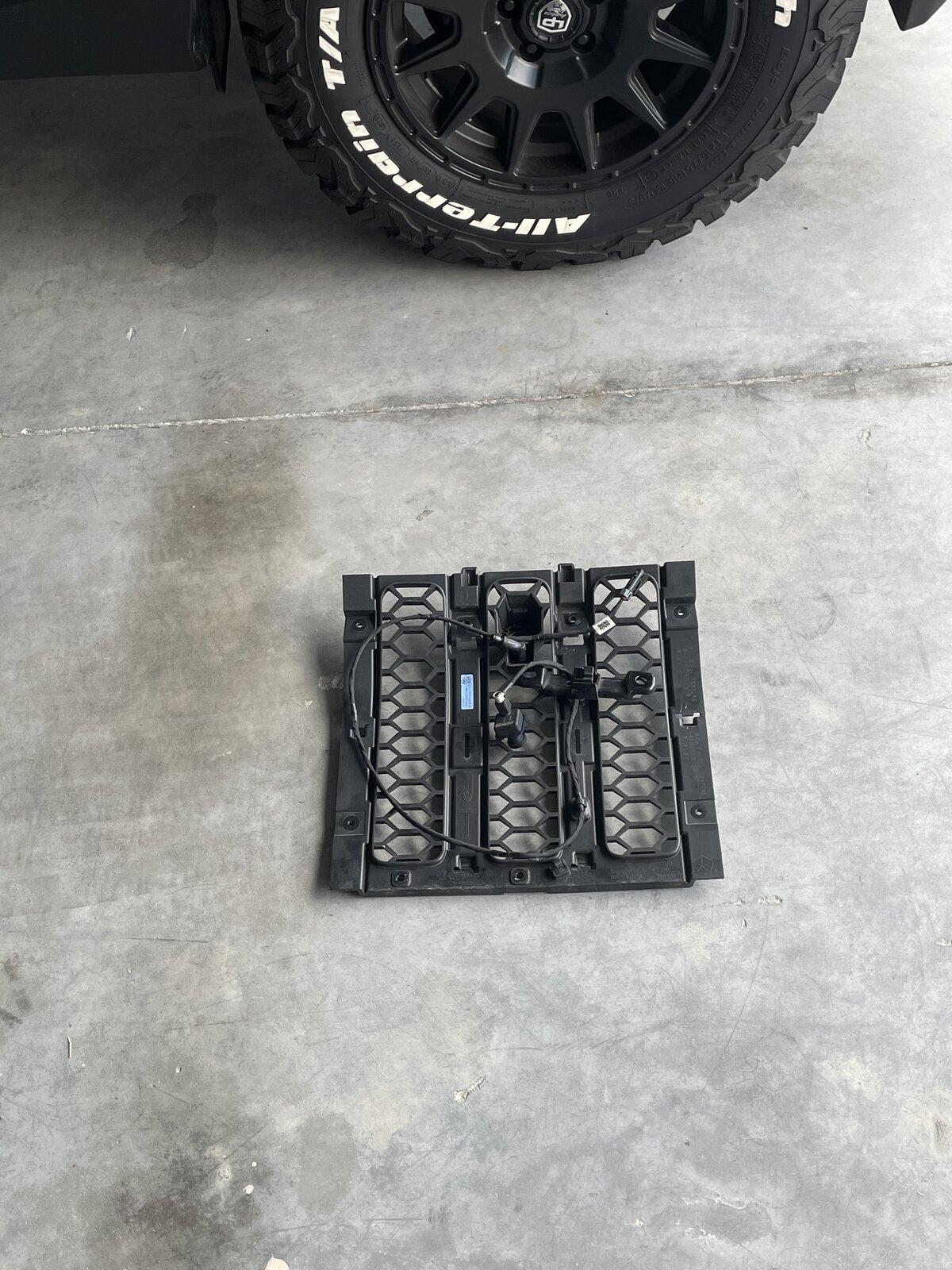

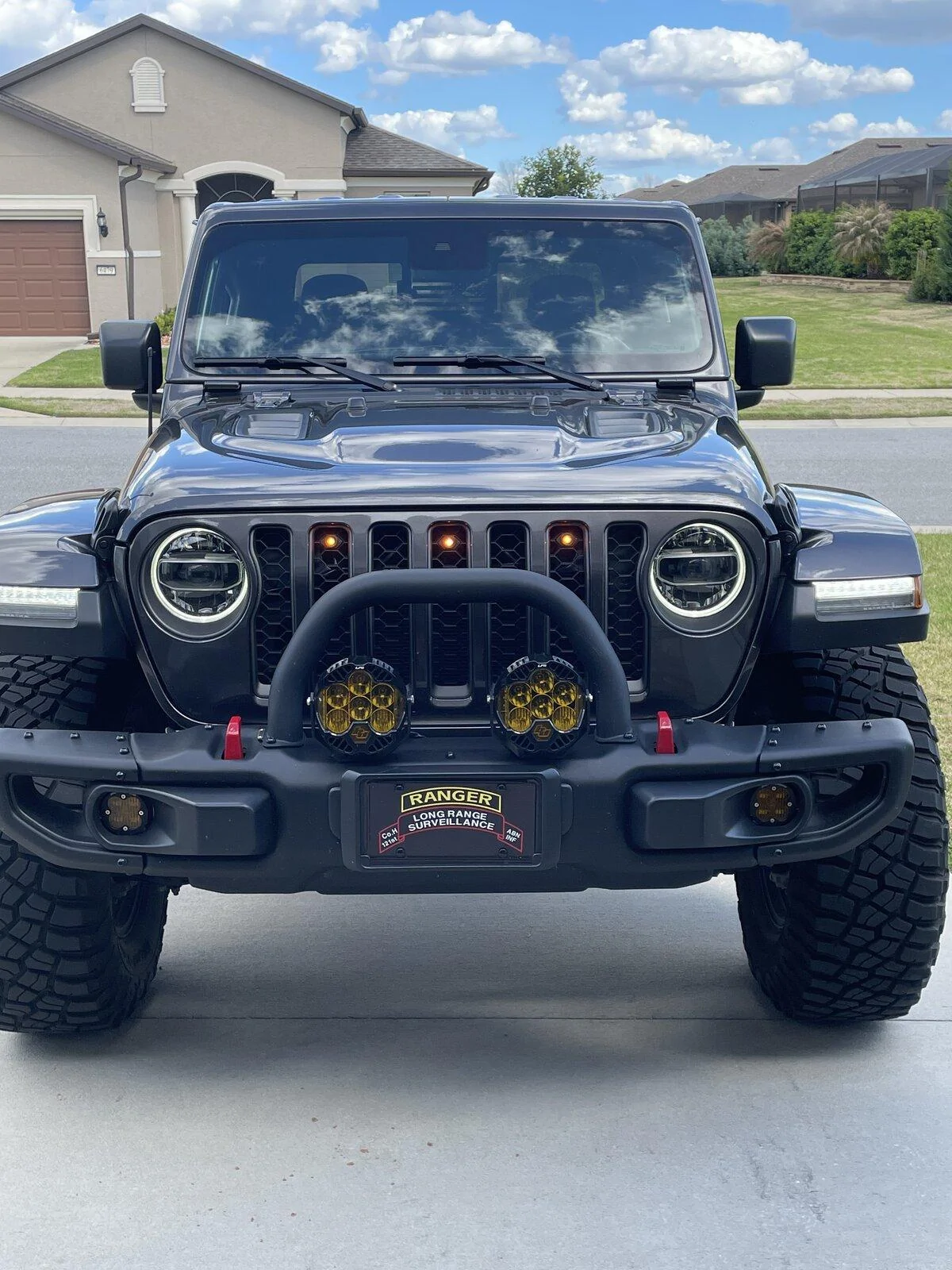

I went with the Quadratec lights. I had the front camera that I never used mainly because the bull bar blocked most of the view. Had to buy the center honeycomb piece ($15) to fit the center light. Instructions said to mount the lights in the second row from the top; however, I like the look of the lights as close to the top of the grille as possible and it fits just as well in the top row. Also, FYI, when you use the harness that comes with it, the pre runner lights only come on with the parking/head lights on. I wanted them on with the DRL’s so after I realized this, I pulled the wires, cut off the plugs, flipped it to run the wires on the passenger side, and connected it to Aux switch 4. Having done both, believe me it’s a helluva lot easier to connect it to your switches than to connect the plug in to your fender light plug. Overall, very happy with the look.

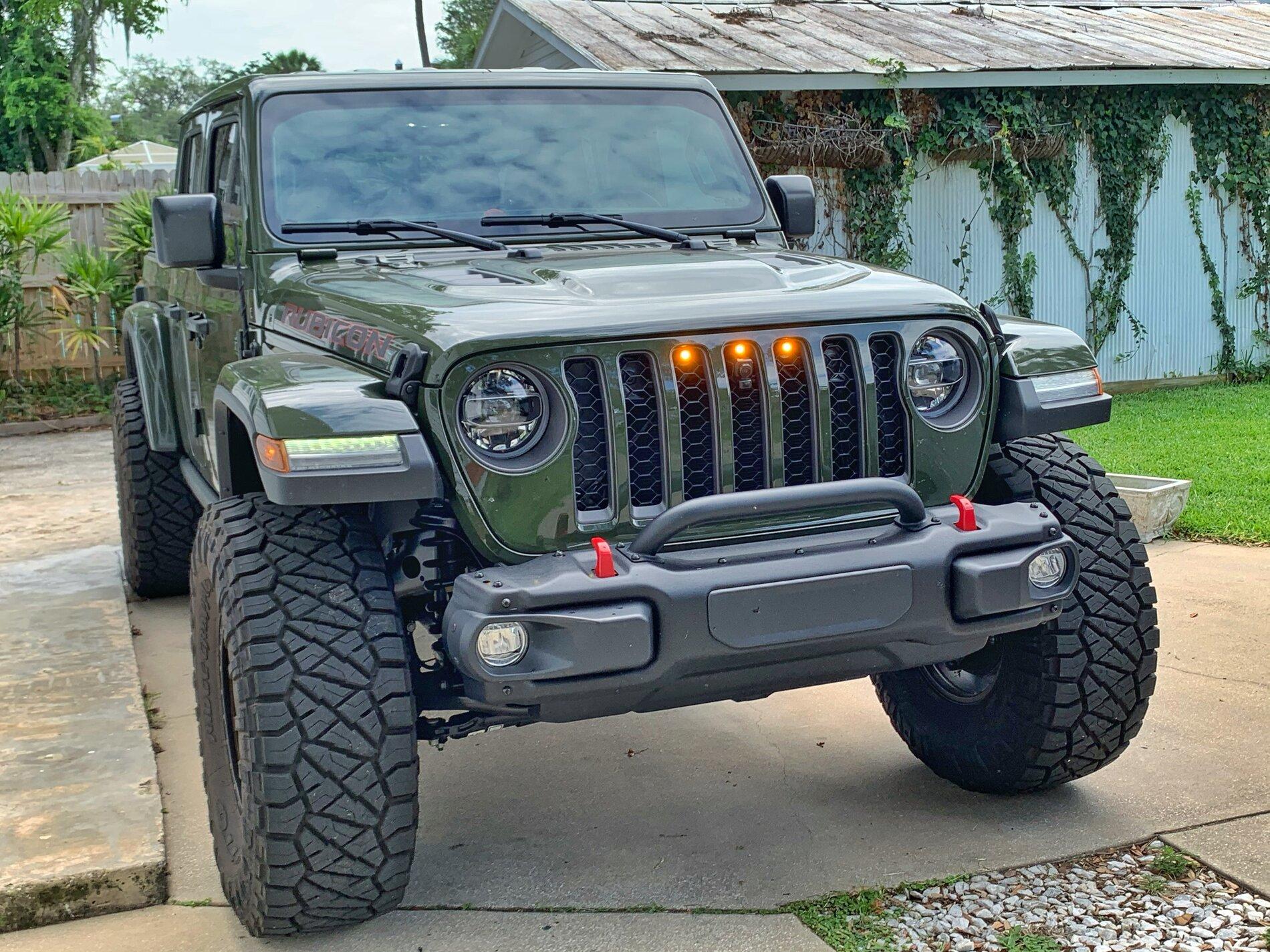

I went this direction. Hope it helps
Are these the Quadratec or Oracle lights? If they are the Quadratec how did you get them to fit in the upper opening? I believe that space is smaller.
These are the Oracle. The horns behind the grille prevent the spaced out every other opening option so I tried this in top holes. Prefer it now. Looks good on and off.
