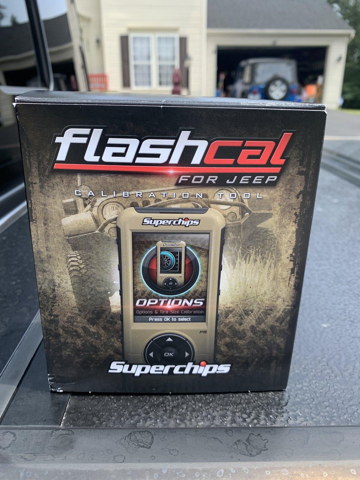

I did buy a programmer but that also doesn’t seem to work.
Either your not doing something right with the programmer or those lights are faulty. Seems more like something isn't taking in the programmer. After you set it to Led's does the programmer allow you to do a ECU reset and which programer are you using
Mlibby
Mark
Jul 24, 2021
2021 Gladiator Sport
Sales
Jeep Gladiator LED lights 8A37CEDB-CA33-45E5-A284-7C80CA77E205

That's what happens when the jeep isn't recognizing the LEDs. It's looking for a light putting out more power, or wattage and the system shuts them down. That's a programmer issue

Reach out to Superchips support , sounds like the programmer isn't making the setting stick , maybe a a sequence of steps it has to go through to make the change

I've got the same programmer. I upgraded to the Mopar LED lights on my '18 JLUR, and the programmer worked fine to activate them. One thing I noticed with the FlashCal is that it I needed to turn the Jeep on/off a few times for it to "sync". But I never had the problem you mentioned. Have you tried going back to the stock configuration on the lights though the programmer, then trying to activate the LED's again?
