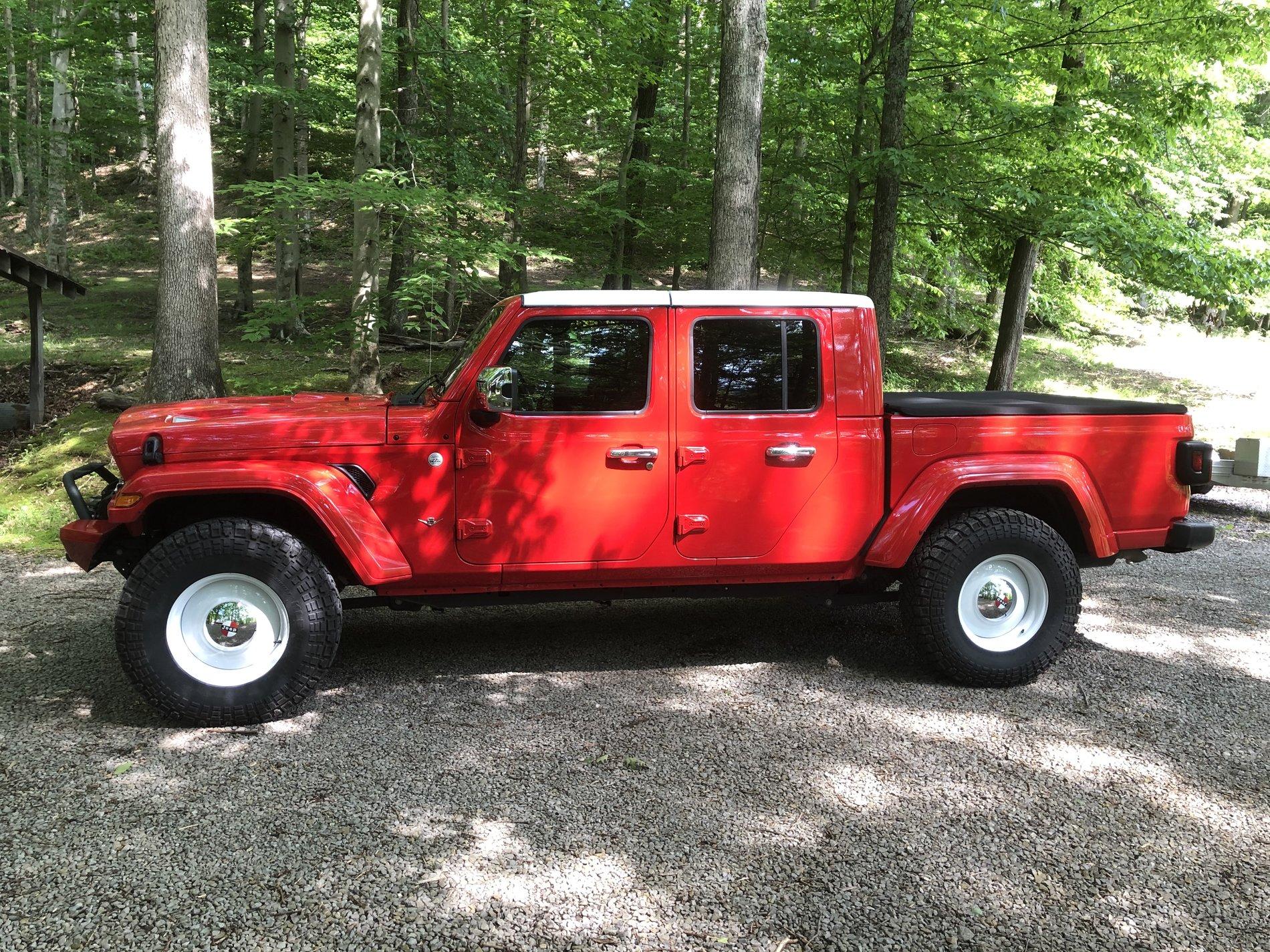

Those are wheel vintiques jw smoothie. Got them from Summit racing. Wheel Vintiques can tell you the part # for the caps which summit also sells but They don't list (or they didn't)
Thet old style jeep logos where made by a sign making friend of mine locally. If you would want those I can get you in touch with him. He can even do different colors.
You will need regular lug nuts (with open end) The factory lug nuts will bottom before torque
17x8 with a 5" backspace. They also have 17x9.
They are pricey...I remember when we threw these steel wheels in the garbage and put on a set of white spokes or a set of aluminum slots. Now I pay a premium for them...go figure.

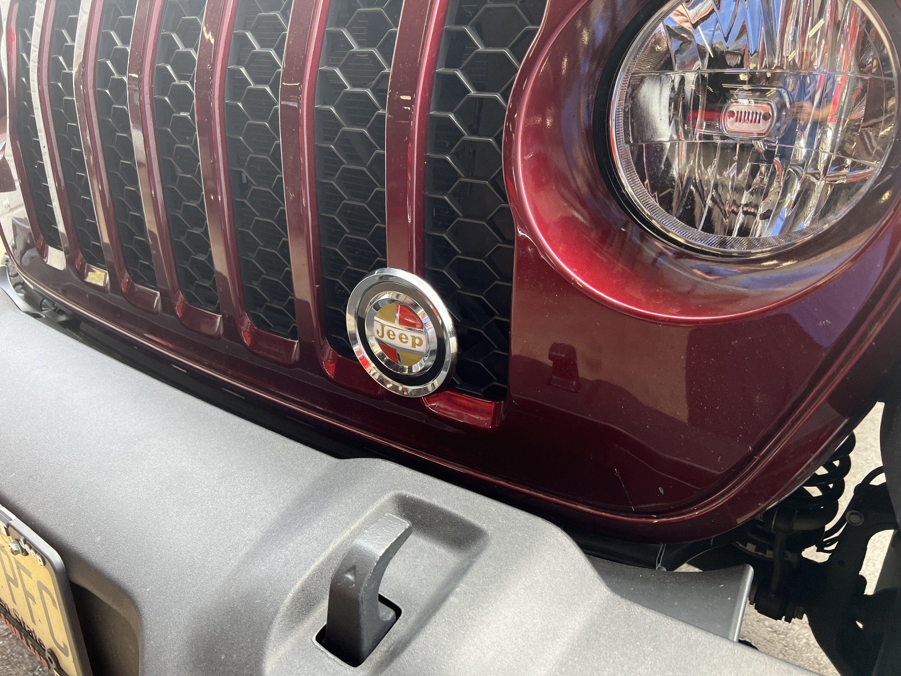

Was gonna say you gotta get the old Kaiser grille badge, but looks like you’re on it lol
Jeep Gladiator Project retro phase two and three complete, she's coming together EA8F9E4C-ABA2-4939-8E44-707701A7D1CC

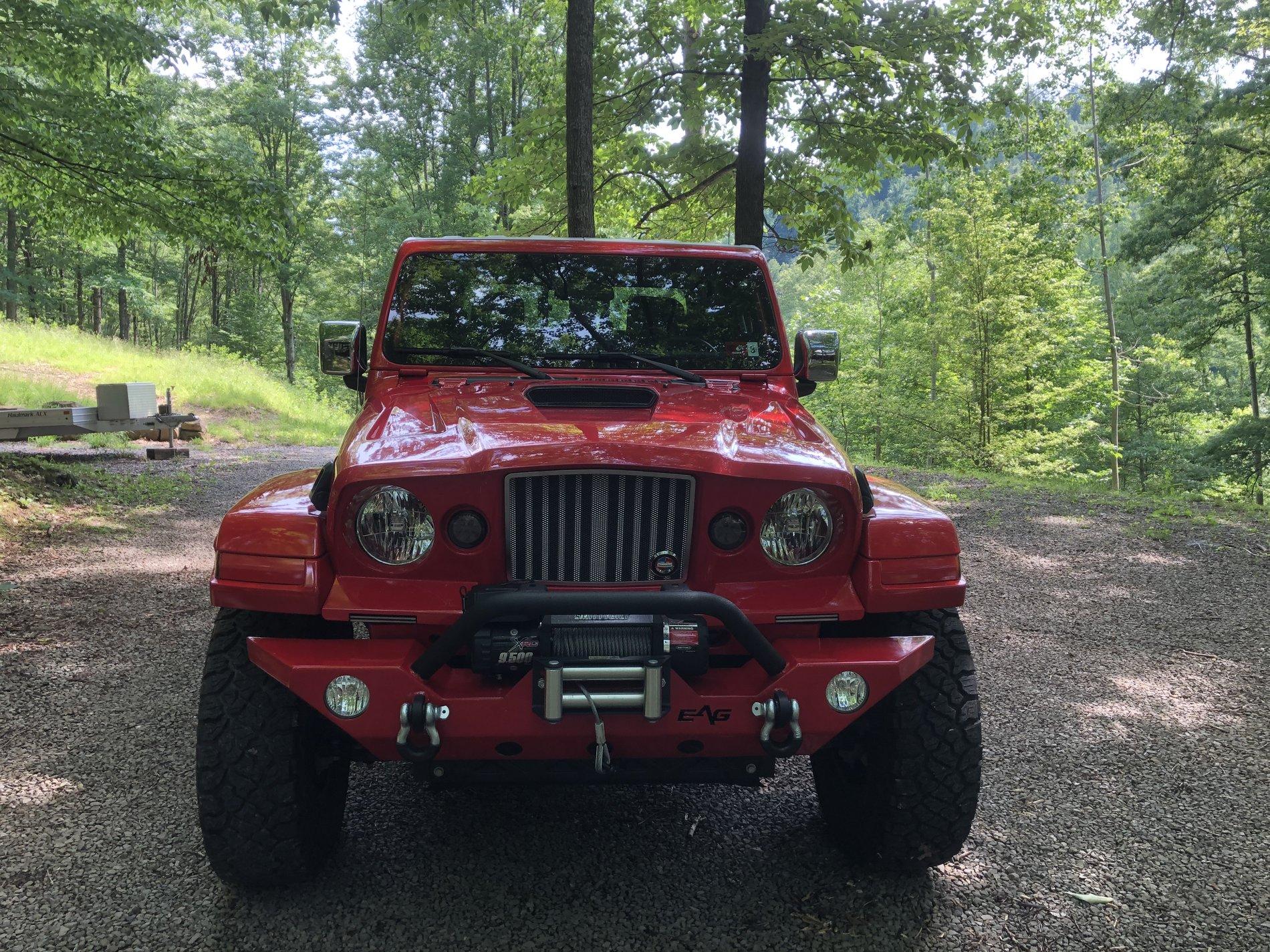

after taking a week of vacation I got most of the major mods done.
A little backstory.
In 2012 Jeep had a concept vehicle called the J12 with the old 1960's grille. I saw this rig and decided then when Jeep made it I would have one. I was somewhat disappointed when they built the new gladiator with a standard jeep grille. Not that there is anything wrong with it...I just wanted the older style.
Then I found a company (Innovative Auto Creations) that makes a conversion for the gladiator. I bought the new gladiator with this planned.
This is the concept truck I based my build from.

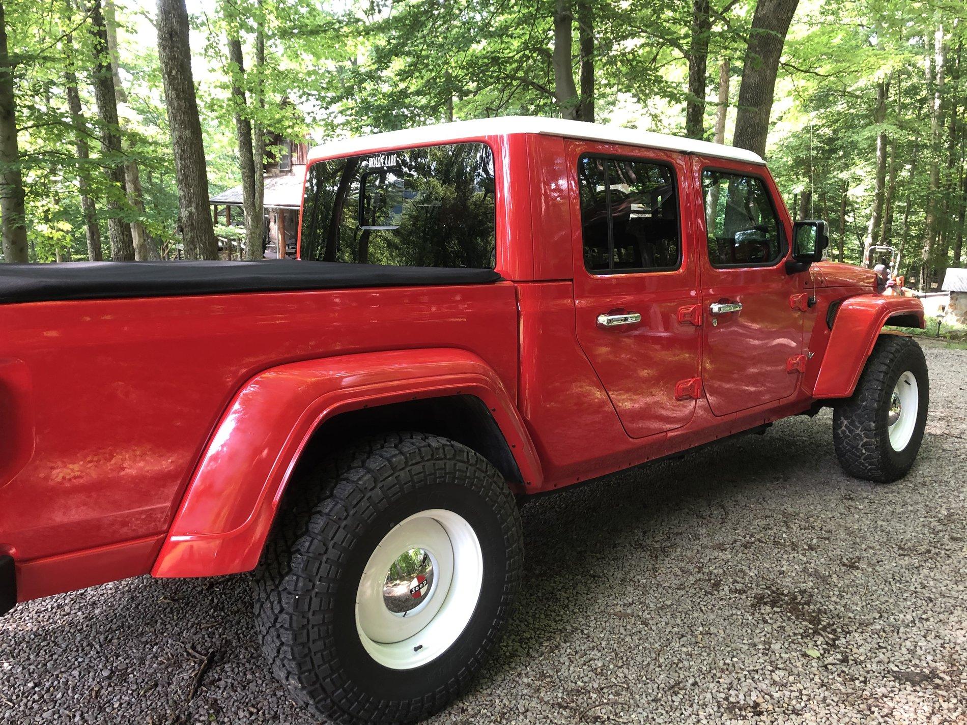

I removed and painted the fender flares body color but departed from the factory style and took the red all the way to the lip.
The top was two toned white and red for a bit more vintage appeal and made had the added benefit of making the inside of the truck way cooler parked in the hot sun.

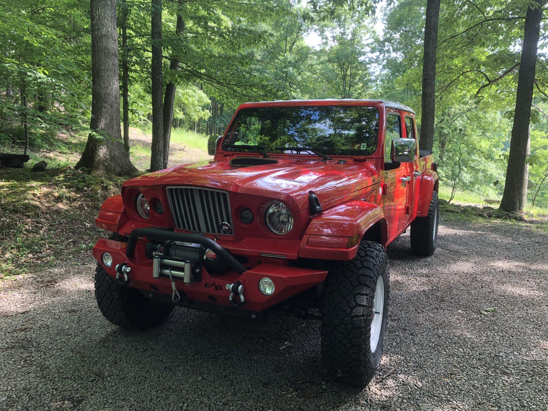

The new grill panel has DRL's and turn signals so I blinded off the originals with matching vinyl wrap and also wrapped the rear lower bed trim too. The DRL's supplied with the front end will be coming out and will be replaced with amber fog lights when they arrive.
The hood and front required very little fitting and finishing. A welcome change from a lot of fiberglass parts I have worked with in the past. Very high quality.
I had originally planned on build a new grill from aluminum as the unit supplied was only a black screen. I decided to paint it like the old gladiator grilles for the time being but it turned out so well I may just leave it as is.
While all this was going on I also added the aux switches and a Redarc brake controller...Hell, no fun in watching paint dry.
