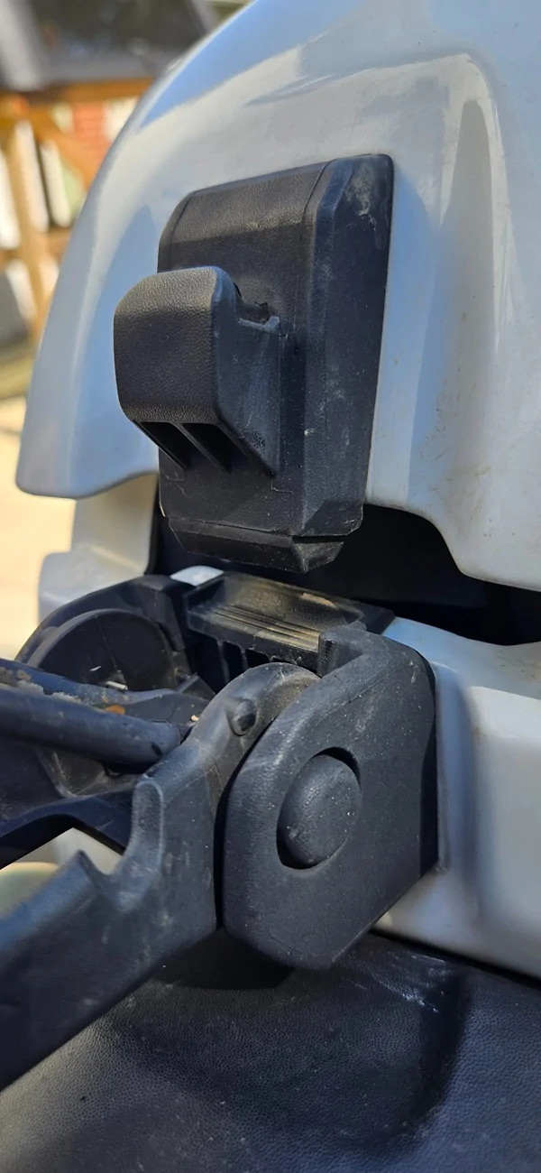

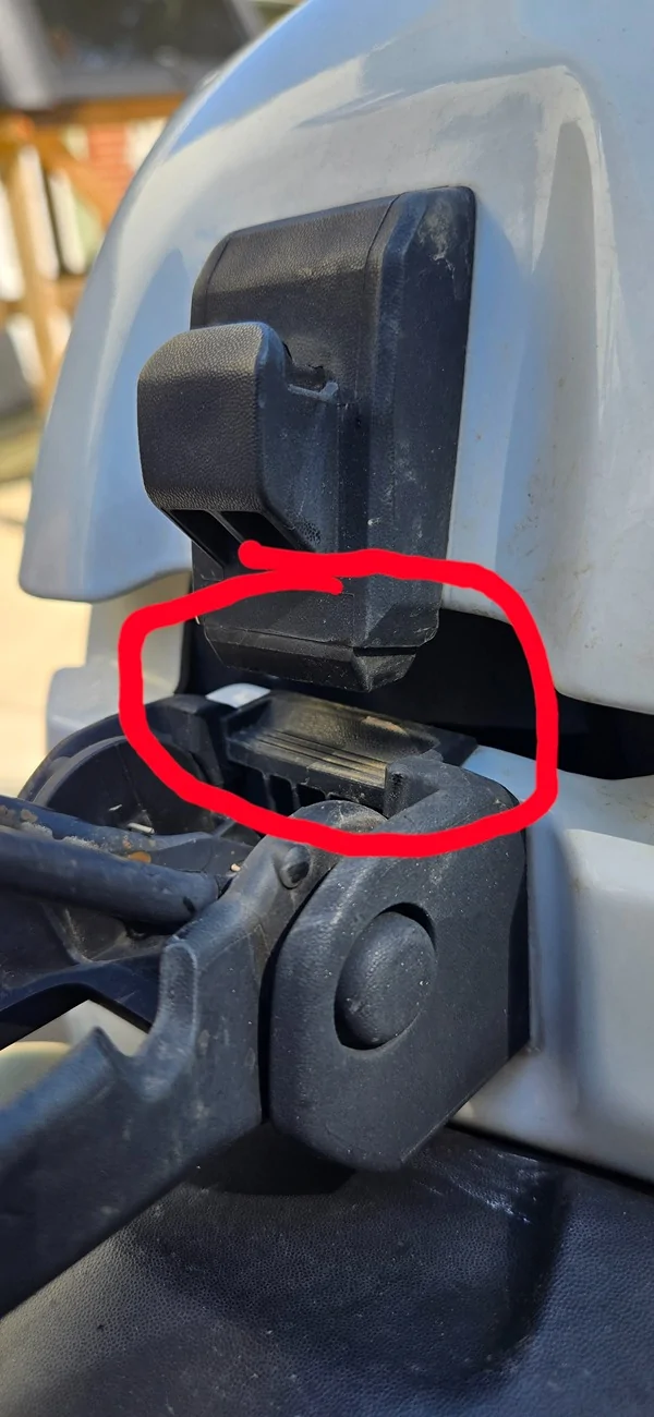

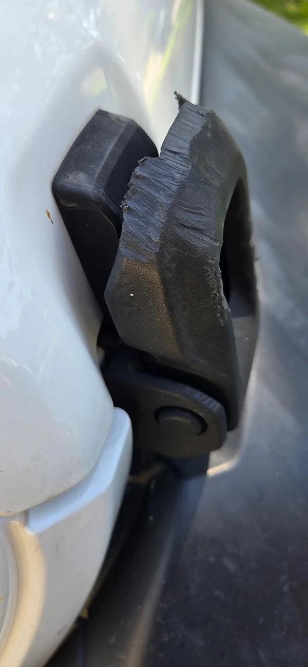

I am looking for some proper aftermarket hood latches for my 2020 JT. Have tried the usual sources that say JK, JL and JT are the same but they are not. Our JTs and assume JL has a hood "rest" built in. This rest give something for the latch to tension too. The several brands I have tried did not have the rest and there was no good way to get a good "latch" without distorting the hood down. Anyone else find something other than stock, mine are getting chewed up by varmits, lol.
Jeep Gladiator Proper aftermarket hood latch ? 20260516_104301
Jeep Gladiator Proper aftermarket hood latch ? 20260516_104316

Ill look at those dont really need the lock, thanks. I understand the solutions to critters, need to find a repair for the jeep. Again our JTs need the brace/rest behind the latch which eliminated most aftermarket.

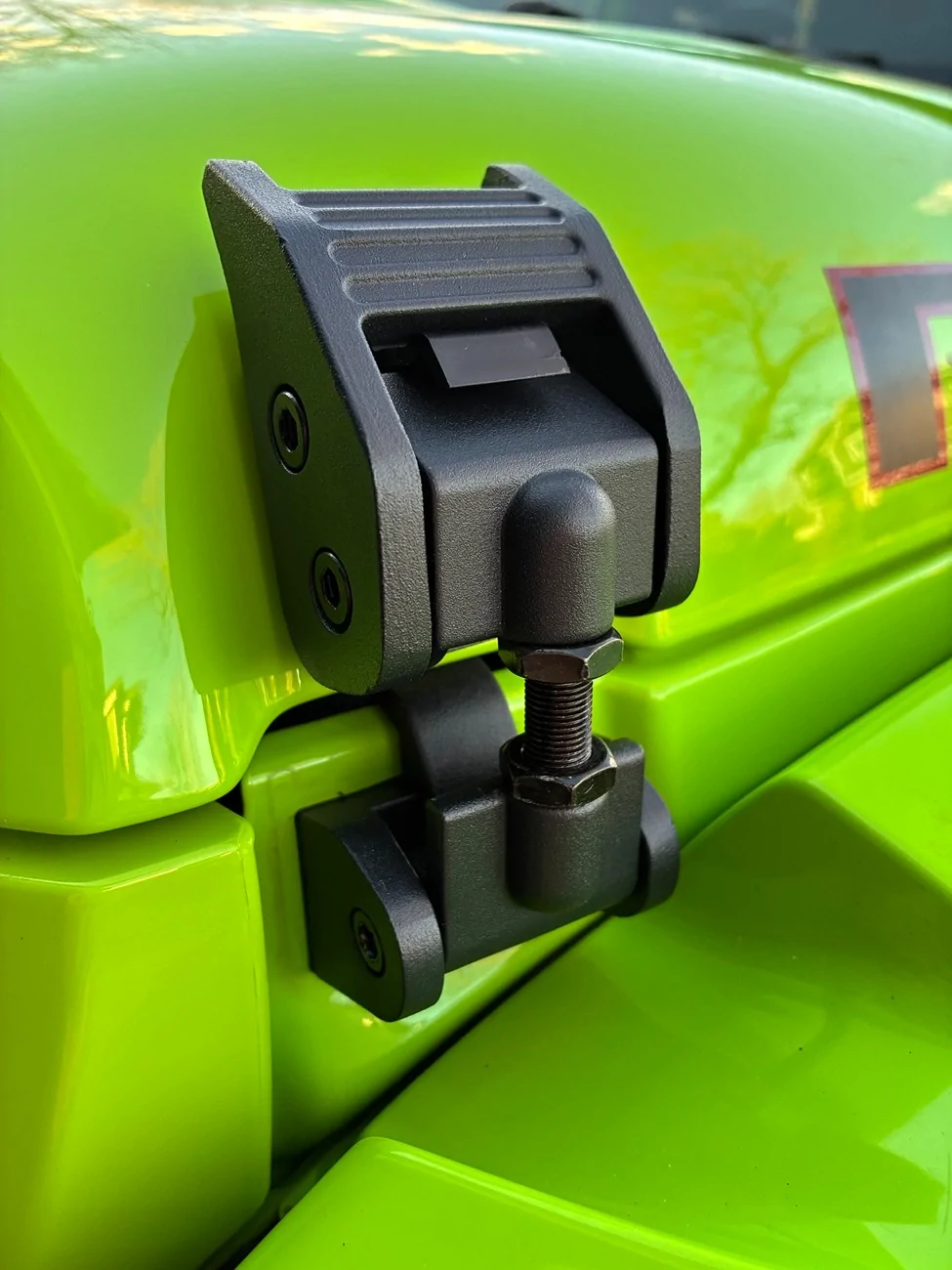

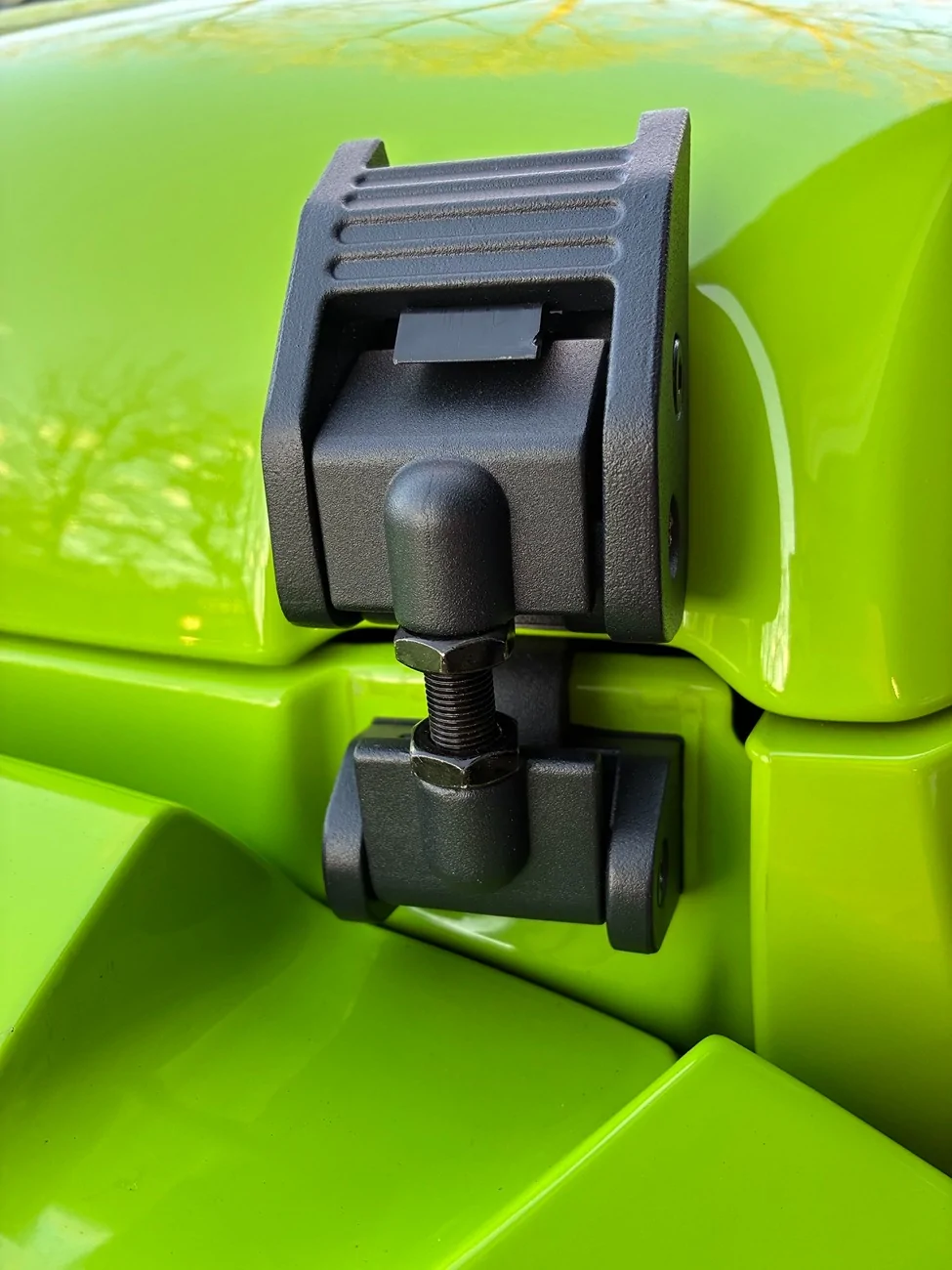

I put on a set of Ridge XHD Aluminum Hood Catches a few months ago. I had the same ones on my JK for 10 years. I really like them.
Jeep Gladiator Proper aftermarket hood latch ? IMG_0932
Jeep Gladiator Proper aftermarket hood latch ? IMG_0933
Jeep Gladiator Proper aftermarket hood latch ? IMG_0934

Im not sure how to explain what I have, maybe my 2020 is different. My latches have a rest built in that the hood comes down on. I have tried several aftermarket brands like you suggested and I couldn't get it to be solid. Ill post my picture again and circle what Im asking. Yes, I can tighten yhe latch but its warping the hood and the fender to hood gap is way off. The hood is also resting metal to metal on the header.

The latches I used back on 2022 either came with the rest or I reused the ones from the factory. They were made by rugged ridge

The locking hood latch in your photo is different from the one shown on the website.
After buying RedRock Locking Hood Catch Kit J154607, I uninstalled the new latches because the hood compression was very high, and then reinstalled the originals. I don't have a problem with hood flutter.
I'm still looking for a set of locking hood latches that won't significantly warp the hood.
As for the OP's question about latch parts, I suggest looking for a pair of OEM take-offs removed by someone who has installed locking hood latches.
Apparently it defaults to the TJ type. Enter your vehicle info on the right and the ones in the picture show up.

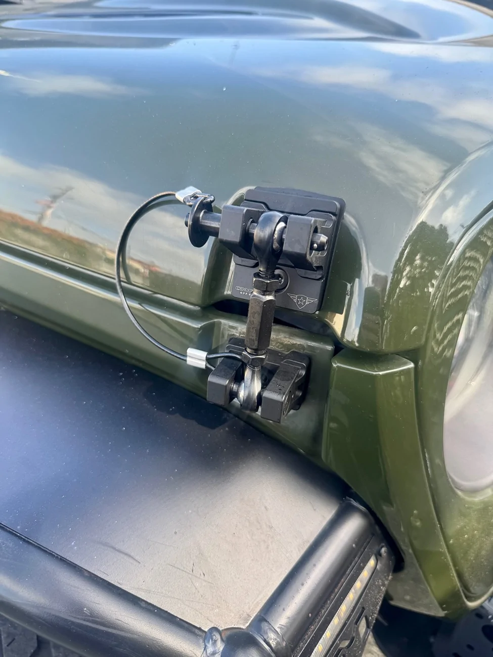

I am running these and I’m very happy with them.
I'd have bought them but they were both out of stock and substantially more expensive than the ones i posted above. Ive got a bunch of RR stuff but that gave me a couple extra bucks for other Jeep stuff.

I guess the Combat ones dont need the hood rest at the latch?
