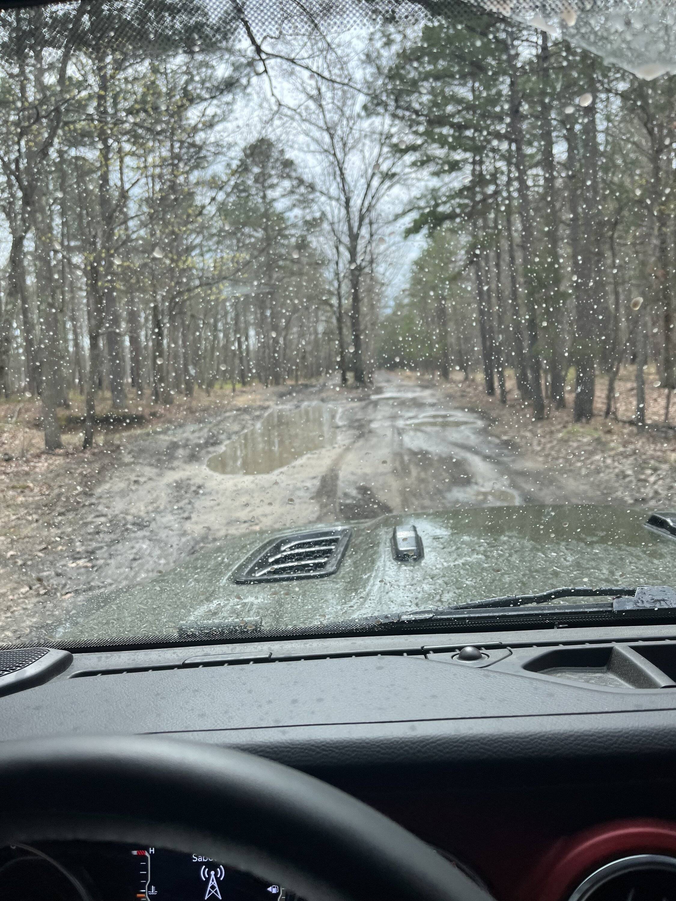

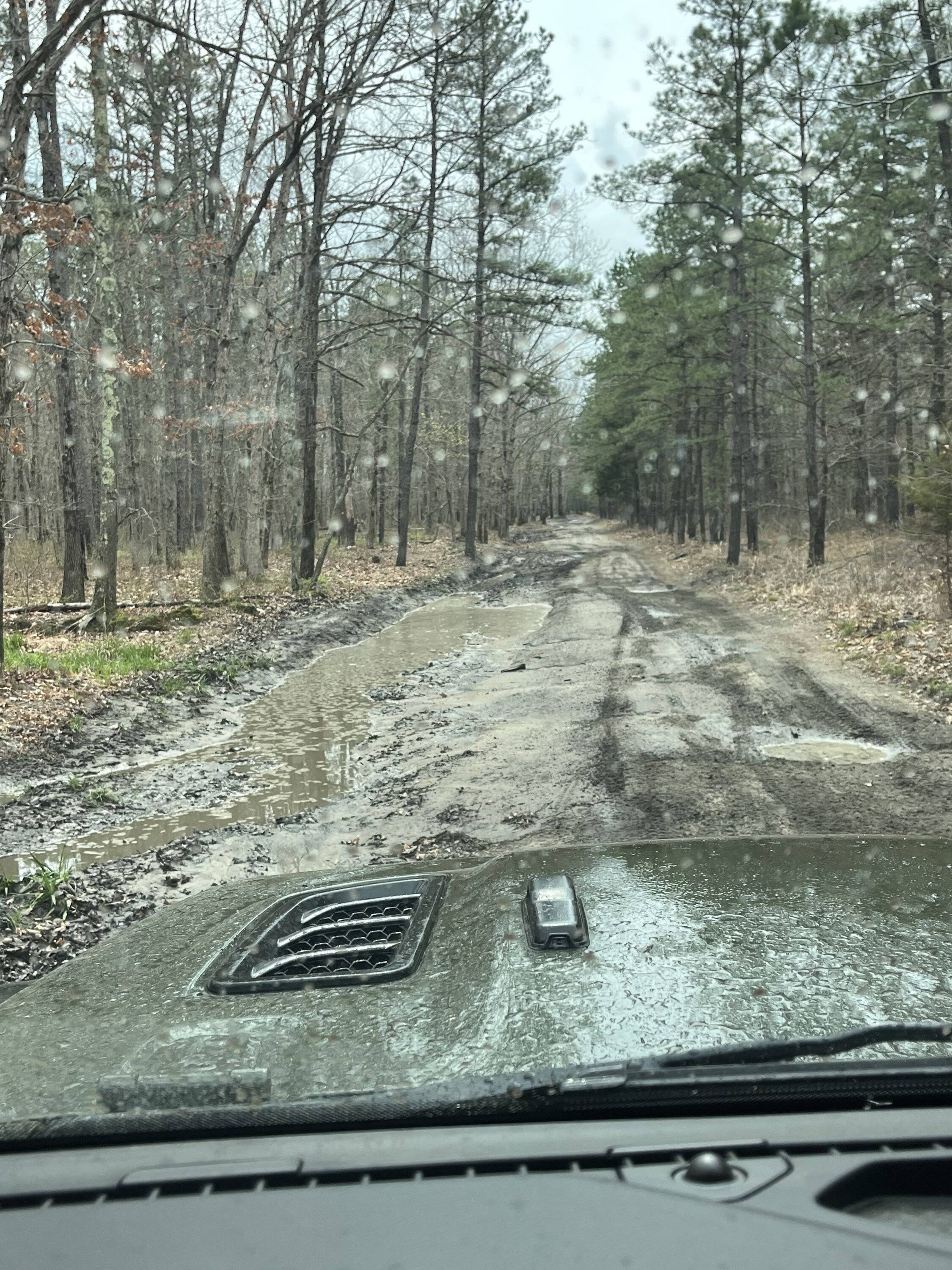

lol it was a joke, I edited it, although I do still find the instructions super unclear. They don’t make sense it says to release the accelerator after the shift has been completed then immediately days do not accelerate while shifting. Maybe I’m just too literal of a person.
anyway, when ripping through some Army deuce and a half monster puddles without issue. Back and forth to work the shifter in.
