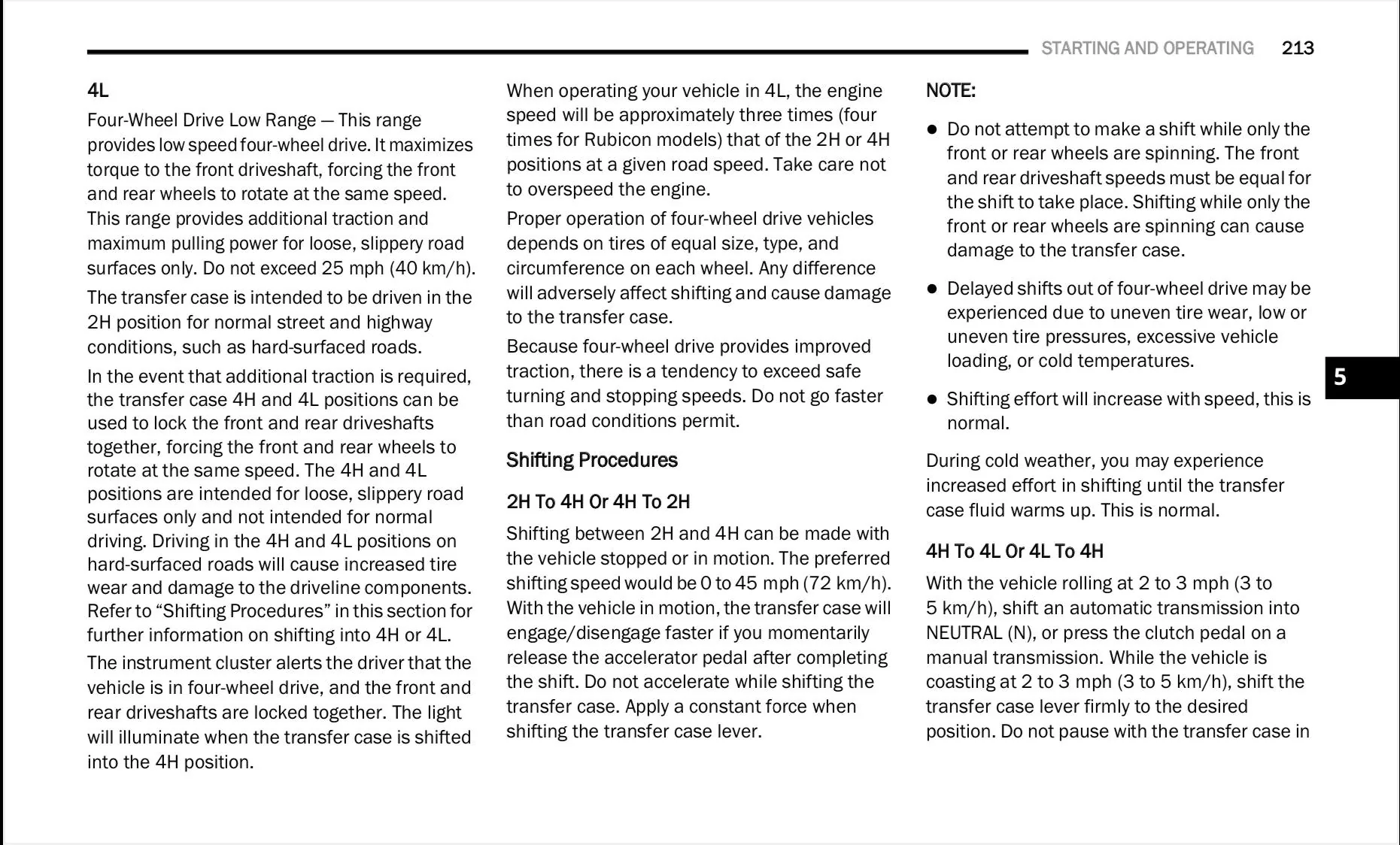

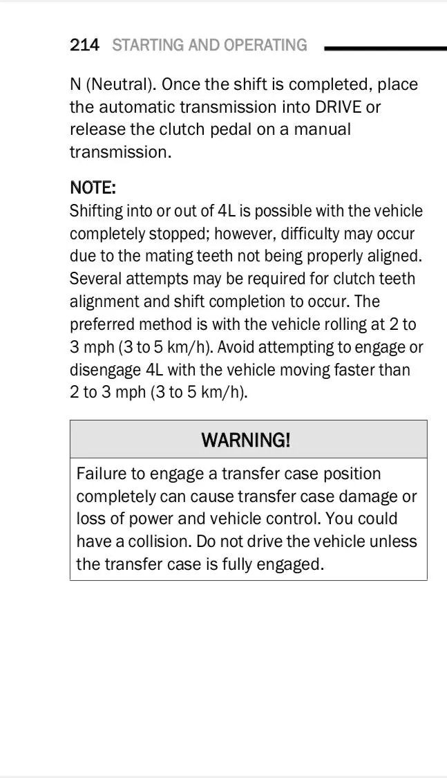

Many good points. I have found that mine shifts a lot easier after a year of use. Cold weather can make it a little harder too. Owners manual info below for the good of the order.
Jeep Gladiator Does 4WD shifting get easier? 6358034B-27CF-4EA1-990C-A683A73B4BCE
Jeep Gladiator Does 4WD shifting get easier? 105E8D85-60C7-4435-842B-2DC3E414C118
