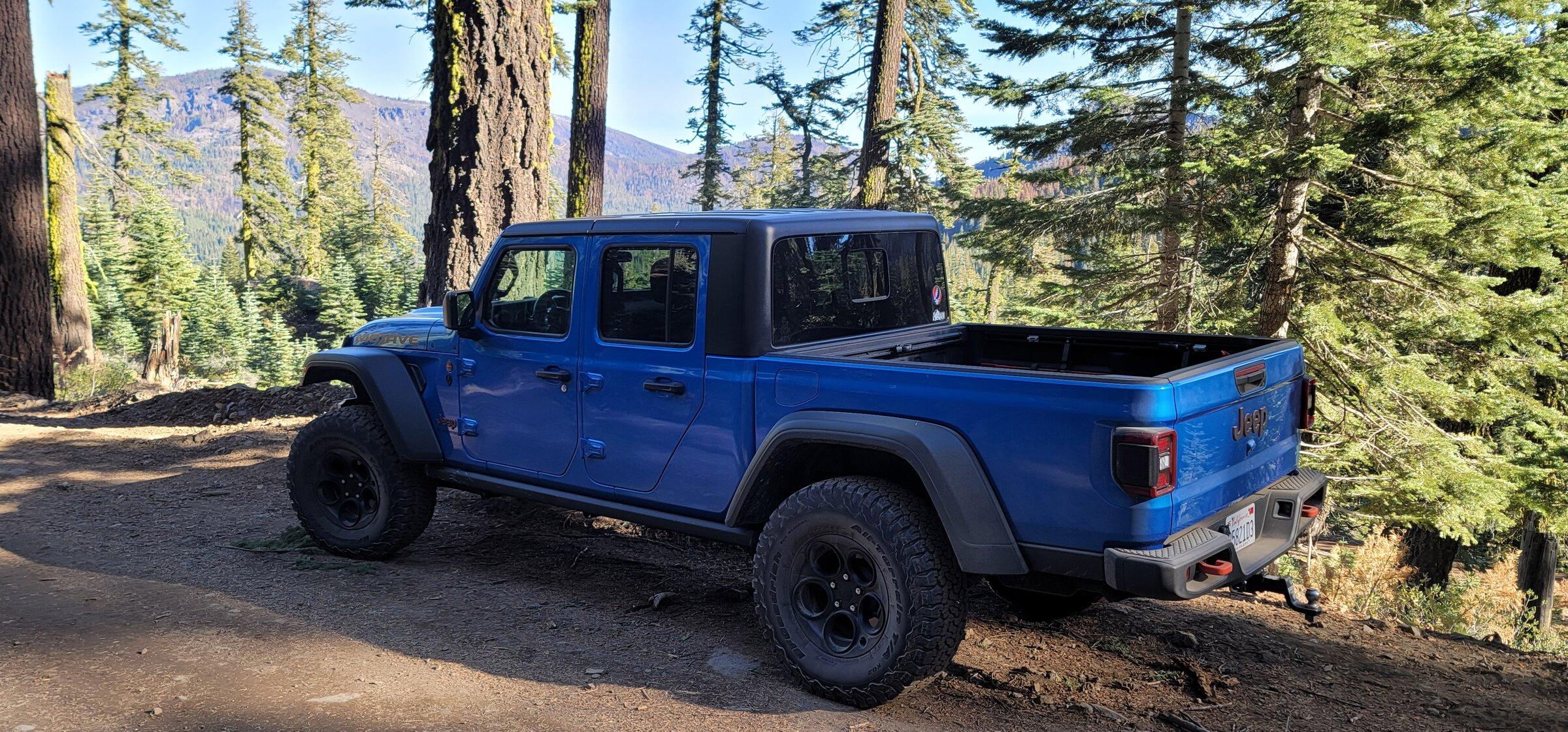

AEV 2” is economical in my opinion. It uses spring spacers and shock extensions so none of the original suspension components are lost. Either add the geometry correction brackets or buy the lca’s that are longer from mopar to bring the geometry to spec. I love mine. Drives as good or better than stock. I went with 35s but 37s are coming.

Oh yeah, the kit was $450 and the Geo correction brackets were $300.
