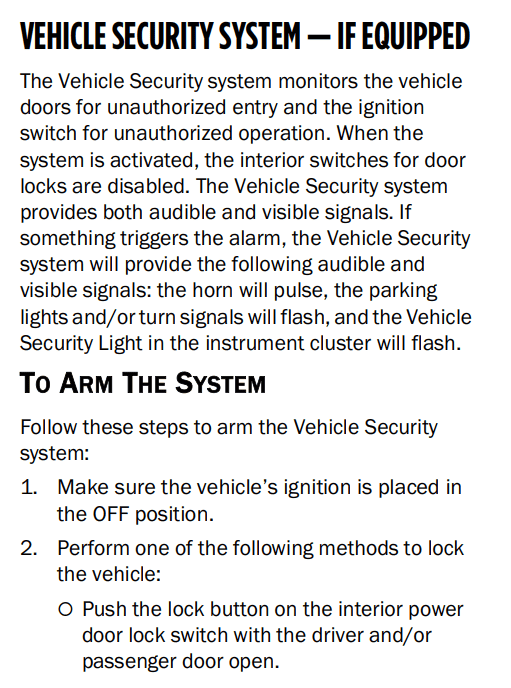

I asked if the security alarm came as standard equipment on all Overlands in my previous post. Hootbro answered that all but the base Sport came with an alarm.I have tried many different ways to set the alarm via the owners manual with no success. So is the security alarm a standard feature on all Gladiators or is it an option included in one of the option packages?

My Sport had an alarm, I believe. Do you get a flashing light on your dash when you lock the vehicle?
249
40,519
54,123
I believe it is activated via a Tazer.
No, just the hood alarm is, or using jscan or AlfaOBD.
Otherwise, the alarm is supposed set when you lock the vehicle.
There's security system ("alarm"), then there's hood alarm.

Roll down your window. Arm the truck, wait a few second then reach in and manually unlock the door then open it. Alarm should comes on.
Edit: Make sure your fob is not near the truck.

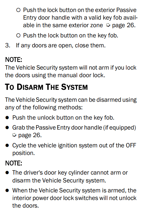

Vehicle Security System- If Equipped that's what it states in the owners manual. Does this mean it is not in every Gladiator as standard equipment? That is my question.
Mr._Bill
Jul 22, 2019
6,668
7,812
North Las Vegas, NV
That's lawyer wording so they don't need a manual for each trim level. It prevents claims that a vehicle is missing something the manual says should be there.
A base Sport model with manual door locks might not be equipped with an alarm. In over four years, I have not seen any posts here about a missing alarm.
249
40,519
54,123
Manual locks won't have that system - lock cylinders won't trigger it and anything with power locks have a power switch inside, not a manual lever.
So logic dictates - only something with power locks could have this system.
