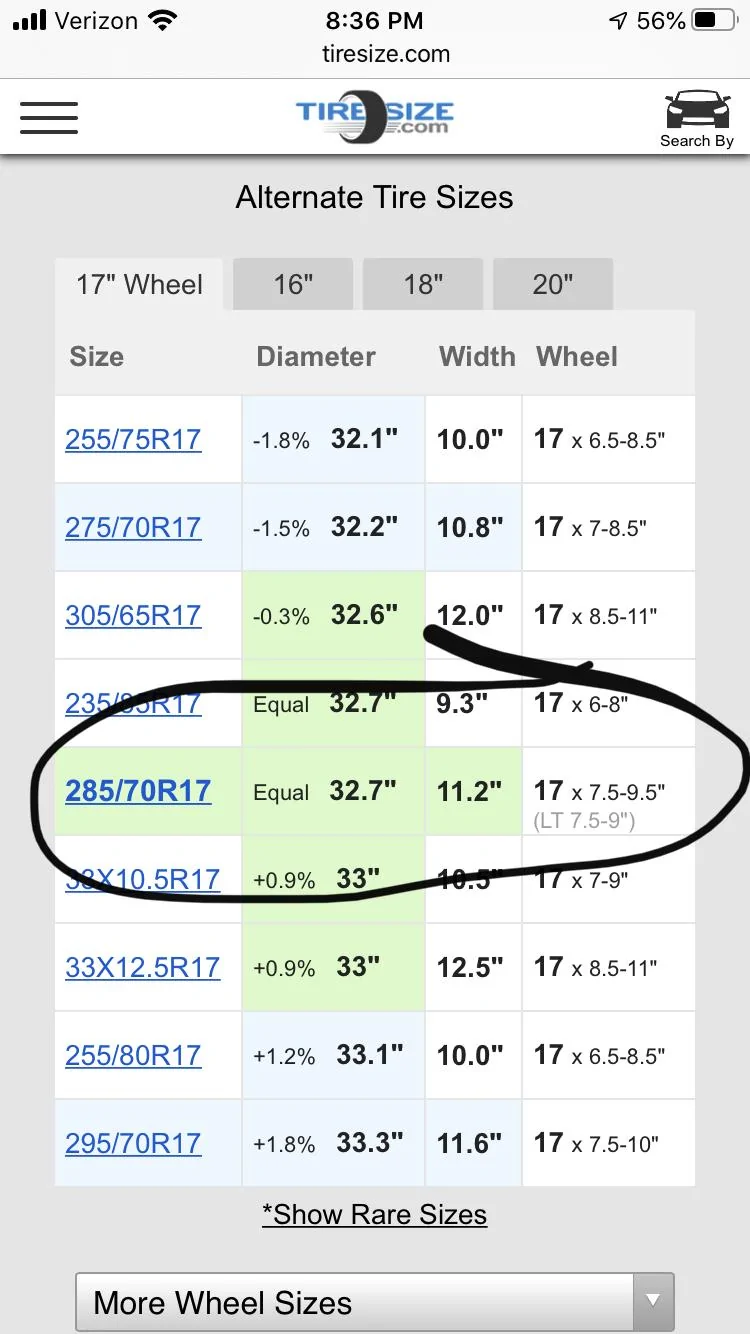

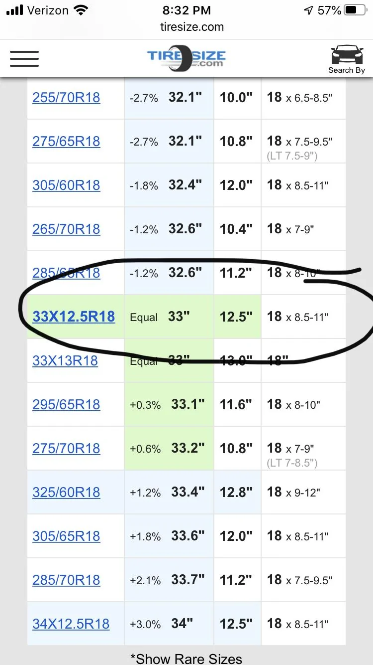

I was always told that the 12.5 was too wide for stock rims and will make you prone to blowing a beed with normal driving
Pic shows that 33’s may work for you, i just dont know the stock rin width

I went with 285/70/17 since they were close to 33 and fit easily on stock rubi rims
Jeep Gladiator Question For You Tire Guys 8FDD95A4-453F-46C0-88C1-7597216484F5
False. Thousands of people run 12.50’s on stock rims without issues.

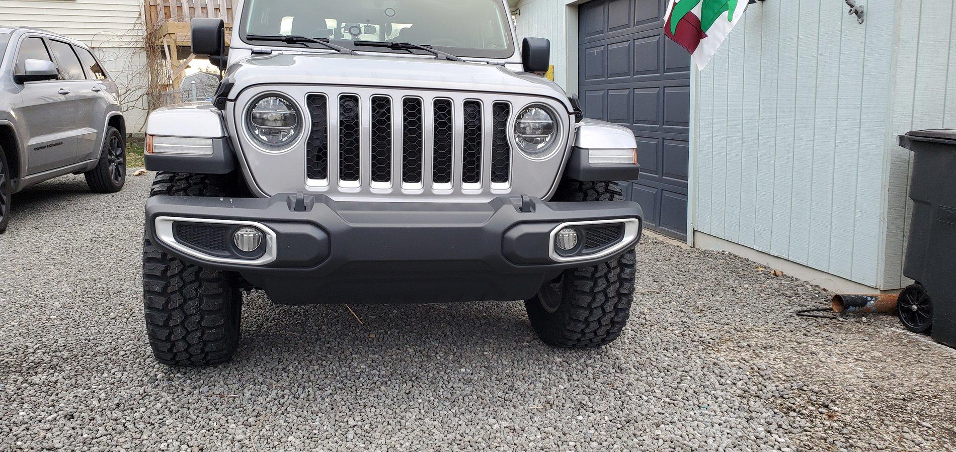

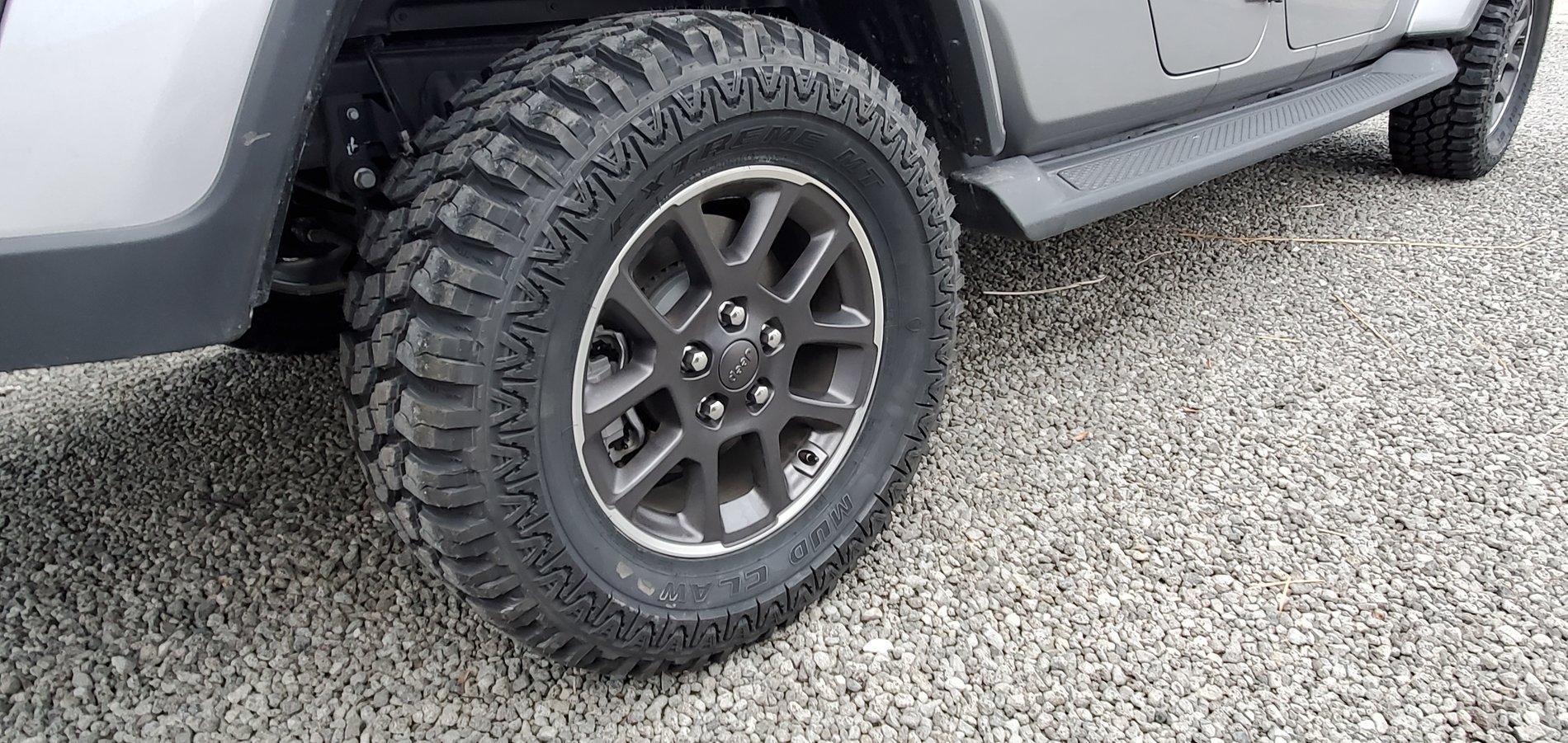

I decided to go with the 33/12.5 R18....I'm very happy with the look, feel and driveability....I've got some 1.5" spacers to put on, but I really don't know if I'll use them...these feel so nice on the road.... :)
Jeep Gladiator Question For You Tire Guys 20200214_171341
Jeep Gladiator Question For You Tire Guys 20200214_171356
I'm new to forums, so I'm not sure if you'll see this or if this is the appropriate place to ask but I'm interested in doing the same thing as you. If you don't mind me asking which brand of tires are these? Also, any issues since? They look great!
These look great!!! With no spacer and no lift, did you have any rubs in the front, lock to lock?
also would like to know, any run on lock to lock?
