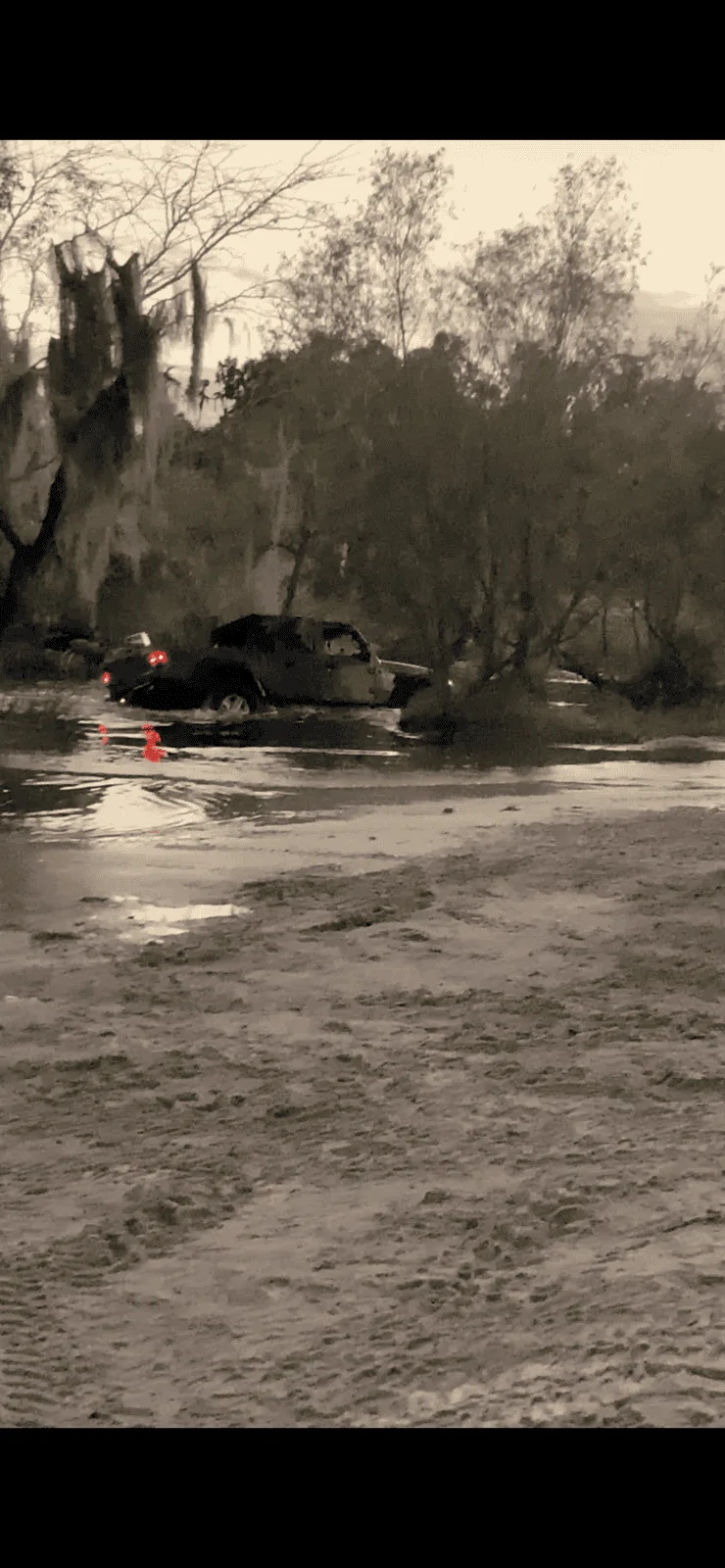

Someone out on trails driving through Peace River this past weekend. He wanted me to follow him but I'm not as brave with a brand new truck. I have a video but I don't know how to post it.

You really made a splash with your first thread!
(I’m a dad. I’m required to make lame jokes.)
As a dad, I approve of this joke.
