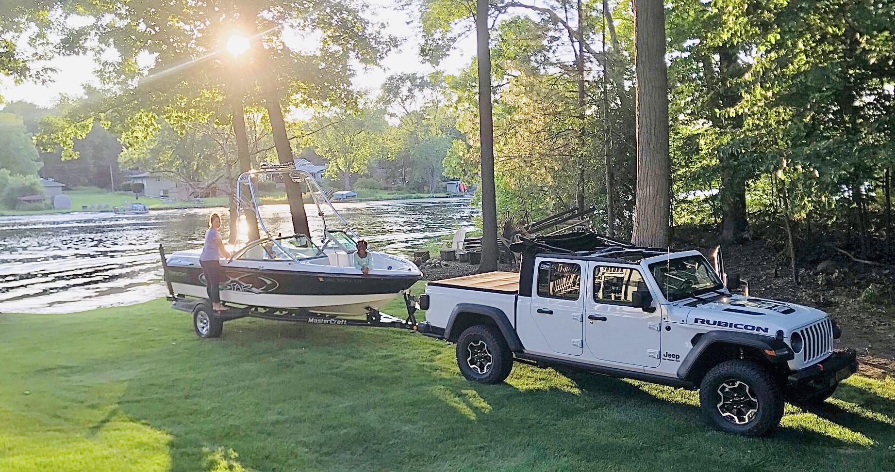

Ive been pleased with the towing of my JTRD:
Have towed 6 different trailers weighing 800-4500#
2hr trips were the longest.
Towing will cut the mileage from 24 down to 18mpg.
Wind resistance on large campers and rag top back cuts fuel economy.
Plenty of power to go 85mph / pass on hills where needed.
Never smelled any diesel scent other than at the fuel station.
