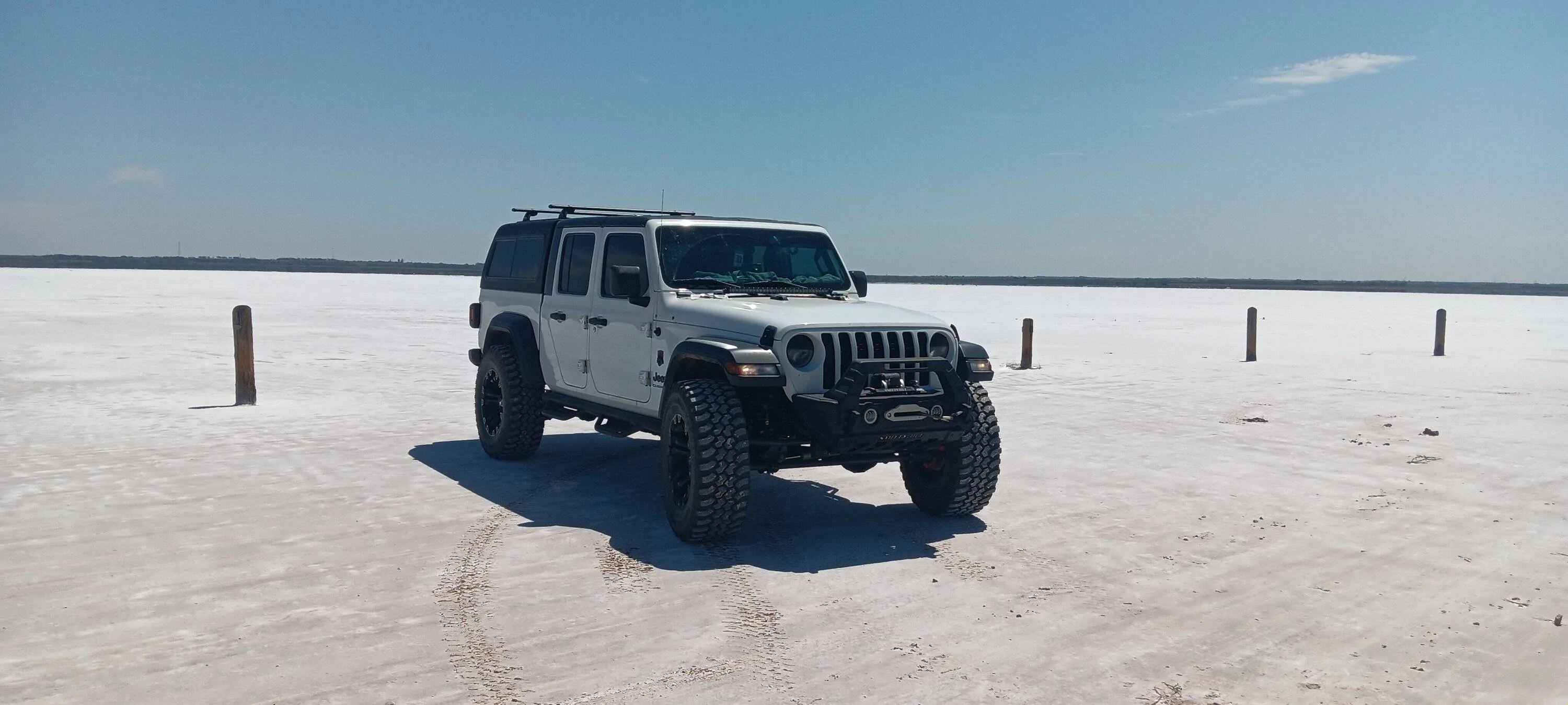

@Judd You have probably already considered this, but the real problem with all of the roof racks you've linked to is that they mount to the gutter, which is not a real load bearing place to attach to. I realize that you say the rack will only hold a solar panel, but load is load and stress on those gutters will always be there risking damaging those gutters.
Personally, I went a different way:
Jeep Gladiator Rack options 14_NewSolarPlatform_6
These are the prices I paid 2 years ago:
  • Rhino Rack Backbone system $664
  • Rhino Pioneer Platform 48"x56" $865 (there are a multitude of dimension options for the platforms)
  • Rhino RCL Locking Leg (Set of 4) $200
I know this is steeper than the budget you cited in your original post but the real difference here is that the Rhino Backbone is mounted through the roof and into the roll cage (sport cage). Which means that you have much more stability and load carrying capability.
Personally, I believe in things having dual or triple function; so while I could have gotten away with a less expensive, gutter mounting option to hold just the solar panels, I now have a rooftop platform that I could also carry extra gear on if/when needed that I won't have to worry about overloading.
Again, I realize this option is more than you were asking for, but it's good to know the options you do have available to you and this one might help to "future-proof" needs that might arise (like needing more storage capability while in transit). And yes, I can take off the Freedom panels.
