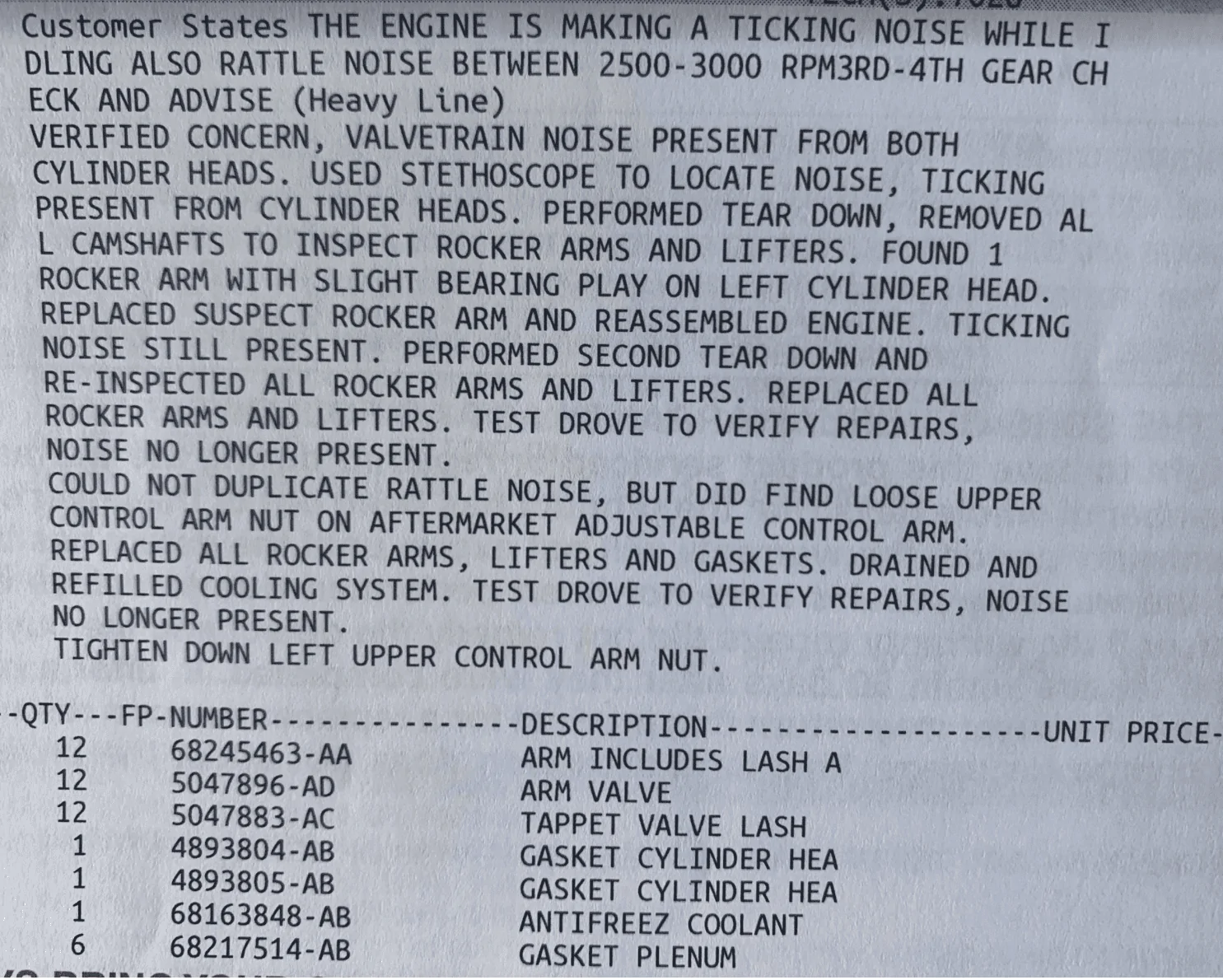

I got the truck back and here is the notes from the dealer:
Jeep Gladiator Rattle from engine when accelerating (sounds like keys) 1629319470164
They were able to fix the engine ticking noise and its driving great.. BUT I was able to get that damn rattle noise to trigger again. (Low gear & low speed) Its not as easy to make it happen though and Its not happening while driving normal. for now at least..
To be continued!
To be continued!
Just drive it, trade it in or sell it before the 60k warranty ends or get an extended warranty. Drive it, and drive it hard since these engine were made to operate in the mid to high rpm ranges. Most likely the noise will get worse if there is an issue with the engine within the warranty period. I realized you'll never be able to enjoy the jeep if you're constantly worried about it. Run it on 87, keep oil change records and drive. It could be a lot worse like the misfire issue where you cant even drive it, I'll take the detonation over that issue any day.

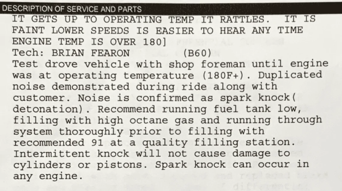

Update on mine:
Dealer just called and said there was a star case regarding the 'transfer case cable rattling' and that might be the cause of this. <insert eyeroll here>. Does anyone have star case numbers for their gladiators that more directly address this problem that you would share and I can direct the techs to?

Update on mine:
Thanks!
While the dealer was inspecting my transfer case cables, they acknowledged that it is spark knock, and explained on the invoice that I should run 91 (it had 91 in it while they had the jeep today). I spoke to the tech foreman, and he seemed quite unbothered by this and explained that all these engines rattle, and he can 'get any of them to do it, even the hemi engines (he) works on'.
Jeep Gladiator Rattle from engine when accelerating (sounds like keys) 1629930710284
I provided an anecdote that I ran 92-ethanol-free in it this passed weekend and it helped reduce the loudness of the knock but didn't get rid of it- again unbothered. Also, that the knock sensors wont trigger a code unless the knock is so bad that the cam phasers cannot adjust to alleviate it- and that they take longer to adjust than I might think.
All indication is that this is normal- and I shouldn't be so worried, so I'm gonna try that for a while I think, then drop a 392 in it.
