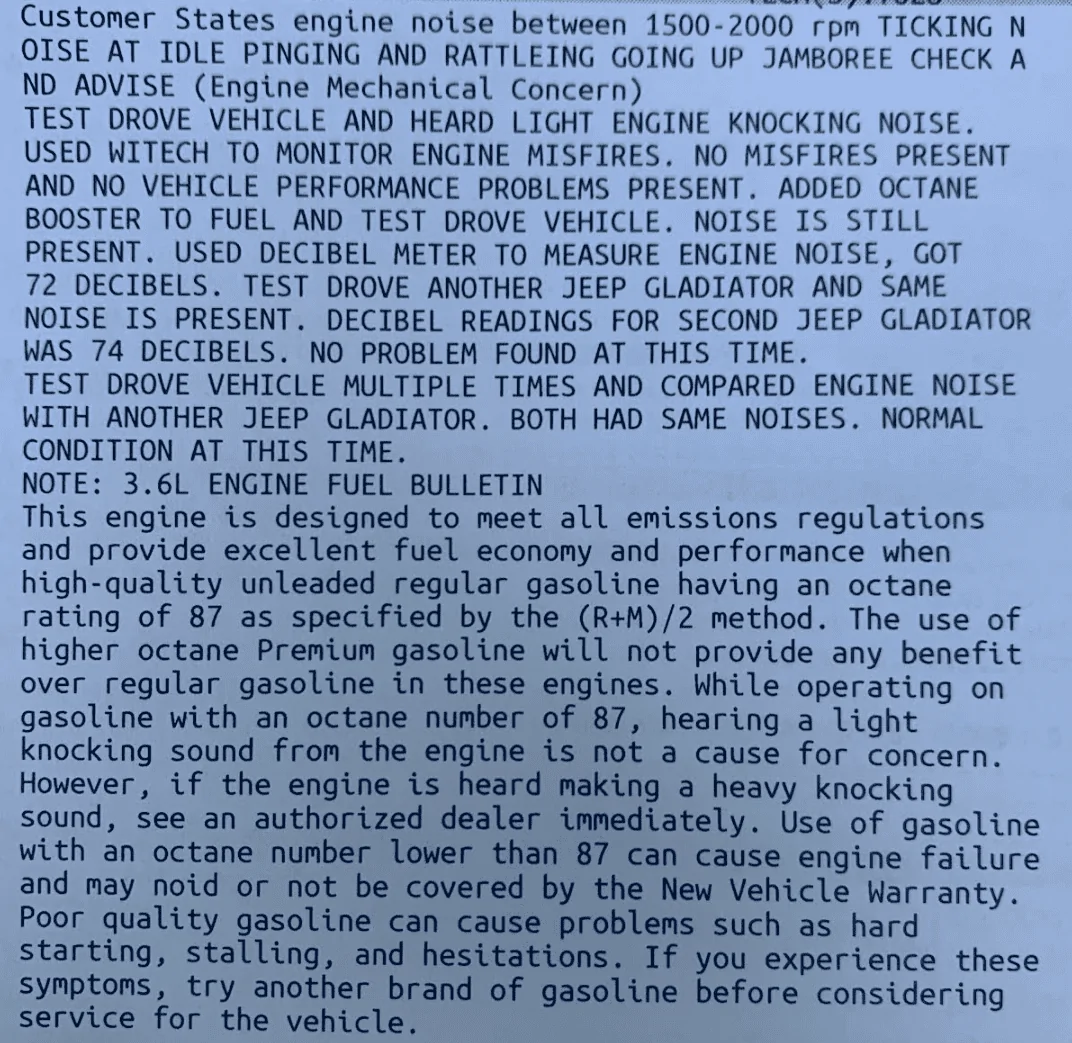

Just got my truck back again, here are the details from this specific noise:
Jeep Gladiator Rattle from engine when accelerating (sounds like keys) 1632260147612
Will be exploring this decibel test a bit more. I would like to see what other gladiators (Other than mine and the one they drove to replicate the issue) read out to be.
