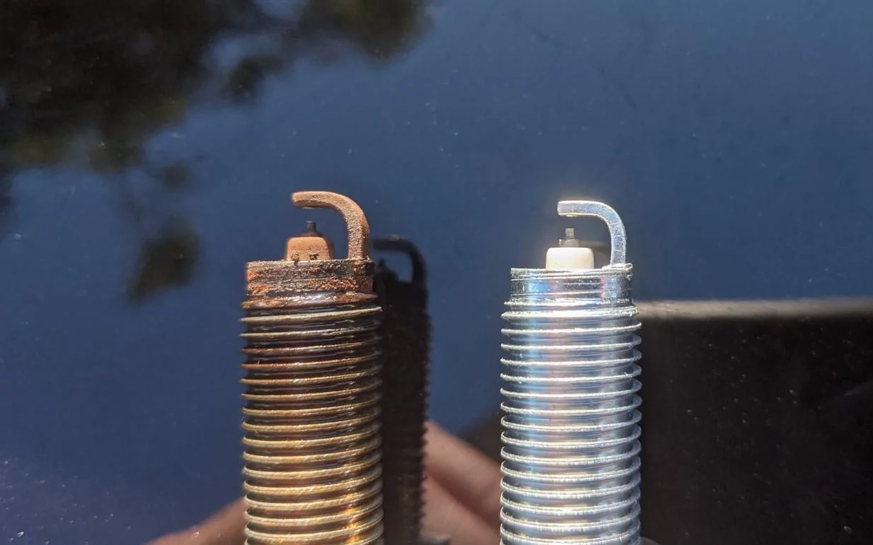

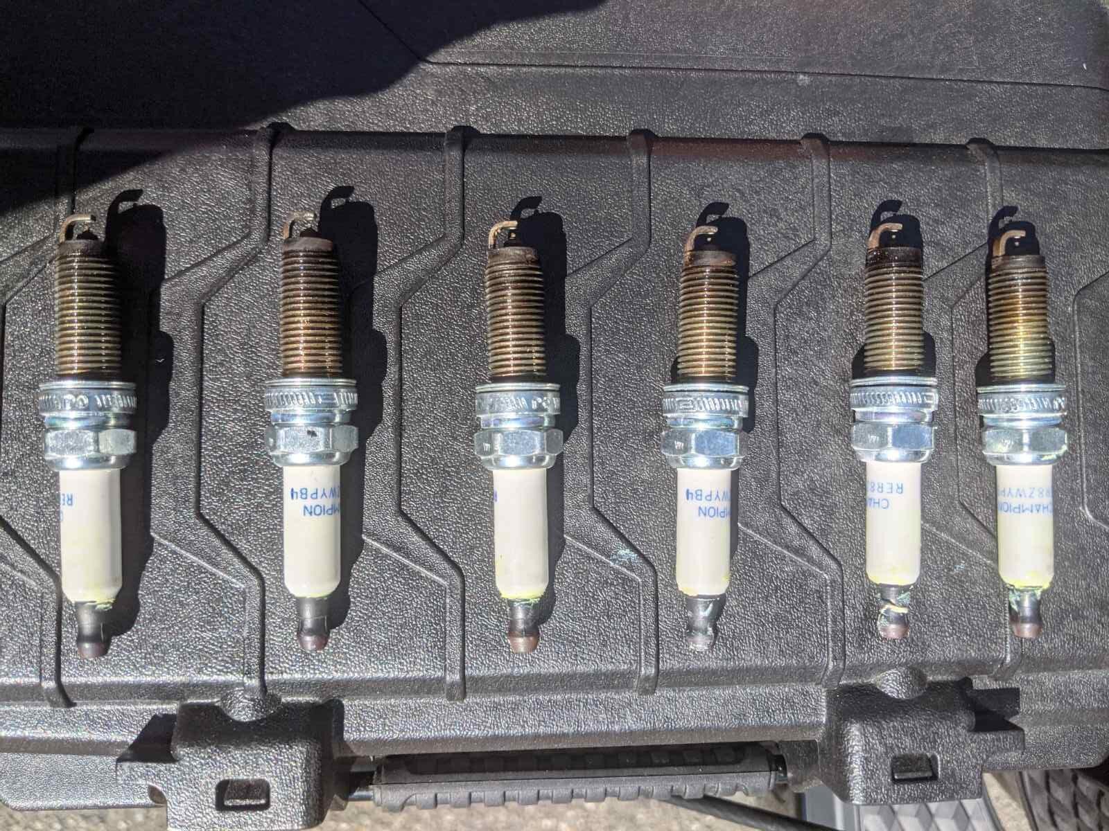

Okay Gang, a long update:
I spent some time this weekend after gathering parts and materials for a few weeks, and tried to attack this problem with solutions I thought were applicable. I'll try and keep it concise, but I wanted to share a few things I observed along the way, as well as just some general understanding of what I believe the issue to be- maybe it will be helpful, maybe not, maybe it will spark some additional ideas.
TL:DR, I did a bunch of stuff with no positive affect on the rattle/knock, at the very least we can mark these things off in our elimination process.
1.) Replaced Park Plugs
I learned per the TSB posted earlier (thanks @Hootbro ) that my gladiator has potentially damaged spark plugs from the factory, so I thought I would take this on first. I cannot understate how unreasonably complicated this process is, and a total PITA. Just here to validate what others have said about the topic.
After installing the new spark plugs (I just used new OEM ones), I noticed my engine ran notably smoother than before. There was a slightly rough idle (and I mean very slight) that I had noticed for some time. I had also noticed and reported to my dealer a very slight (emphasis) stuttering when accelerating at low speed or at highway speed. This at least, is resolved by replacing the spark plugs. Power delivery is much more consistent and idle is perfect, almost can't tell its running. This is how I remember it the day I picked it up. I realize I am running the hazard of placebo affect here, but I'm gonna stick to this, I think it was an improvement.
Old Spark Plugs:
Jeep Gladiator Rattle from engine when accelerating (sounds like keys) sparks 1
Jeep Gladiator Rattle from engine when accelerating (sounds like keys) sparks 2

While swapping the spark plugs, when I finally got the upper intake plenum removed, I had it propped up to one side of the engine bay, and I noticed almost immediately it started leaking oil through the front of the throttle body. To much oil in my opinion. It dripped out about enough to fill a shot glass. Of course this probably wont surprise some of you, as the engine recirculates whatever the block vents to the intake plenum.
  • I've used the dealership for oil changes so far, I don't really know what type of oil they are using, assuming spec weight- but I don't know at what temperature its rated to 'evaporate' or otherwise become aerated and get exhausted to the intake plenum. This, combined with the fact that they consistently put 6 quarts in, when 5 are specified (I've reminded them twice). I wonder if this has some affect on what is vented. More oil, more material in vent to plenum. I just cant know.
  • Also while swapping the spark plugs, I noticed that they were coming out, I'll call it 'wet', with a little oil on them. If it is oil, this supports the idea that whatever is venting to the intake plenum is making its way to the combustion chamber.
  • It would seem, that the oil vented to the intake plenum is becoming an additional combustible material, causing either detonation, or pre-ignition. The oil lowers the octane of the air/fuel mixture being burned, and might cause the knock. I mention octane, because if I run 87 fuel, the rattle is louder and prolonged. I regularly put in 92, and the rattle stays within its original RPM and speed range. I was also able to notice over the course of a week, that after a cold start, I can drive until the engine exceeds 176 degrees (obviously this is a a range, who knows if the cluster gauge is actually accurate) without the rattle, above about 176 degrees it will rattle as expected.
I wasn't able to clean out the oil from the intake plenum, I just let as much drip out as I could, with the throttle body closed. I'm sure there was still some in there. I drove about 132 miles total after doing all this work, hoping that it would blow out and burn any remaining oil in the plenum and whatever is now being vented would get caught by the catch can.
