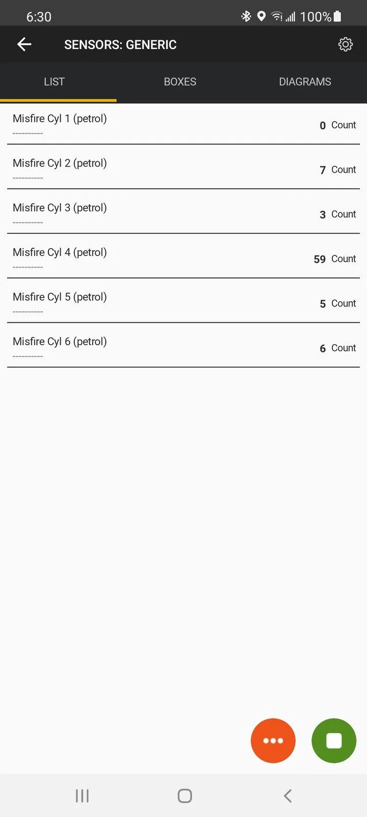

Reason I ask is that have a random P0304 #4 misfire code that is pending but never posting the MIL. Found it when I was getting an occasional ESS not available lamp icon posting.
Only seems to happen on a 8 hour+ sitting cold start. Checked it with JScan I would have a misfire count on #4 of 30 to 50 something. Seems anything about a 50+ count will trip the pending P0304. Misfire count on #4 seems to smooth out within 10 seconds or so after starting and is fine for the rest of my drive. Subsequent hot starts and no issue.
I am pretty sure the #4 cylinder is on the drivers left bank and the intake covers the coil, plugs and injectors on that side. Otherwise, I would done some swaptronics on all three to see if it traveled.
Spark Plugs are a 100K mile change interval but seriously debating doing it shortly when I hit 30K miles. Just do not want to deal with the dealership bufoonery since a hard MIL code is not posting and the pending P0304 code resets after a couple ignition cycles to only happen again a week or two later.
I am pretty sure the #4 cylinder is on the drives left bank and the intake covers the coil, plugs and injectors on that side. Otherwise, I would done some swaptronics on all three to see if it traveled.
Yes, they changed the spark plugs (and where those are makes me glad I'm retired) and the thing has been perfect since.
Note that my diagnostics specifically said "ignition". I need to see if I can find a copy of that TSB to see just how it reads.
WEIRD, not even a thousand miles - and spark plug causing a misfire. I'd love to know the difference between what it came with and what they put in - same exact number? Same heat range?
2021/01/04 11:56:32.011: Faults found: P0303
2021/01/04 11:56:35.970: Faults found: P0303
Error code: P0303
Cylinder 3 ignition failures
Test not complete
Error intermittent
Error warning lamp not requested
Error code: P0303
Test not complete
Error intermittent
Attached is the 09-013-20 REV. A TSB for the Spark Plugs. It was a bitch to get as it was not on the interwebs anywhere. Had to go to Tech Authority and pull it up there. Does not seem to be assigned by VIN to anything I tried to input. They seem to really want this one buried.
What is interesting is they list other 2020-2021 models as being affected but only 2021 for the Gladiator and Wrangler. Then the build on and after and before info is contradictory. I think this has been an issue with bad crack spark plugs on the Gladiator from the get go of the 2020 model year even with the early 2019 build date models.
Seems the MOPAR OEM spark plugs are made by Champion and that would explain a lot with the crappy quality.
