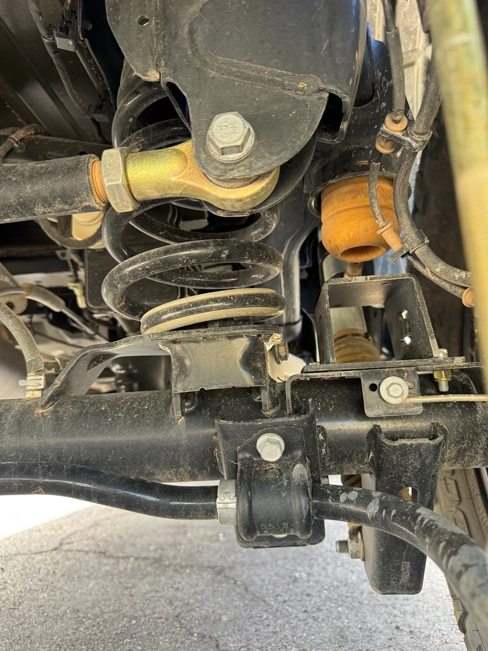

I bought a knock-off gopro and mounted it underneath and took video driving up my driveway:
Video 1
Video 2
You can hear the thunk, but I can't pinpoint it. In the video I have completely removed the D-Ring hitch to rule that out.

The only thing that stands out to me is that the instructions for my lift called for the isolator sleeves from the factory springs be transferred to the new, and it appears you have none.
DirkPiggler
Dec 5, 2025
Memphis
2023 JTR, 2023 Mustang Mach E, 2025 Rivian R1S
Makes perfect sense. Could you point me to a set online? All I'm finding are for wranglers and I don't know if they're compatible
WhereInTarnation
Roger
Nov 10, 2025
RV
2025 Gladiator, 2022 Chevrolet 3500DRW
IT Geek
Wrangler should be compatible as should 1500 Ram. Heck, I’ve seen split rubber hose used. It’s to stop the rattle between spring and perch. Mine for comparison:
Jeep Gladiator Rattle in rear when going over bumps with both rear wheels IMG_0995
