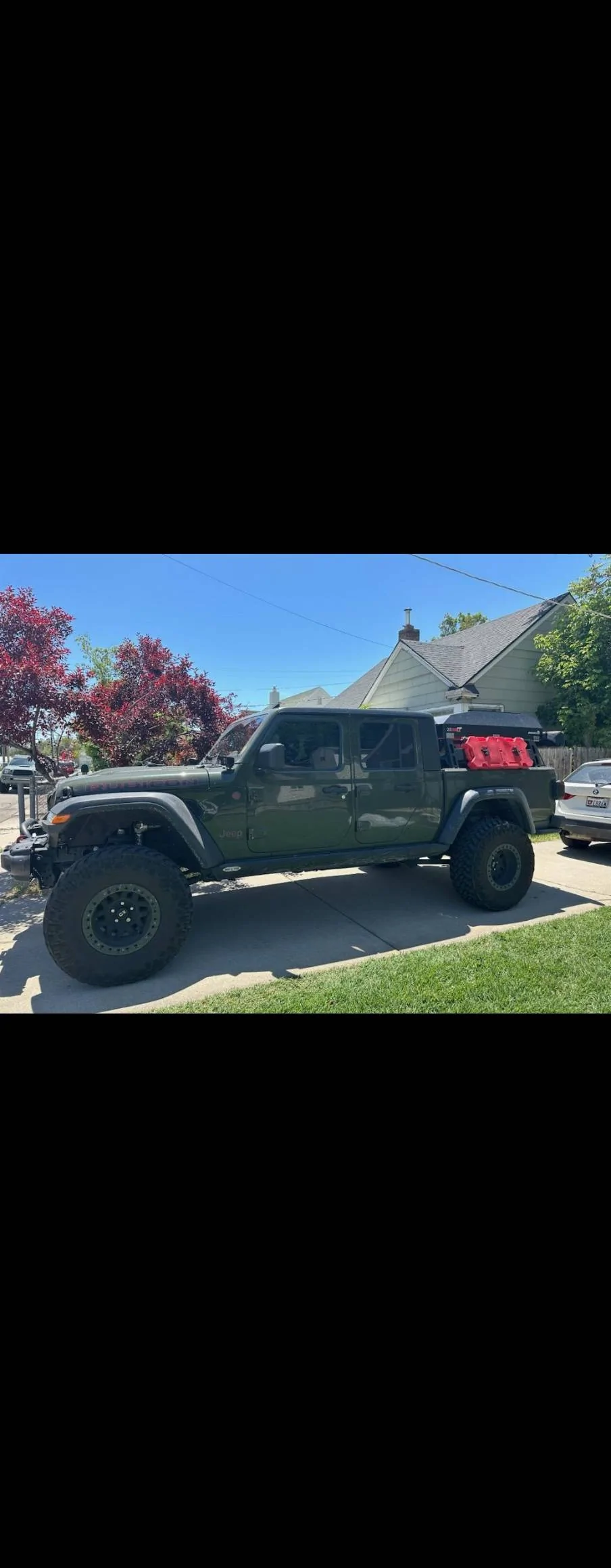

Hello gentleman!
I have a 3.0 eco. Currently rocking 3.5" clayton lift with 37s. (38s on order). I wanted to beef up my axles for peace of mind. I'm stuck between 2 piece and 1 piece from rcv. From all my research I'm 80% learning towards the 1 piece. My hang up is- I am scared of possibly having vibration or ruining the highway/daily driving experience. I drive my truck 25k miles a year. Heavy trails towing ect. Can I hear some opinions on 2 piece vs 1 piece or first hand experience. I plan on sticking with 38s for a while and won't ever go above 40s.
For reference I currently have
3.5 lift clayon
Kmc machettes
King bump stops
Falcon tie rod
Falcon 3.5 adapt
Rock jock and synergy steering/chasis
Falcon drag link 2.1
Artec inner fender
Rse sliders
Artec f/r axle truss (on order)
Fender chop (on order)
Apex boost box (on order)
Yukon rear axles (on order)
