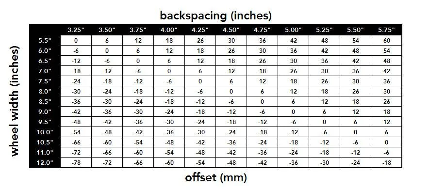

Less back space is going to make it fit even worse you need more back spacing not less. The portion the bolts to the hub is always going to be the same distance from the rotor and the brake caliper . What your saying does not compute. More back space negative -12 is about 4.50 ....-13 is 4.75 of backspace. Which puts the dish further away from the tie rods , frame, this keep the tire from rubbing the sway bar end links etc..
If I was you I would go back and read up on wether they say that 3.75 or whatever Back spacing is the minimum in my brain 5.72 makes your tire stick way out
From the TeraFlex site:
Specs:
• Minimum Wheel Diameter: 17”
• Back Spacing: 4.75” or less
• MUST VERIFY FITMENT W/ DOWNLOADABLE TEMPLATE
• Bolt Pattern: 5x5” Stock Brake Rotor Reference:
• JL Sahara/Rubicon front: 12.9” x 1.1” (330mm x 28mm) vented rotors
• JL Sahara/Rubicon rear: 13.4” x 0.55” (342mm x 14mm) solid rotors
• JL Sport front: 12.9” x 0.94” (330mm x 24mm) vented rotors
• JL Sport rear: 12.9” x 0.47” (328mm x 12mm) solid rotors
• JT front: 12.9” x 1.1” (330mm x 28mm) vented rotors
• JT rear: 13.6” x 0.86” (345mm x 22mm) solid rotors
• JK front and rear: 11.9” x 1.1” (302mm x 28mm) vented rotors (U.S.-spec)
Am I reading this wrong???

Borah wheel specs:
Tech Specs:
Manufacturing Process: Cast
Material: Aluminum
Coatings: Paint, Primer
Size: 17" x 8.5"
Weight: 33 lbs
Bolt Pattern: 5x5
Hub Bore Diameter: 71.5mm
Offset: +25mm
Approximate Backspacing: 5.72"
Weight Rating: 2,400lbs

Example 1: +25 mm offset = The center of the wheel is 25 mm closer to the outside, or curbside, of the wheel. (+) offset pushes the wheel farther into the caliper/brake
12,235
32,580
You have it backwards. A 5.72" backspacing makes the wheel sit more inboard. A 4.5" backspacing sticks out more.
Yes that's what I been saying the part that the lugs mount to is further to the curb side of the rim with a +25 .which makes the rest of the rim stick under the fender towards the frame.
-12 has 1 mm more backspacing than -13 if all other specs are the same. Not less.

SO-
Are we good on the back spacing thing???
