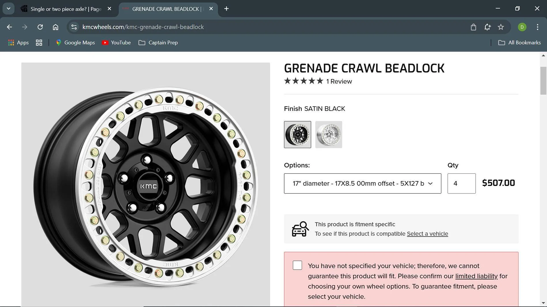

I hit a similar snag with my RK long arm kit. I'm running a hubcentric 1.5" spacer for now. Exploring other wheel options for the long term. 17x9 with 4.5" BS seems to be the most common wheel spec in a beadlock. I found one KMC wheel 17x8.5 w/ 4.75 BS
A thought regarding the brakes is going to a better pad/rotor/steel brake lines. It will improve your braking while being able to maintain a stock caliper. May not be the answer your looking for though.
Jeep Gladiator Single or two piece axle? Screenshot (41)
I'm not changing wheels, I just bolted these on last month, so there's that.
Regarding the brakes, I think I'll look at the setup you are running. Maybe that would solve for the overheating issues I have experienced. Aside from that the 1.5" spacers could also work.
