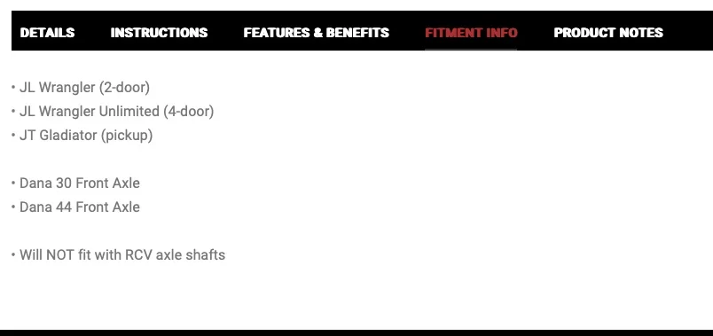

ordered the synergy ball joints. they state the ball joints work with the RCV shafts.

The Teraflex ones don't work with the Dana/Spicer Advantek axle shaft upgrades either.
You should be fine with the Synergy ones.

Heather McAnally at [email protected] . Said they were going to fix their web site last month to address this issue.
I tried posting a comments on their YT videos to warn folks these ball joints do not work with RCV and 1410 U joints. But they took them down.
