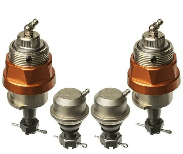

I installed my teraflex lower bjs 180° from the instructions to clear RCVs, but my RCVs are not going to be here for awhile so I installed the factory shafts for now... this required me to grease the joints, then remove the zerks and installed 1/4-20 set screws in their place. I also had to file down the top of the hump where the rearward zerks install. Not too big of a deal, but thought I would share my solution to my problem.

I took out the Teraflex ball joints and put in a set of Dynatrac…you def get what you pay for. Very, very well made. I should’ve gone with them to begin with but you live and you learn.
Teraflex should’ve put a disclaimer or remove the statement that they work with RCVs from the site (It’s a few lines of code that need to be removed or added, nothing big) instead of trying to blame RCV. I reached out to RCV and they confirmed nothing has changed to the boot diameter or thickness. I’ve had a few issues with Teraflex products in the past but this is the last time I use their products. Again not knocking the ball joints the seem well made. Just tired of Teraflex in general.

I installed them with the lower zerks facing out, to accommodate the rcvs. Removed the zerks after greasing and installed set screws to keep debris out. Slight filing was required as well, but nothing major. Factory shafts work no problem after that.

So yeah @TeraFlex you should put a disclaimer somewhere on your site that your HD ball joints don’t play nice with RCVs…
The tops of the ball joints are eating away at the RCV and there is zero room to grease them too.
