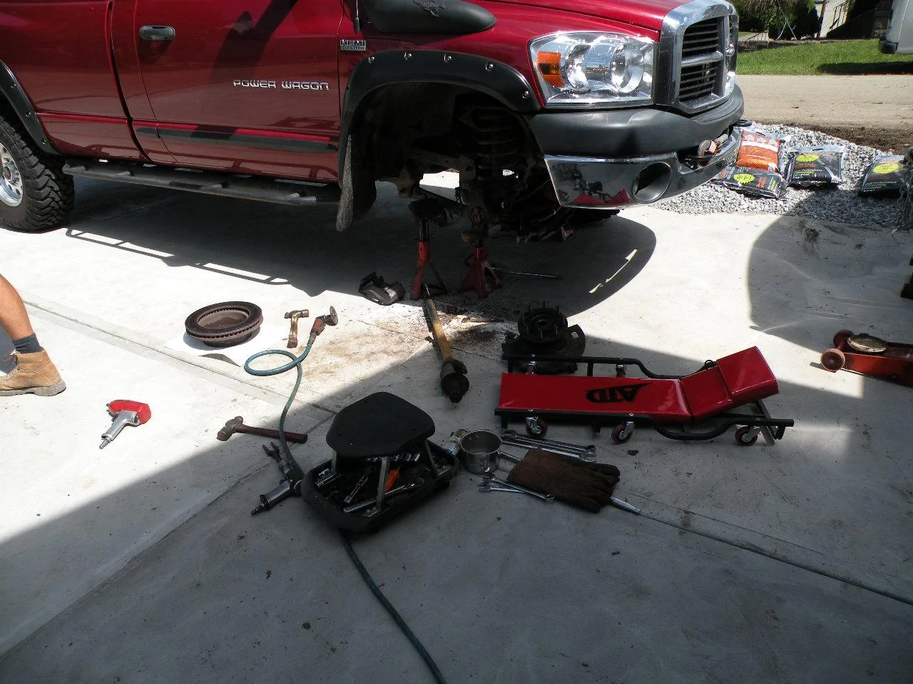

Where were you when I did this? Carli ball joints, RCV axles and Dynatrac freespin hubs. i would have bought you 10 pizza's and a keg of beer. The unit bearings were frozen in both knuckles. Had to cut the ball joints to get the knuckles off. Then use a BMF hammer and beat the unit bearings out from behind.
