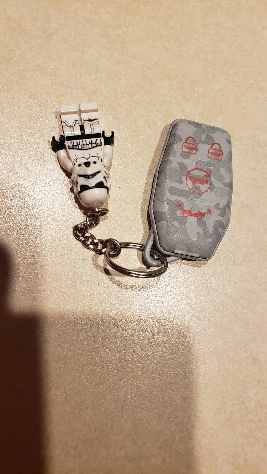

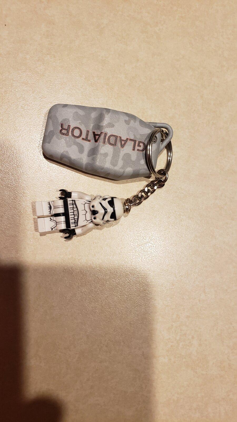

Y'all made me have to go check my own mailbox! To my surprise mine was in as well. Shipping said it would be here Wednesday. Oh happy day. Thanks @carldouglass!

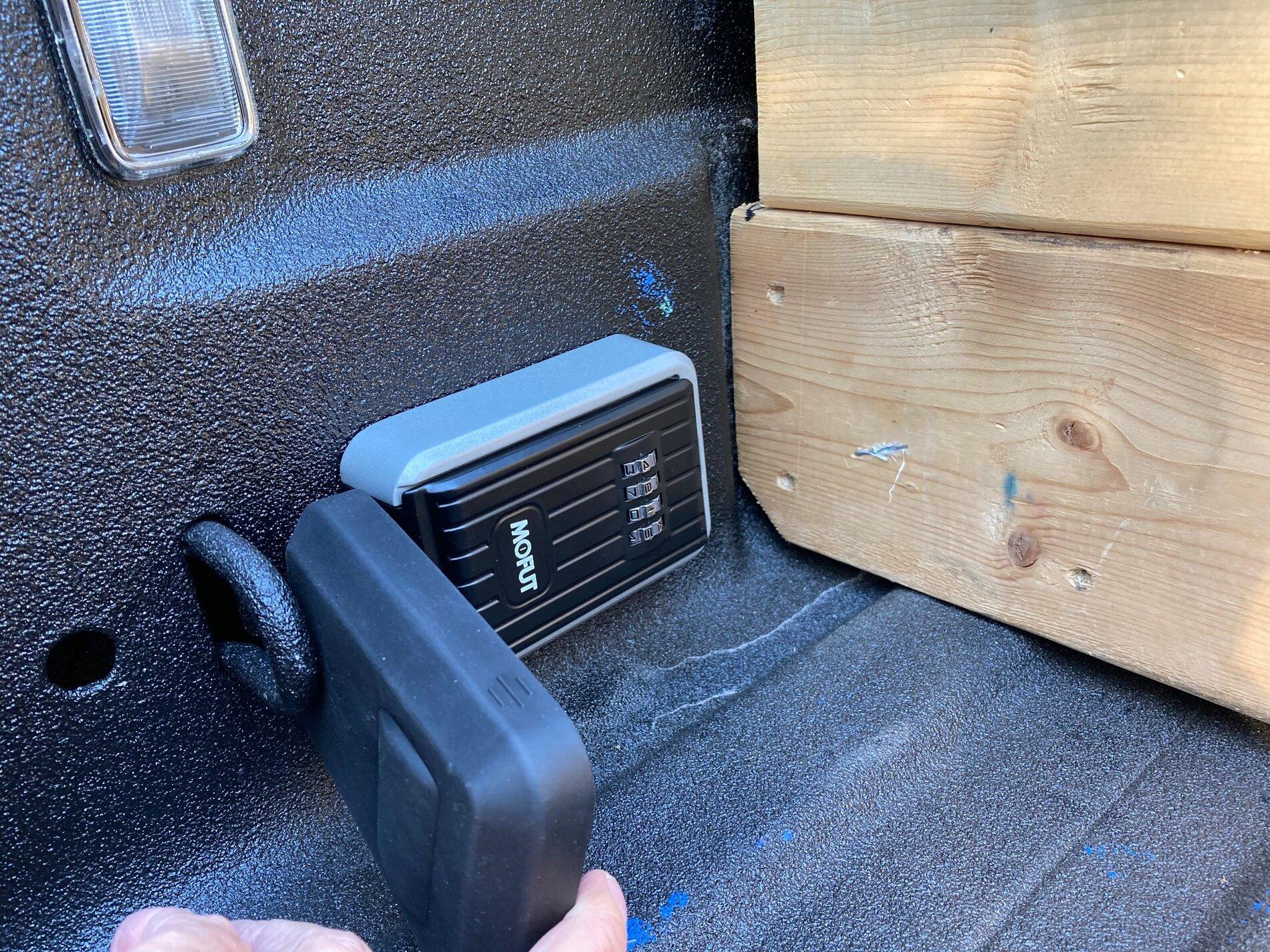

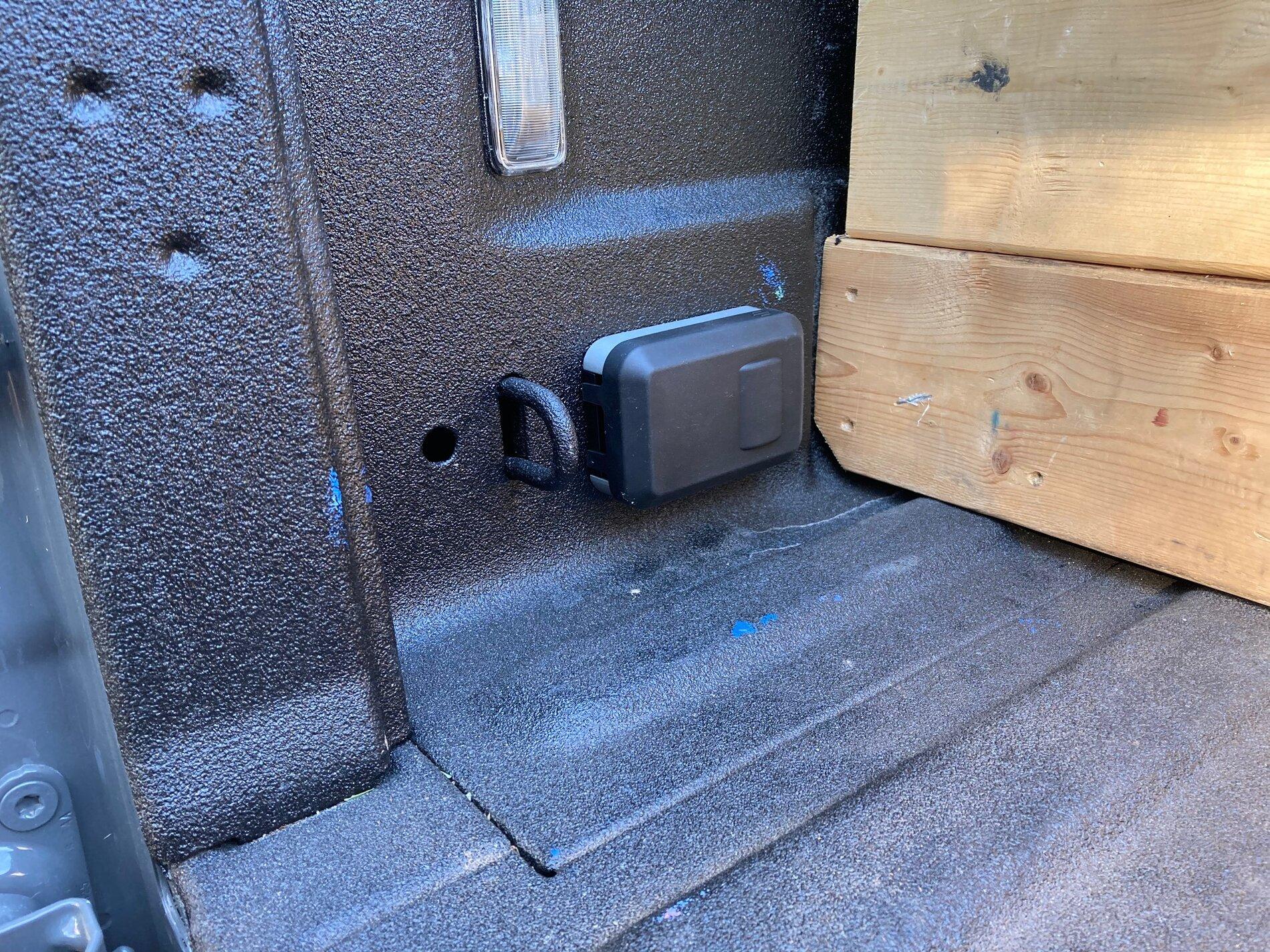

I need to get a magnet and put that under the truck just in case now, I was going to keep it in the center console in case I wanted to lock the inside places but I may need it outside as well.
After locking myself out of the truck on a trip, I had a key cut and added a lock box in the bed. There's no chip in it so all it can do is open the doors but it's nice to have the peace of mind that I can get in the cab any time.
