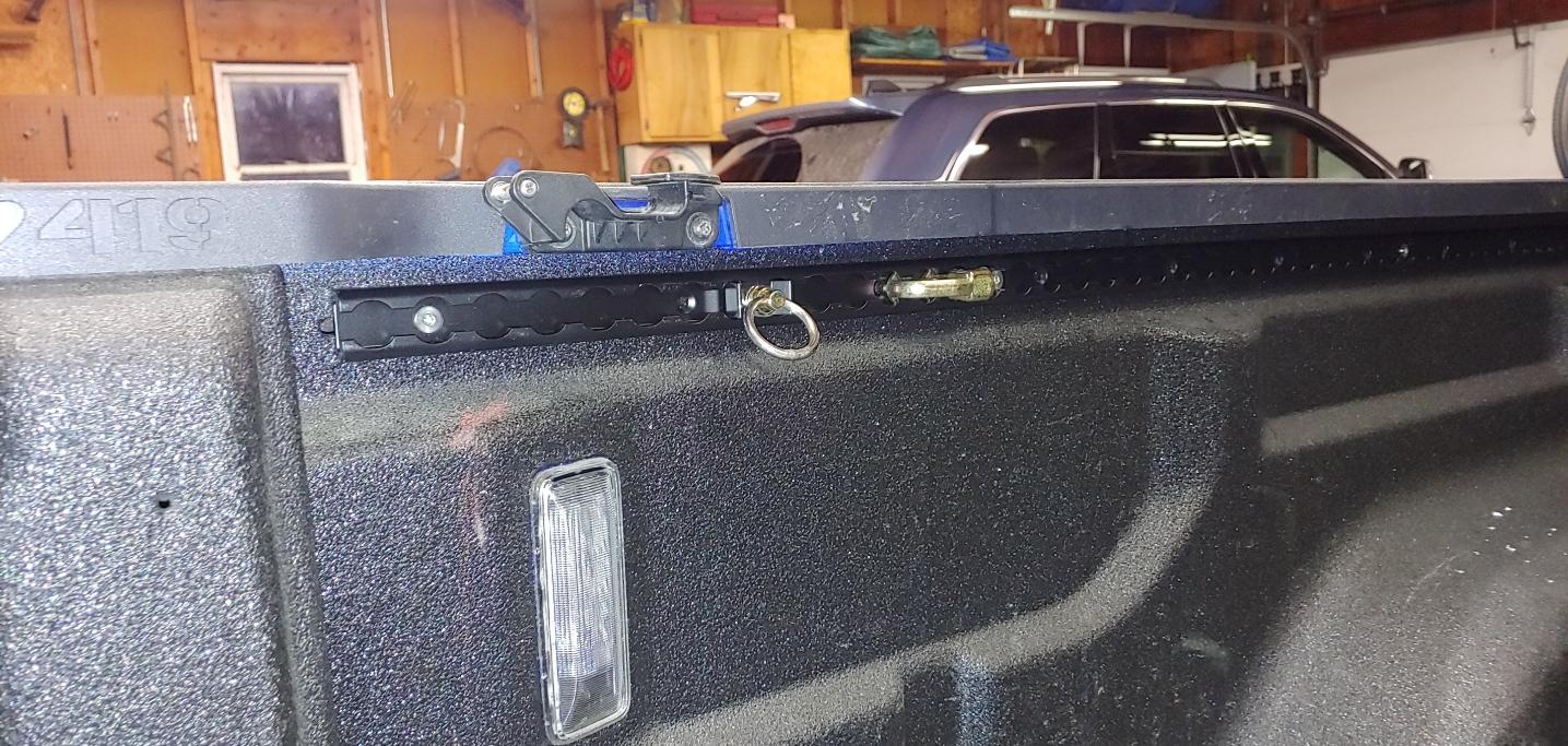

I have no commercial connection with this company, I did previously buy some bare undrilled L-track product from them - and at the time I noticed that they had ready-made L-track systems for other make/model pickups and I suggested (back in January) that they bring out one for the Gladiator - though I have no idea whether or how much of a role my suggestion played in them bringing out this product.
I just got an email from them today that they now have ready-made L-track kits for the Gladiator (I did my DIY L-track install back in February)
I wouldn't call this a huge bargain but I really like the versatility of L-track and, if I hadn't already done my own, I might well go with this just to not have the 'fooling around factor' - and I think I had $200 in mine with the track + various hardware

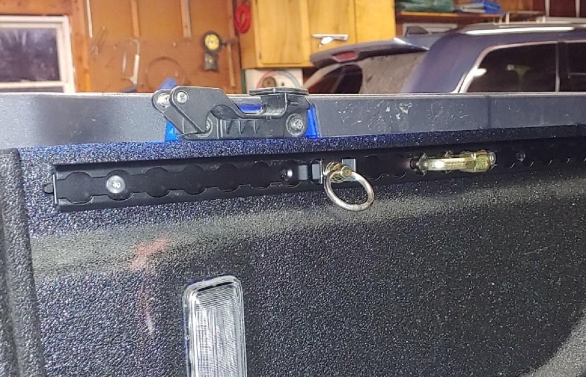

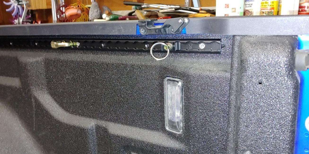

Gee, that looks suspiciously like the track I installed for less money -
I got mine in black. I didn't buy the front rail as I've not really needed something up there - yet, but may add one later.
Looks like theirs is pre-drilled for the truck and includes the screws? I used stainless screws from Amazon. I paid 140 for the two tracks and 8 anchors (4 rings and 4 solid anchors)
I think I could have added a 4' section for the front and kept it under $200.
