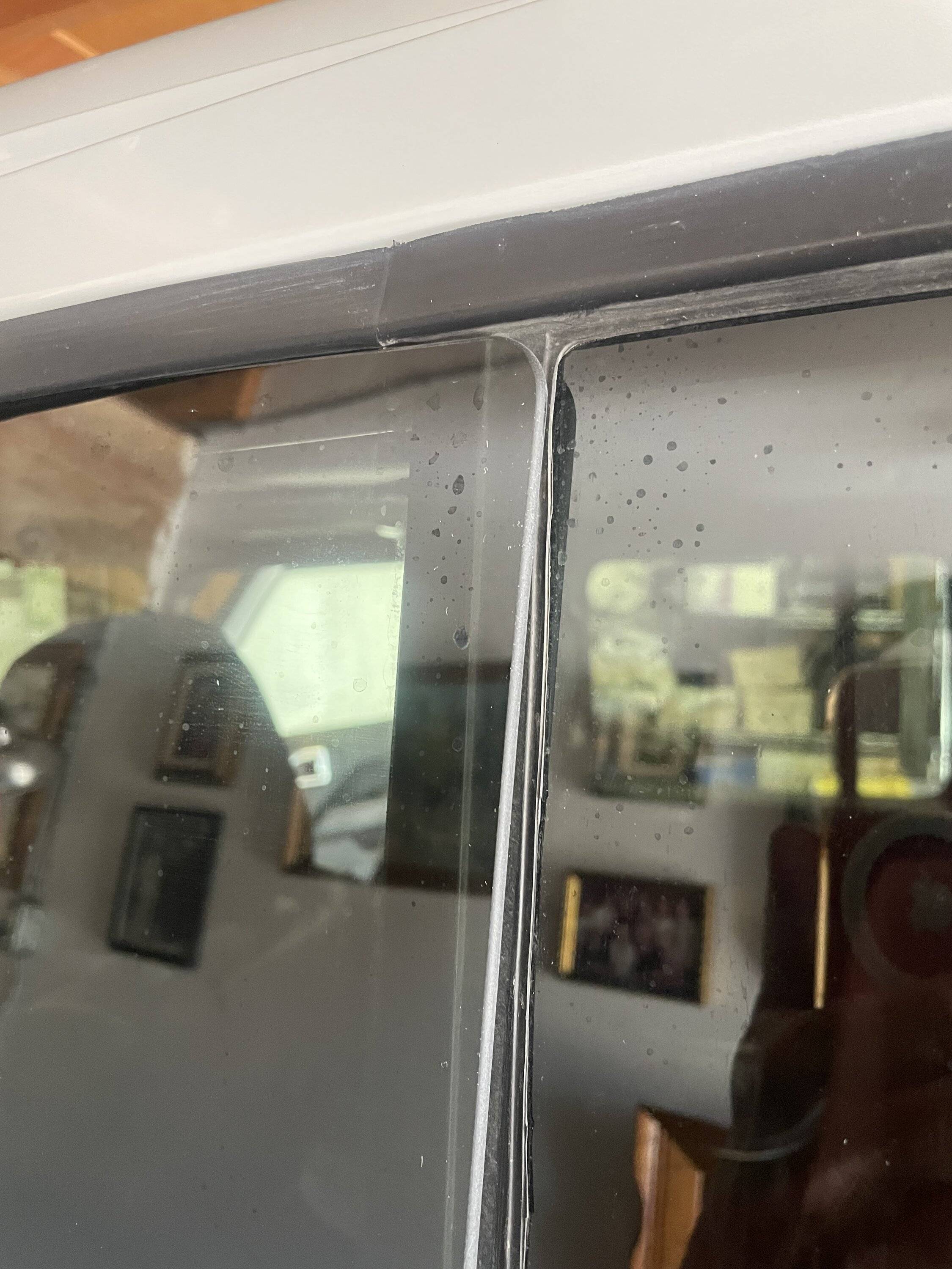

Returned home after a 9 day off road trip of No Calif BDR. Much rough off road 4x4 roads. Lots of jarring even with 16PSI in the 37s. Cleaning I noticed that both rear door window glass had come out of the track on the rear track. Window worked fine with no damage or noise. If this happens to you it's easy to fix with no tools. Remove the outside lower window rubber molding. With window in the down position pull down the upper rubber molding till you can rock the small window forward at the top till you can re insert the window into the track. then put all the molding back in place and test the window. No need to remove any panels. I will always make sure my windows are up all the way on rough dirt roads.

Kind of funny,,,, the service departments acted like they had never seen anything like this happen.
