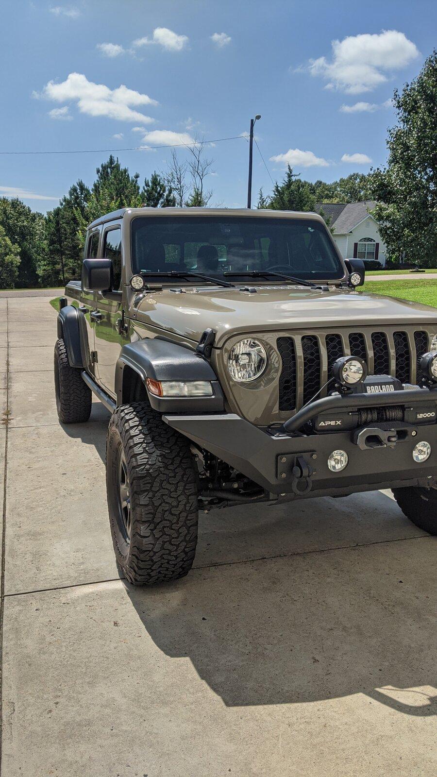

What size are you currently running?
315 70 17 BFG KO2S, 2.5" ReadyLift, Rubicon front springs, and 1.75" wheel spacers.
Jeep Gladiator Recommended A/T Tire for 2020 Overland PXL_20200913_173330619

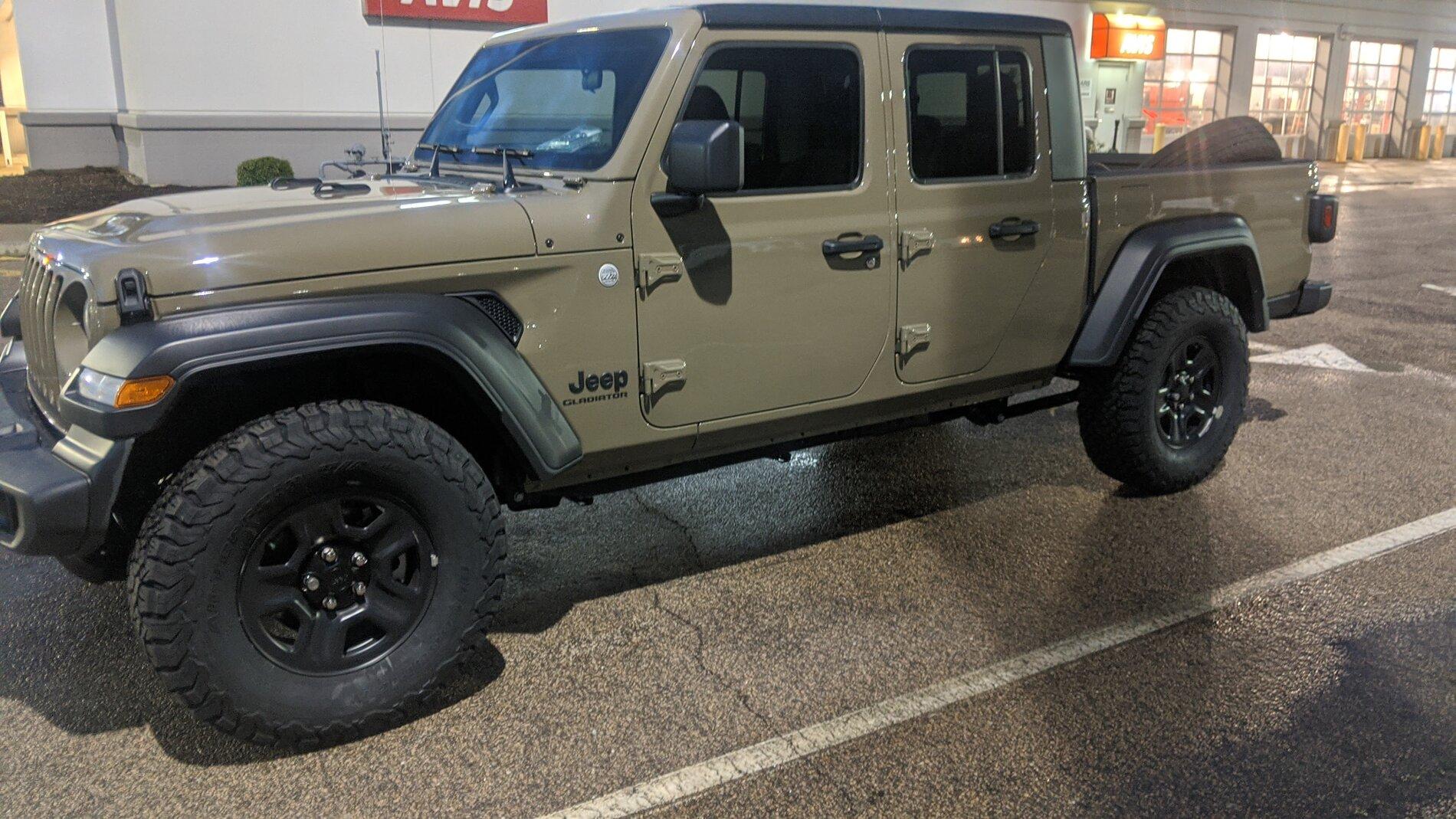

Same tire with the Truck sitting stock. Had it like this for 3 days before I added the lift. If you got a Max Tow and you Trim the air dams at the bottom you will have no rubbing

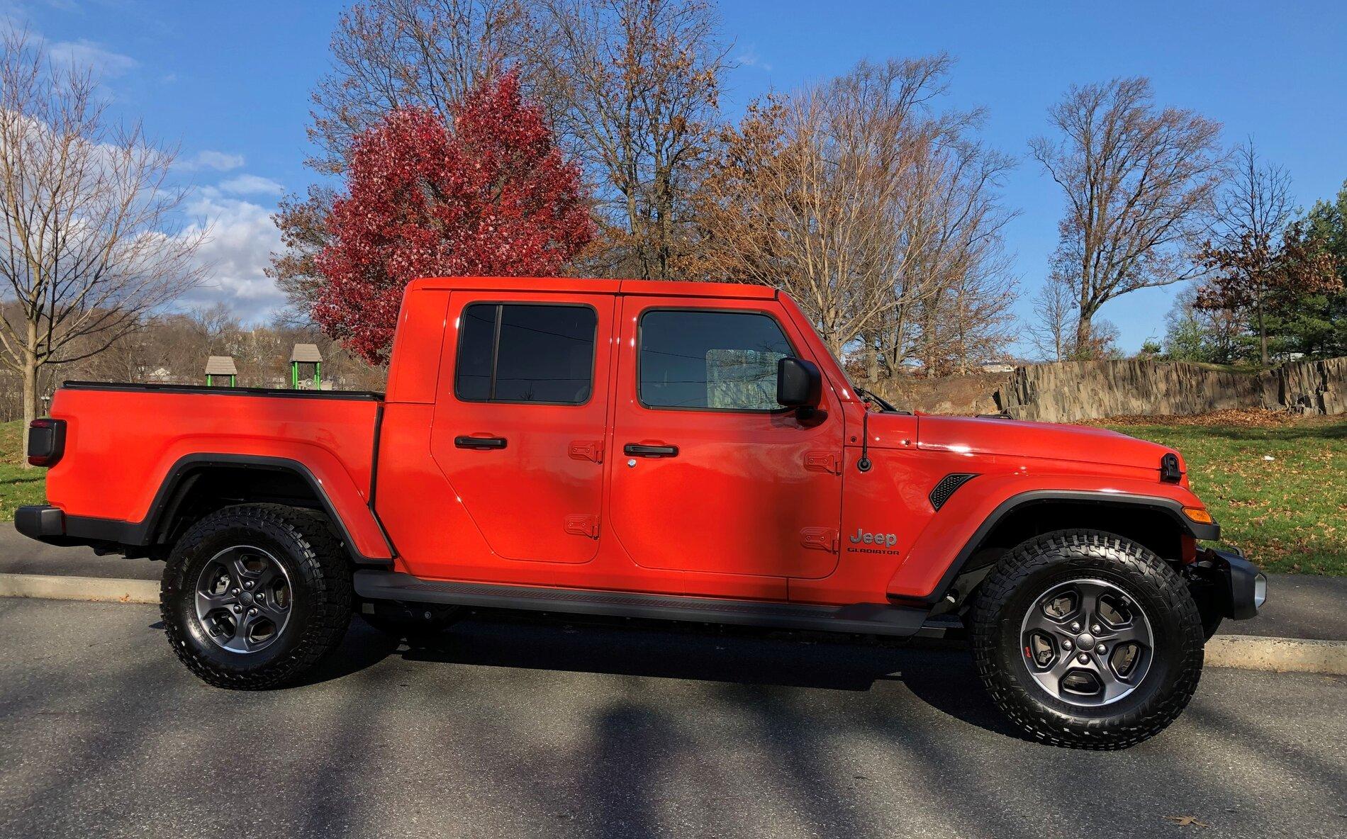

I just did Rubicon Falken ATs take-offs too. Very happy with them.
Jeep Gladiator Recommended A/T Tire for 2020 Overland wheels.JPG

Max tow comes with 4.10 gears, wider axles, beefed up cooling for towing which is 7600lbs and the most you can get on a JT. As far as the Hard top goes, I love it. I ran a soft top on my JKU for 85% of the time after I gave away my hard top. I regretted that and wanted a hard top again on the JT. Mine came with a soft top as well but I'll probably never use it. It's in the box it came in still. The Hard Top is so easy to remove that I don't have a need for the soft top, plus the soft top looks pretty stupid when you open it all the back on the jeep because of how it sits up top.
You will need wheel spacers or wheels with more back spacing to run the tire size I have on a overland. If not your tire will rub the bottom control arm at full lock.

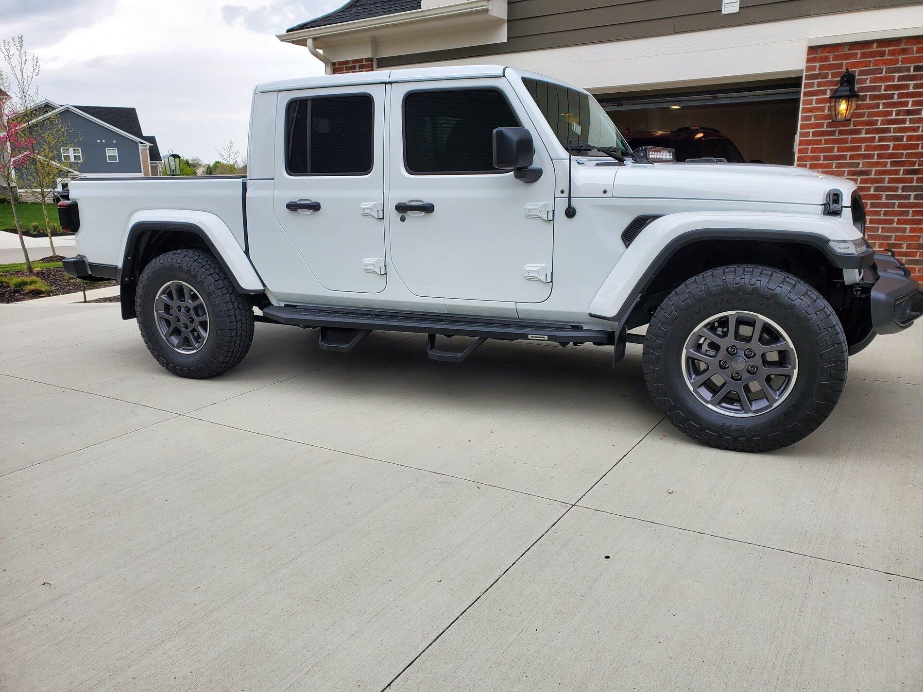

Cooper discoverer, 35 equivalent, fit fine without lift but I did leveling kit on the front for aesthetic only.
Sits perfect! Which leveling kit did you go with?
